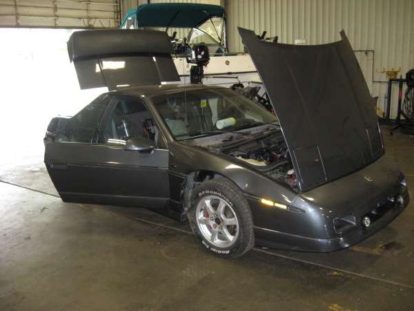

So a little intro. This is my 86 SE Fiero I bought
earlier this year. It has no rust on it (except the
usual..cradle. Fixing it this summer). It did however
house a/multiple families of mice and whatever else so it
has seen it's share of virtually every cleaning agent. I
had a parts car that I took most of the parts from to
restore this one. ALL the interior and the motor from the
donor (127k). Exterior is excellent. Yes it does need a
wash and a wax but I'm more concerned with making it
roadworthy first. Near the end of the day I was finally
able to start it up. Shot out alot of fluff and stuff.
Running in the high teens. around 1800 I figure. Can't
tell for sure because all the gauges aren't working.
Those mice better not be at fault.. *shakes fist* I took
a video but because it's revving so high the mic can't
capture it at all. So far what I have done to it is as
follows. Replaced the washer fluid tank, washer fluid
pump, installed 6000k HID lights, black round fog lights
(yet to be mounted), LED driving lights (Haven't made the
holes in the front clip and mounted them.), relocated the
battery, installed smoked side mount signals, new rotors
and pads, serviced the front bearings, changed the door
hinges, wired the lights into the interior (Haven't
decided/figured out where to mount the switches), rebuilt
the shifter, painted the speaker covers and door handle
covers matte white, wired in a 500k capacitor, 800W amp,
1200W 12" subwoofer, 150W 10" subwoofer, aftermarket
stereo (getting shipped to me from my uncle), new shifter
knob, cold air intake (yet to be installed), new parking
brake, cables and springs and new reverse lights (yet to
be installed, removing the rear fascia reflectors and
installing reverse lights there). The rest of the stuff
that I have done to the car was basically rip out the
rotten stuff and reinstall some good second hand parts.
Redid the vacuum lines on the motor and I think that I
have a couple wrong. It would explain my high idle
because before the swap the motor idled beautifully.
Anyways just thought I would share.

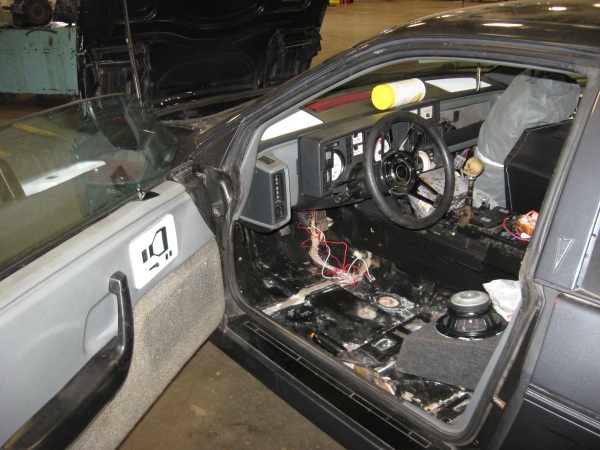

cut wires. I think I've almost got the stereo rewired
right but something isn't right. I've got power when I
turn the key but when I hit the power button..nothing.
I've also got a few extra wires left. A lime green one, a
kind of dark/turquoise blue one, 2 grey ones and a tan
(maybe paled pink?) one. Suggestions? According to my
wiring diagram I should have a working stereo but these
wires are not connected and I still have wires from my
stereo to reconnect to the harness. I noticed that on my
wiring diagram a grey wire goes up to the gauge cluster.
Could that be the reason for my speedo and tach to not
work? Personally I don't think so but it never hurts to
ask. Anyways I think that's all for now. I'll take some
pictures tomorrow once I'm done.

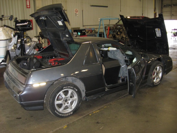

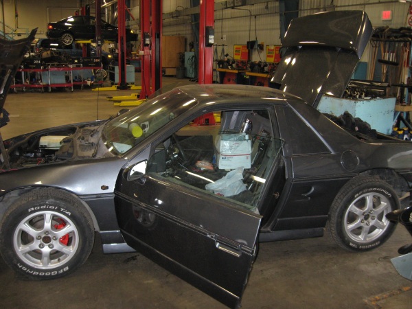

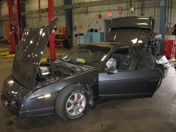

Before
After
Enjoy guys/gals!
~Cody_O~
