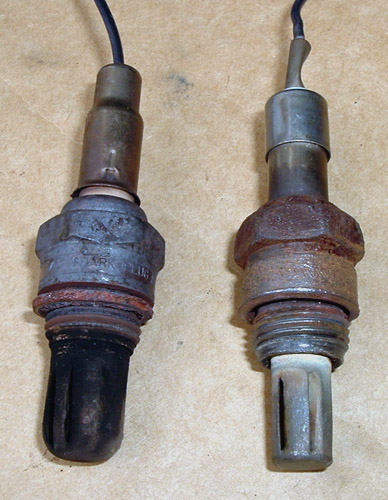

I'm not an expert by any stretch of the imagination, but a damaged or dirty O2 sensor will also cause the engine to put in more gas than it needs. Cherry on top is that they're cheap to replace.

Genuine Delco O2 Sensor

tomorow i'm going to replace the o2 sensor, Intake Air Temp sender (was very rusted looking when i checked it) and recheck the gap on the plugs, I cant remember what we gaped them at but I thought it was a bit more than .050. and then run it though air care on monday.

today I installed the new IAT sensor, but did not replace the O2 sensor as it looks "as new". though I did note that it is larger than the factory ones, could it be a wide band o2 sensor?

...did not replace the O2 sensor as it looks "as new". though I did note that it is larger than the factory ones, could it be a wide band o2 sensor?
That’s doubtful as the wide band sensors are pretty expensive and not commonly used. If it just has one wire connected to it, I believe it's a narrow band O2 sensor (but I'm not absolutely sure on this).
This is what the Delco unit I recently installed looks like...
It looks considerably larger than other O2 sensors (which may or may not be Delco units) pictured below from other Fieros of mine.
I hope it’s an AC Delco O2 sensor you have, as I’ve read plenty of comments at PFF about how terrible the Bosch units work on the 2.8 in our Fieros.

the first 02 sensor picture you posted is the one thats in the car currently, the second style is the ones I'm used to seeing in these cars,
