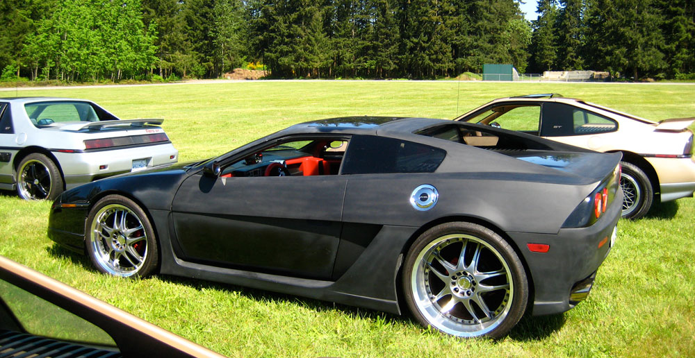

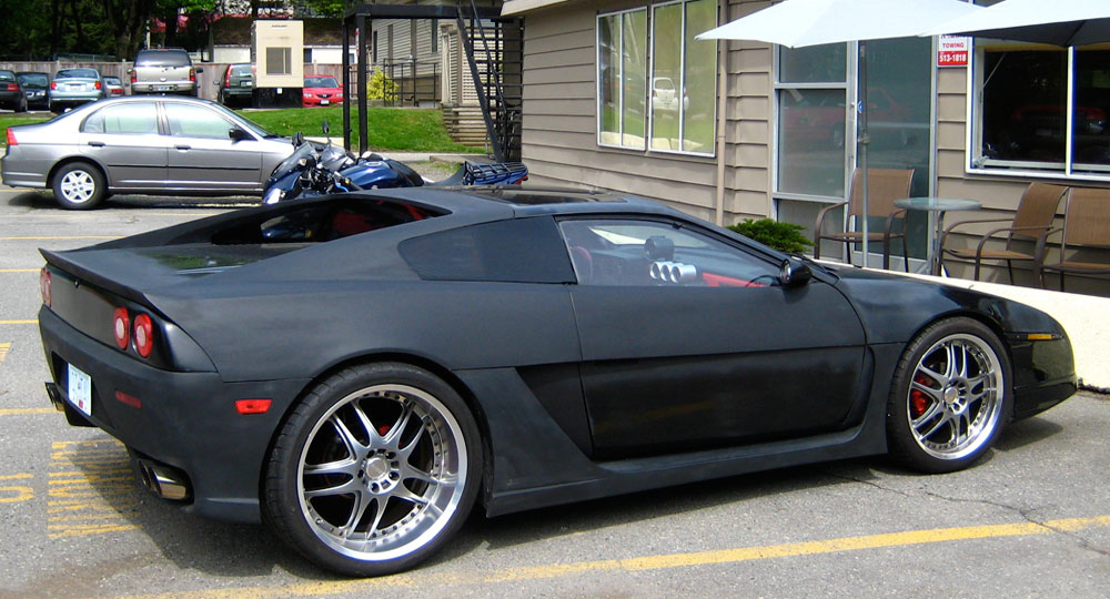

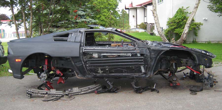

BEFORE...

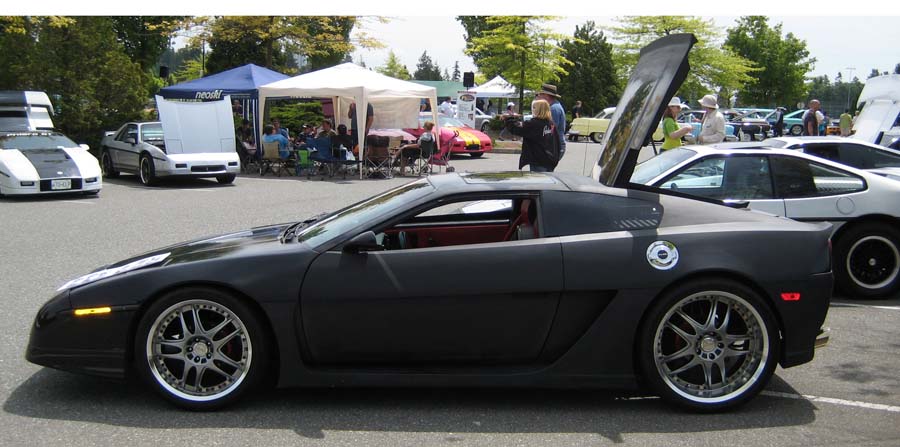

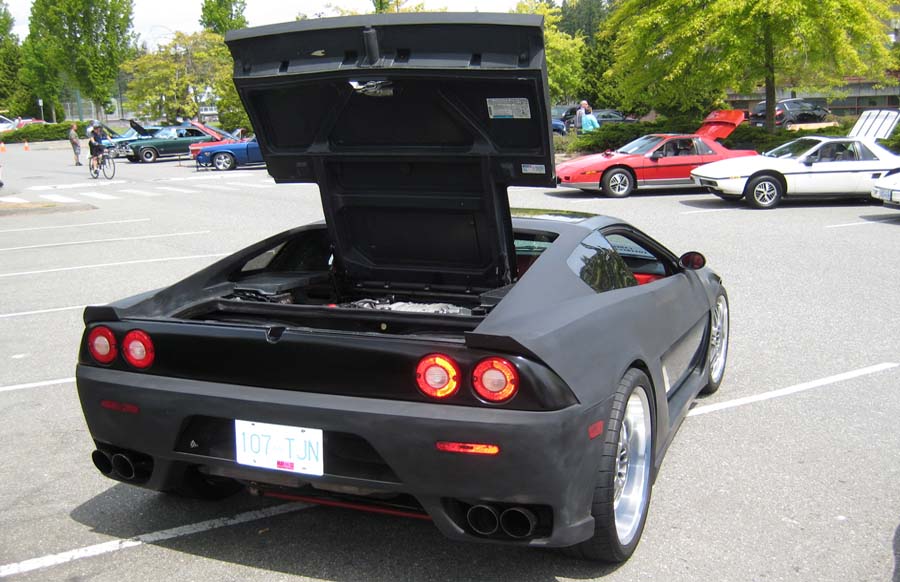

AFTER...wide body
AFTER...chop top
AFTER...new rear bumper and wingless
Raised 3/4" to 1-3/4" window line and blended to rear hip, quarter
windows modified and rear taillight panel

Love those rear lights. Ill probably be doing that with mine somtime.

May i ask where did you buy those lenses? i need some for my 86gt
Lets get it sideways
Date Posted: 21 February 2007 at 10:39am
The 355 style taillights...
mine is an older two piece panel from Pisafierohq.com I like the new one piece panel from Kahines.com
also Doug from Fierowarehouse.com has one piece panel(not shown on website), email him for info.

What type of exhaust tips are those?
'86 Fiero GT Blacked Out!
Date Posted: 05 March 2007 at 4:47pm
The exhaust tips are VIBRANT single wall?angle cut 3-1/2"out 2-1/2in

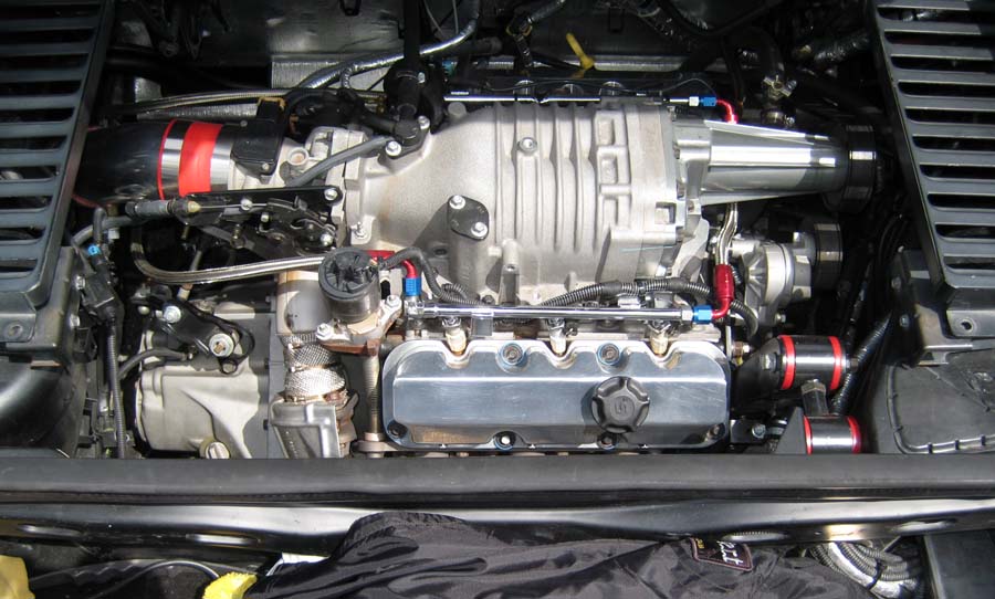

Date Posted: 05 March 2007 at 7:03pm
Blair's installation of the 3800SC

Date Posted: 30 June 2011 at 3:00pm
John what does your suspension front and back consist of ?
The stance is perfect.
Date Posted: 30 June 2011 at 8:59pm
Not for me, RBS is going to be dropped 1" all around, also fenders trimmed for more travel.
What RBS has now...
Rear: WCF coil over kit 300lb 8" springs with KYBs, (with the 3800SC it bottoms out), will be going with 400lb 7" springs.
Front: 1-1/2" lower springs (not cut) with KYBs, I'll keep that as is for now.
STAY TUNED...
Next week I'll be doing the suspension (on a Budget) step by step with detailed pics of what not to do

Date Posted: 25 May 2012 at 5:30pm
Good by old RBS...
Stay tuned for the a new RBS-2 coming soon to a meeting near you
Date Posted: 05 June 2012 at 2:27pm
Guess who...
Yep, it's RBS-2 coming soon

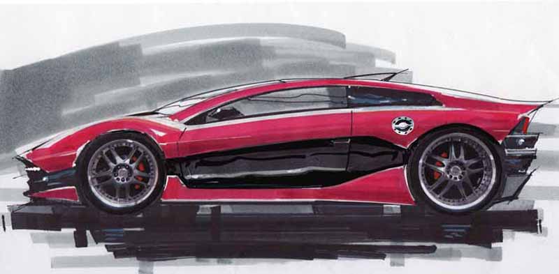

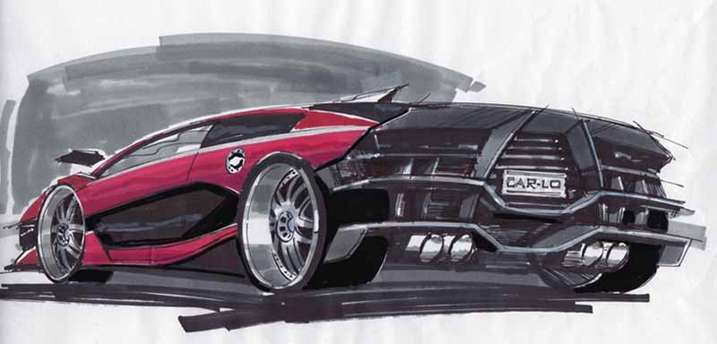

Date Posted: 20 June 2012 at 8:50am

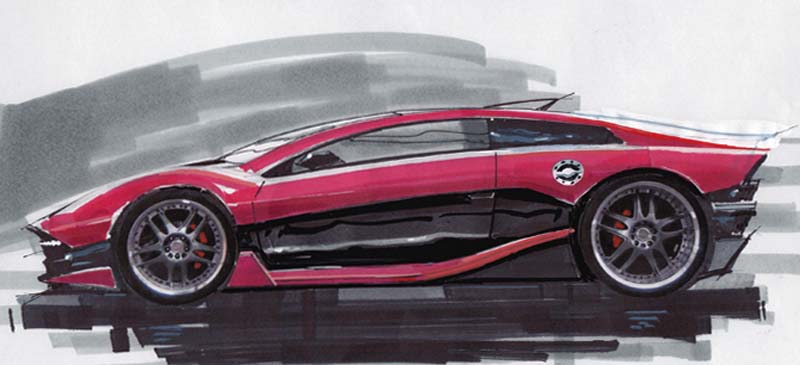

The RBS-2 future ride...

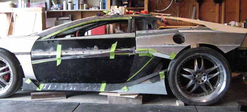

A little tweaking on rocker panels, the rear was looking way to boxy and heavy so Clynt and I angled panel
with a curl at end in black not to look that bulky

RBS2 is slowly shaping up...
