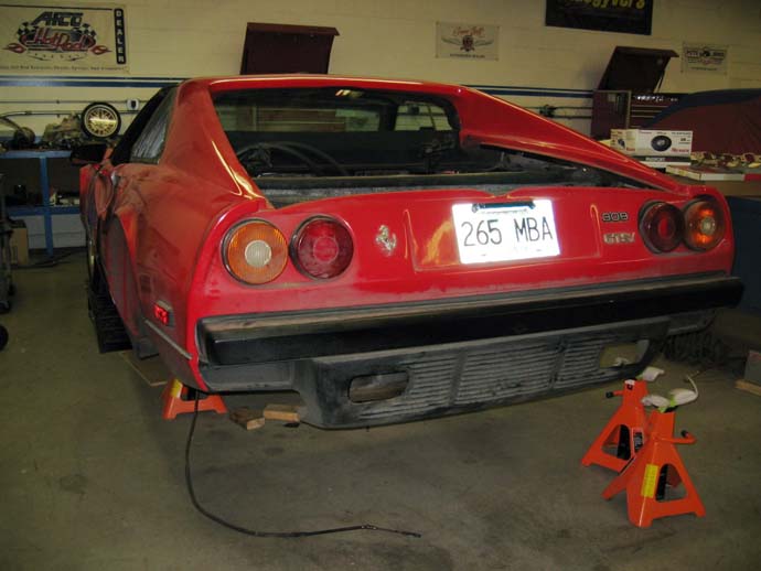

Here are the before photos

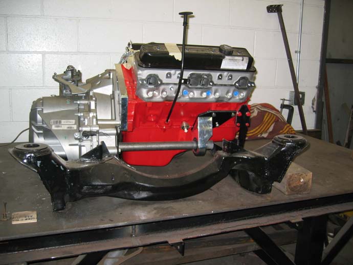

The first order of business was to upgrade the mechanicals.  After discussing things with Chris Zander who is now working at B&N hotrods http://bnhotrod.homestead.com/ - http://bnhotrod.homestead.com/  We decided to do the following
Engine and Transmission
GM zz383 crate motor   http://www.gmhorsepower.com/ZZ_383.html - http://www.gmhorsepower.com/ZZ_383.html
6 speed transmission kit w/tranny

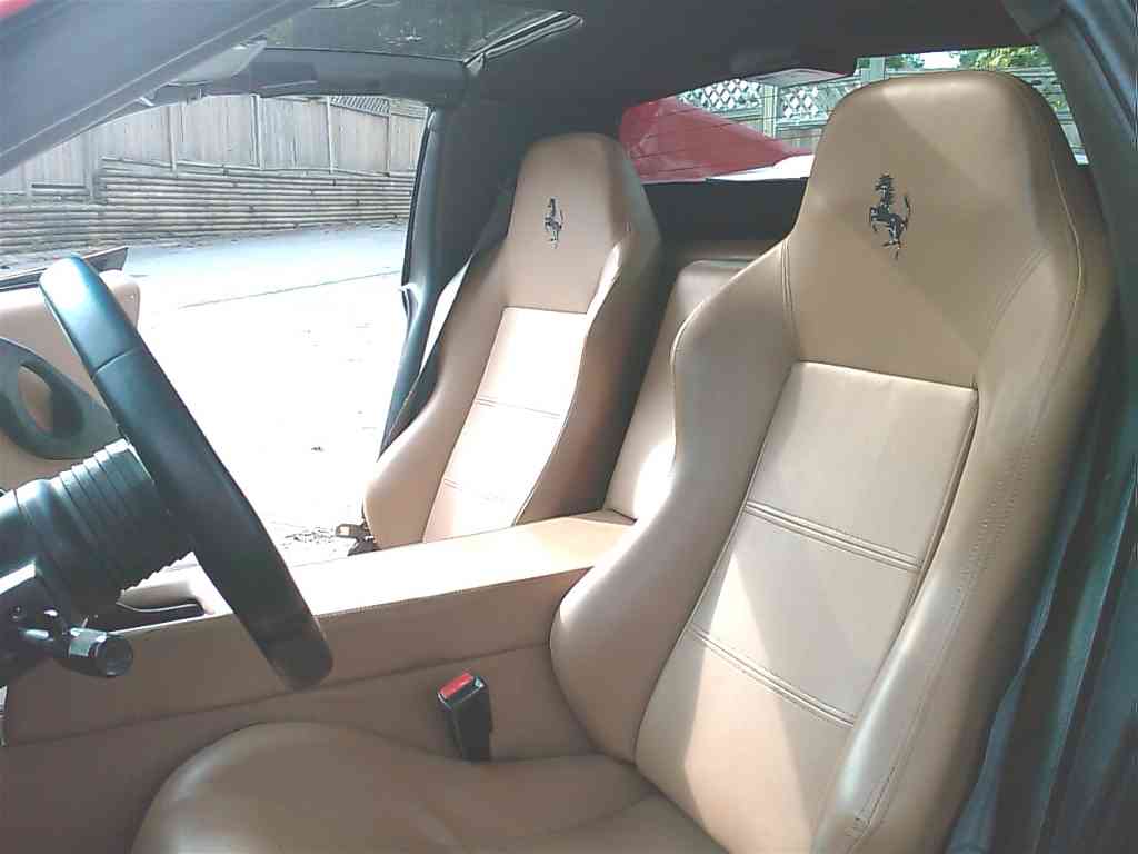

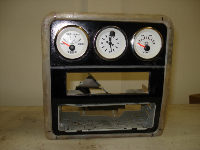

Date Posted: 05 January 2008 at 4:44pm

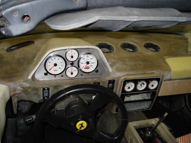

Here is the interior before Chris got at it.....
That interior has now been removed and replaced with the fiberglass PISA kit.
Passenger door. Door panels in tan vinyl door arm rests in black vinyl.
Dash passenger side in black vinyl
Center console tan vinyl
Drivers side dash also in black vinyl

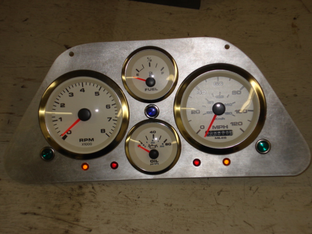

The gauges are white face with red back light Teleflex Premier white http://www.haneline.com/ - http://www.haneline.com/
The seats will also be reupholstered in tan
and so the journey continues..............

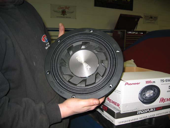

Center console with Blaupunkt Memphis head unit in place
Glove compartment has connectors from head unit to USB and iPOD docks as well as a spare cigarette lighter.
Amp rack housing a Focal 5 channel amp and 1.2 ferrat cap

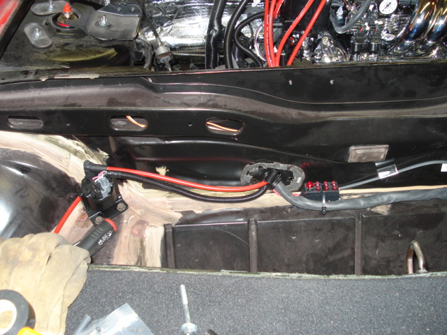

Battery charging posts to make for easy jump starts etc...  you can also can see the back side of the battery disconnect switch in this picture

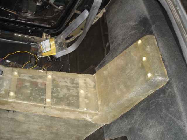

New cubby in trunk to house jack, jumping cables, tire wrench and tools
Picture of the cubby with the lid in place
Picture of rear Focal Utopia Beryllium speakers

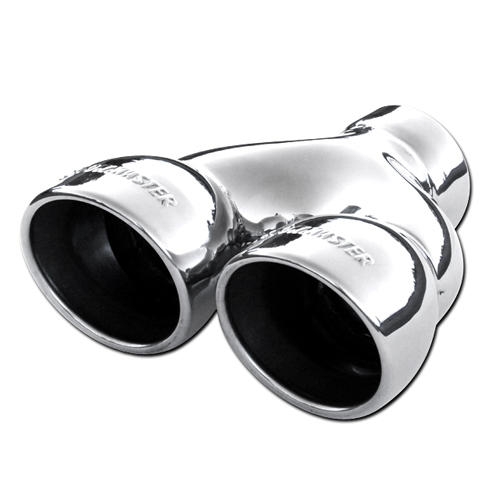

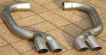

Hi Hugh, if you're still looking for short tips, the Corvette C6 tips are only 7.50" long and look great.
From... www.flowmastermufflers.com
Posted By: Fiero308
Date Posted: 27 January 2008 at 8:33pm
I have already ordered some from Rodney Dickman http://www.rodneydickman.com/retail_new.html - http://www.rodneydickman.com/retail_new.html
but thanks for the info

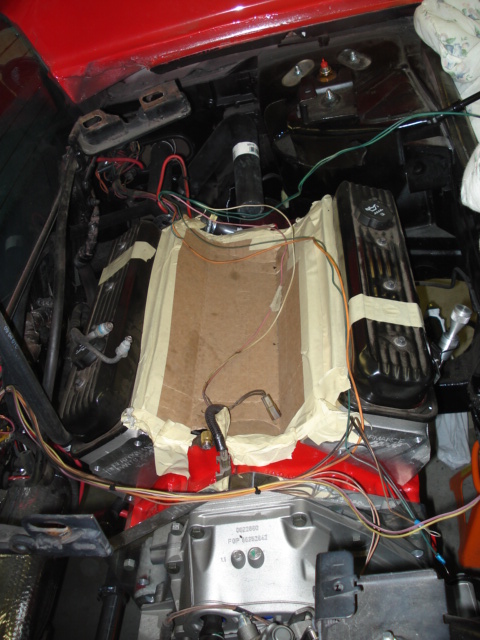

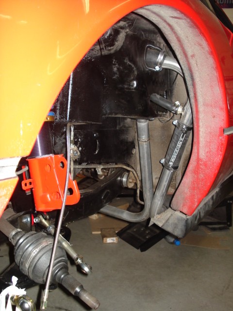

Date Posted: 09 February 2008 at 1:35pm

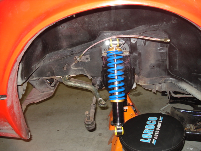

Here we go............ the build progresses....

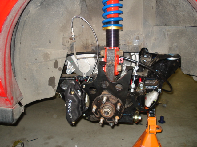

The engine is in now we are waiting for the manifold and valve covers.  I don't mind if you show them Chris

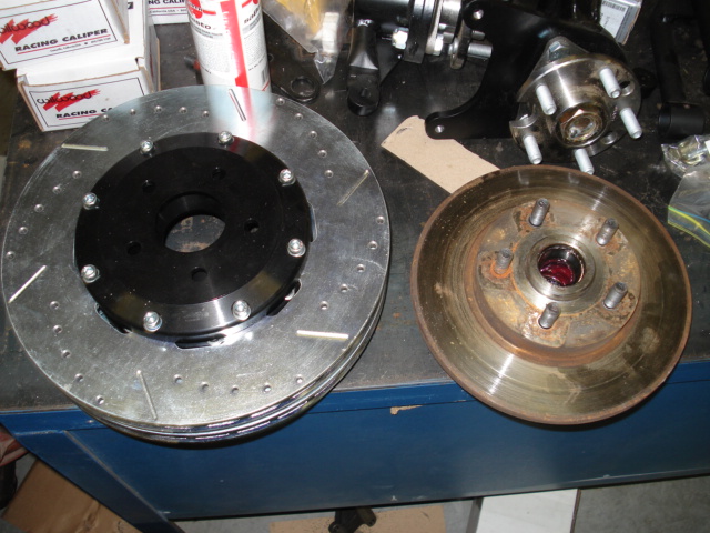

Coil over shocks mounted note stainless steel brake line and anti roll bar
Willwood 13" brake rotor with stock one for comparison
Brakes and suspension mounted
New gauges mounted
gauges close up
center console gauges

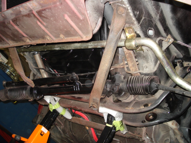

coolant tubes relocated into the fender well area
front 1 1/4" sway bar
rear 1" sway bar

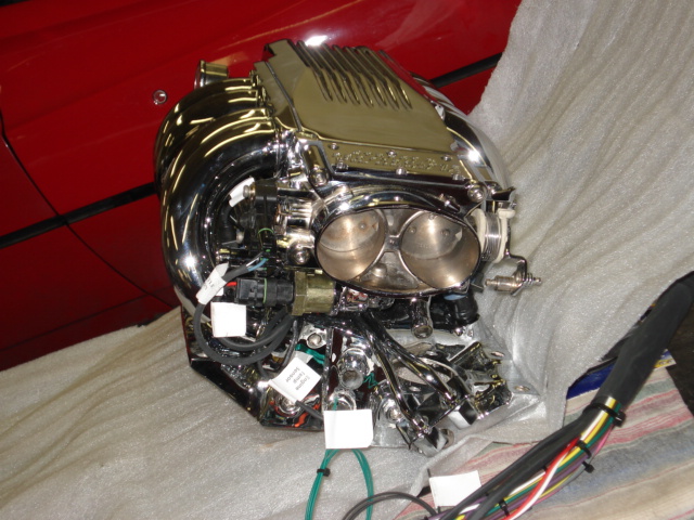

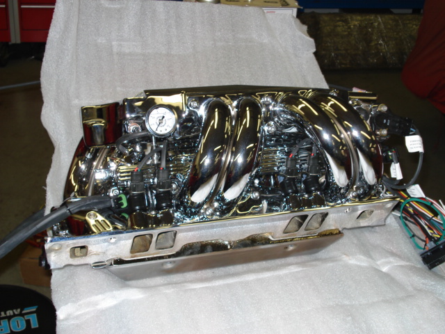

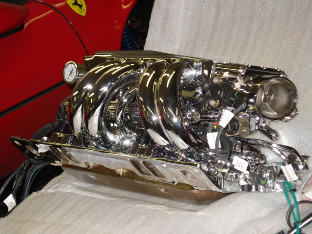

Date Posted: 14 February 2008 at 7:41pm
I just got the images tonight I'll add the captions later.  Mmmmmmmmmmmmmm I like shiny!!!
Front suspension and brakes
Air intake and injectors all chromed up.....

Posted By: Fire451
Date Posted: 19 February 2008 at 9:30pm

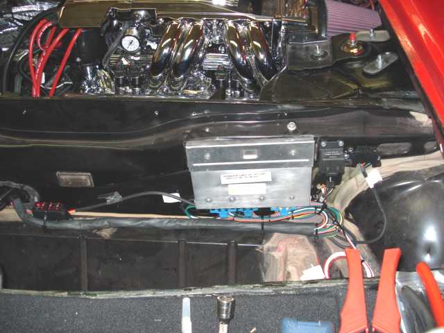

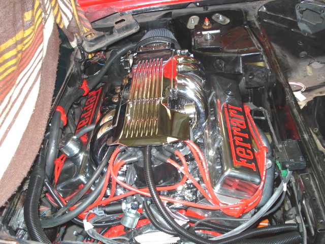

well the engine bay is pretty much done, engine is wired, fuel system is finished, cooling system is finished, going for exhaust next week and then I will let the beast come to life....
I think I will wear ear plugs and duct tape over my mouth to contain the smile....  lol
Hugh should be posting pics of the completed engine bay soon... if you have a big monitor the wear sunglasses  .lol

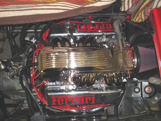

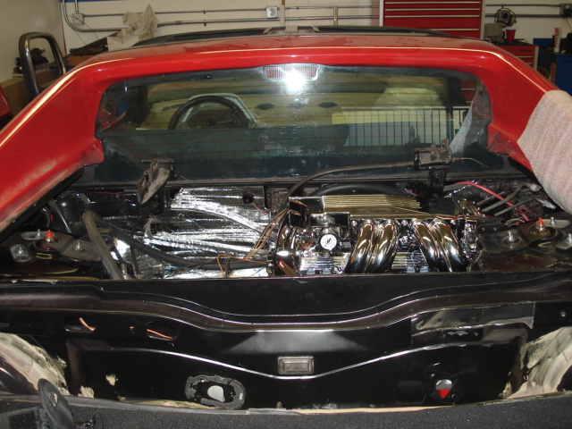

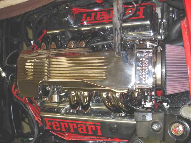

Here we go the beast is assembled and shiny.
Top view
side view I love teh matching red wiring
Posted By: Fiero308
Date Posted: 20 February 2008 at 10:01am
I cannot wait to see this in real life.  The engine looks like a modern art sculpture!!

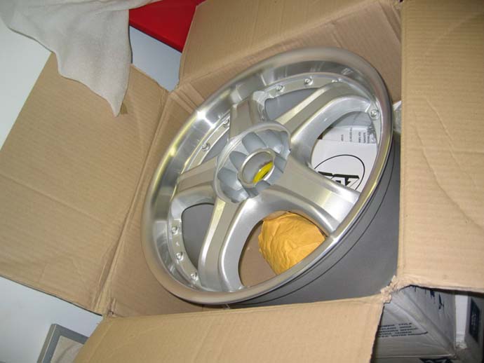

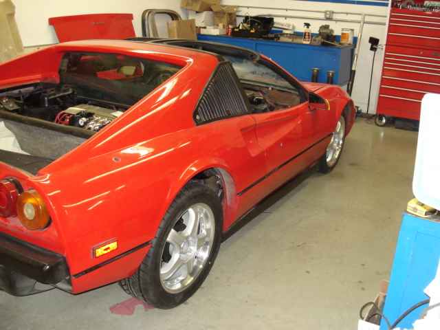

Date Posted: 25 February 2008 at 8:15pm
OK captions to follow later.  Chris help me out here I can't tell what some of this stuff is.

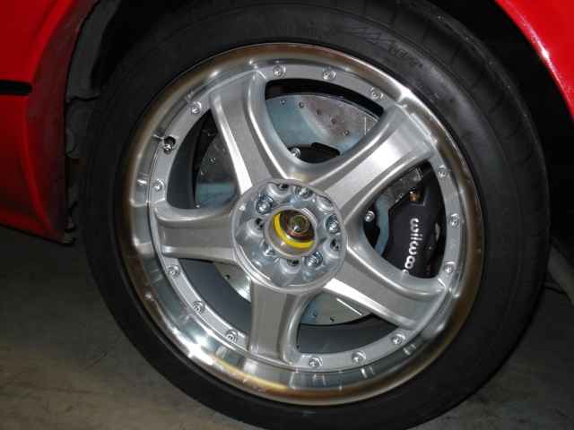

Wheels and tires are on
New rims
Fiberglass center console all smooth and ready for upholstering
Center instrument cluster smoothed out
Dash panel ready for upholstery

Posted By: Fiero308
Date Posted: 02 March 2008 at 1:03pm
I went to see the car on Friday.  It is at the muffler shop.  I was hoping they would be ready to fire it up but  they want to wait until all of the guages are hooked up.  Excuse my ignorance but what are 14" M/T's?

Here we go a new update on the build.  An attempt was made to start the car but a vacuum problem was noted with the intake manifold.  It is being sent back to the suppliers (probably a 2 week turnaround.  The interior is coming along nicely.
Upholstered dash and guages installed
View from the drivers side
Passenger side view.  Note the location of the subwoofer.
View rear of passenger compartment.  Seats are being upholstered as we speak.  As a great man once said "I think the end is near!!"

car fired right up, sounds REALLY nice, have video but it kinda sucks so i will be posting video after we get the intake all sealed up and it purring like a LION

Well the "Beast" is finally on the road.  I still need to tune the suspension to my liking (any sugestions on anyone who could do this for me would be greatly appreciated!!) but otherwise it is awesome
PS If anyone knows anyone who does custom door seals let me know.  I have a leak up by the t-top

very sexy car!   Quick question about your air intake though, isn't it going to suck in hot air with it on the right side of the engine bay?
Date Posted: 11 October 2008 at 9:52pm
Hopefully I did not get it too greasy. I got the pleasure of driving Hugh's car today, and Huge it was defiantly a pleasure to take it for a spin. Makes me want my V8 back on the road.
    I don't know what the technical name for the shock is, but Hugh needs a shock that will compress much easier than what he has now however will not de-compress really quickly. His suspension is VERY Firm however on hard launches the front end climbs over 2". Its kinda neat to see it haunch down, and look like its going to yard up the front wheels, but no exactly what Hugh is looking for.
His suspension is VERY custom, so he is going to need a tuner shop to do any work for him. I would think some of the auto cross guys would have a recommendation for him. Brian would you mind asking on your Auto cross forums and report back here. Please.
Posted By: marcelvdgn
Date Posted: 12 October 2008 at 4:24pm
variable valve damping shocks
typically two valves one on  each end of shock to adjust both directional damping
we used them on the sprint car with dual torsion bars on each axle
total infinate adjustment avail with that kind of setup
