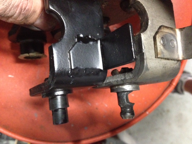

Nice hey...original with Dickman adjustable banjo to new Fiero Store clutch pedal...nice wear mark hey:)
Date Posted: 29 June 2013 at 10:16pm
It may not look like much - but that notch I'm guesstimating was killing 30% of the clutch travel!
That coupled with a quick bleeding made it a different car to drive.

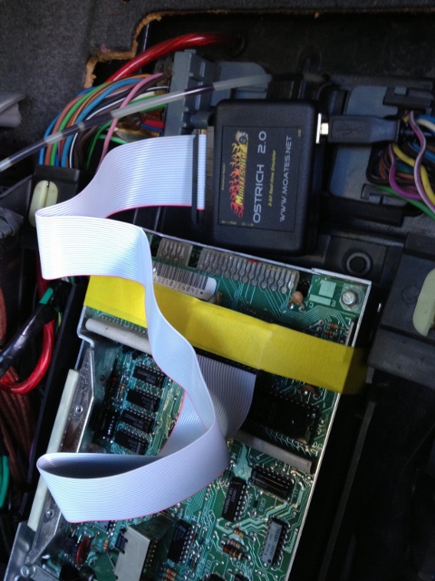

Installed a Ostrich 2.0 today, and the exhaust hanger with John's more powerful impact gun...my piece of crap!...lol
Date Posted: 04 July 2013 at 10:18pm
http://www.moates.net/gm-19851995-c-64.html - http://www.moates.net/gm-19851995-c-64.html
