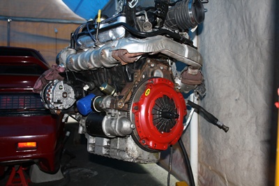

Started to pull the motor.I have a new 88 flywheel ,bolt and yesterday the new clutch came a stage 2 clutch that can handle 294 hp and 295ft/lb torque.I,m going to send the pcm to sinister performance to do the programing as sone as i get the pcm out i'm going to stay with the obd 2.

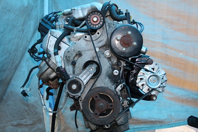

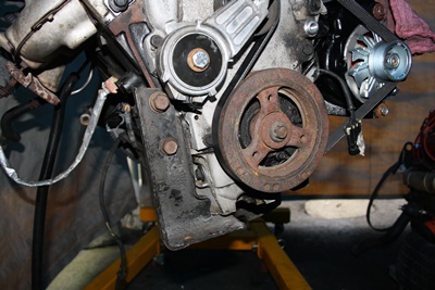

Got the motor out and pulled off the ac pump and power steering pump know need to give the motor it bath.

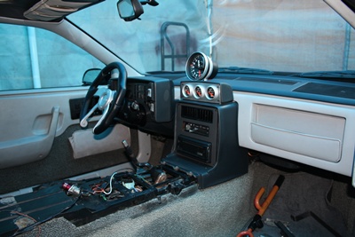

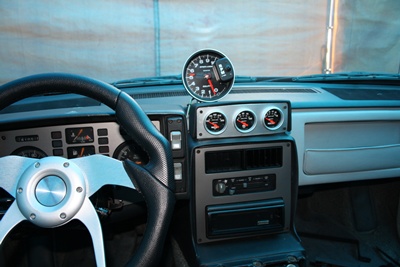

Went to monreo swap meet and bot some gauges monster tach for $50 and a fuel pressure gauge for $20 which was bran new.

Gave the 3400 a bath nice and clean.Need to get the fuel lines move and see if i can swap the valve covers around.Sinister performance shipped out the PCM yesterday.

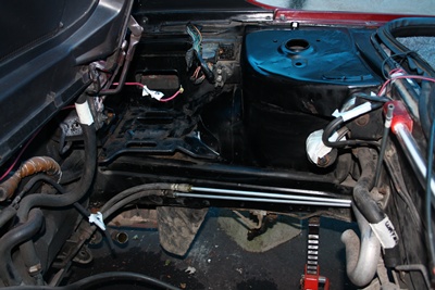

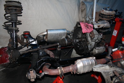

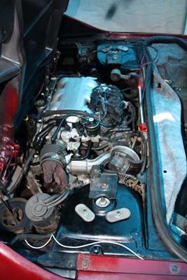

Started to pull the 2.8 out of the fiero it will go up for sale once it out.

Date Posted: 01 July 2012 at 8:54pm

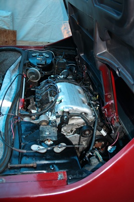

The other side of the 2.8

Got the motor out of the fiero today,that was fun,

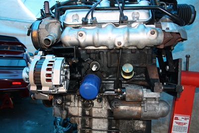

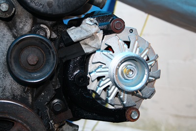

2.8 is ready to come of the cradle.Got the dog bone in place on the 3400 but still try to get the alternator relocated to the lower part of the motor going to have to make a braket for the alt.Might go out to pick a part to find some kind of braket that will work.Still have to pit the fly wheel on and clutch.

Went to pick a part found a bracket that will work for my alternator hade to do some cutting and grinding to make it work,but almost done will put some pics up when done and painted.The bracket came of a 94 grand prix 3.1 and it was a AC bracket.Today going to find some fuel lines and hope to get them started.Also got new poly bushings for the cradle need to install them also.

Got the alternator and braket install, also got th e fuel lines in

The brack came off a 94 grand prix 3.1 with some cutting and grinding it fit.The alternator is from a 88 fiero,just need to put a small washer behind the pull to push it forwards to line up with the rest, it's a little back from the rest.Then put the belt on.

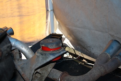

Date Posted: 11 July 2012 at 4:15pm

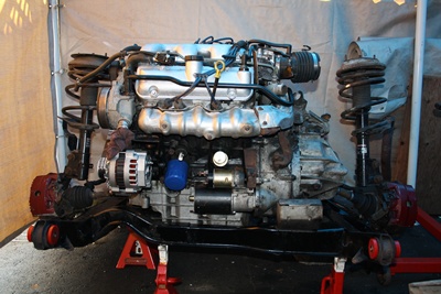

Started doing the poly bushings on the cradle.Once they are done the 2.8 is coming off the cradle and the 3400 is going on the fly wheel is on the 3400 just the clutch needs to be done.

Put the clutch on and snaped a bolt.Thanks to David he had a spare 1, know i can try to finish the clutch,hope don't brake any more.

Cleaned the cradle and gave it some black paint.Still need to do the front cradle poly bushing.did new motor and trans mounts.The motor mount was in ok shape 1 of the trans mounts was broke and he other barly together.

Tryed to bolt on the clutch but broke another bolt,it broke around 5 foot pounds.The bolts are not threaded to the heads and when i torque them down they bottom out where the threads stops and snape,so i'm going to have to find bolts that have full thread or put 2 lock washers then try to toque them down.

Got the clutch done yaho.Bolted the motor and trans together,know need to do the exhaust.Need to also make a bracket for the clutch cables and move them over a little.

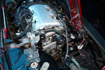

Got the 3400 in the car today.Got all the bolts for the cradle in but 1 front passanger not lineing up right,will have to play with that 1 a little.

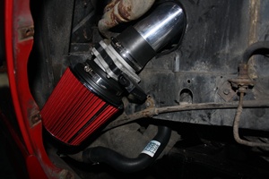

Got all the water hoses done and play on the cold air intake,some thing like this maybe.

Got all my autometer gauges in and working exept i need to find out which wire is for the the tach from the ECM.

Took the fiero out for its first drive around the block a few times,the 3400 sure has more get up and go to the 2.8,the cold air intake sounds great almost like a 4 bbl carb.Have a few things to take care of before go for a good run.Need to do small ajustments on the clutch cable brackets and a pulley needs to be mounted a little better so its not as noisy and it should be good to go.
