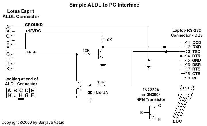

Posted By: CFoss
Date Posted: 20 September 2011 at 2:11pm
I sent the club a winaldl cable which should work for your application, only it has a 10k resistor so it will enter aldl mode when you connect it.
Choose 16144288 for the ecm...i know it's not right, you probably have a '7747, but it will work for checking the sensors.
If you want to build your own cable, the one or 2 transistor method will work (I've only used the 2 T cable, so I'd suggest building it):
Ignore the lotus end, just find +12, gnd from anywhere (Cig lighter for temp, I wired mine in solid on my boat which uses a '161 1992 TBI), then find the data out and connect it.
Chay
Date Posted: 20 September 2011 at 2:39pm
I know my scan-tool uses "Printer" connectors (About the best way I can describe them. They're the same size and pin-count as old-school dot matrix printer connectors were) to go from the tool itself to the adaptor. I wonder if I downloaded WinALDL and found a "Printer-to-USB" adapter if I'd even have to build the cord...

I am pretty sure i have the transistors and such if you want to build
the cable..
