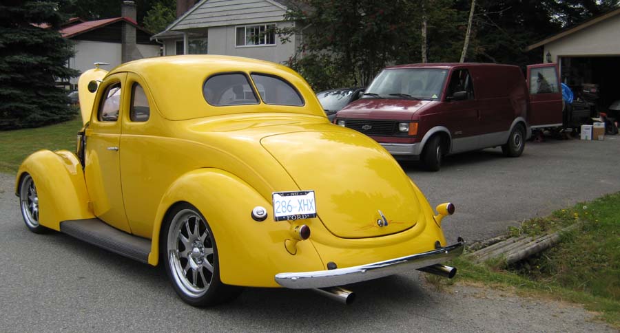

RBS last ride... http://www.youtube.com/watch?v=VhgDgIHSFyk - HERE

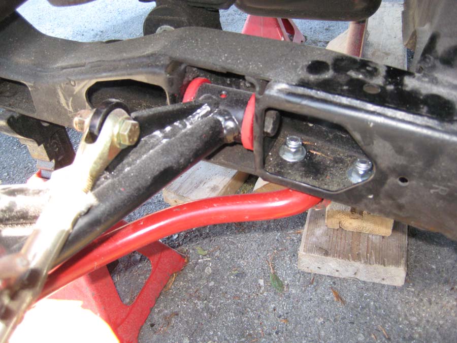

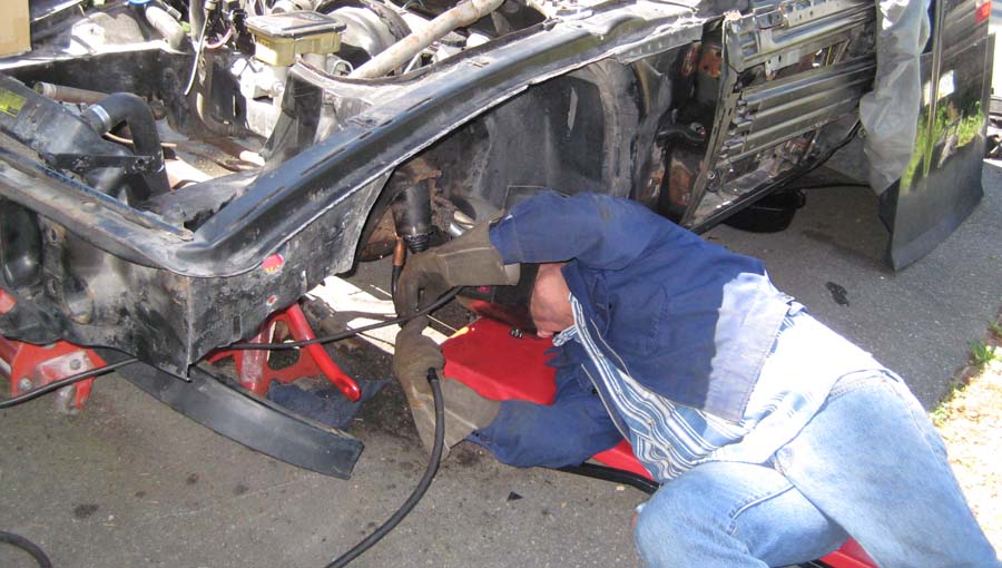

RBS is going to have the suspension tweaked first on a BUDGET

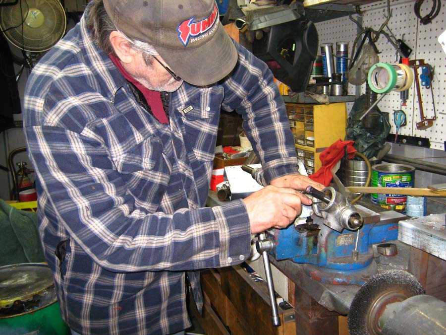

Clynt torching the old rubber bushings until they smoke, burn and slip off with Patrick pulling on chain.
We do it the biker way using a chain

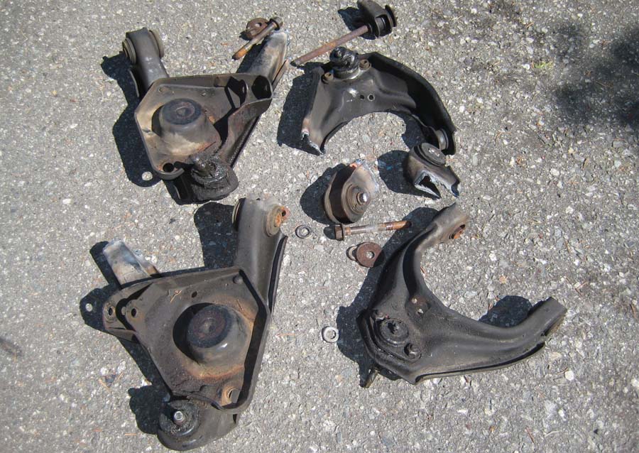

Blair showed me where he takes his parts for sand blasting at U-Blast in Langley http://www.langleyublast.com/Contact.aspx - HERE
That feels so good

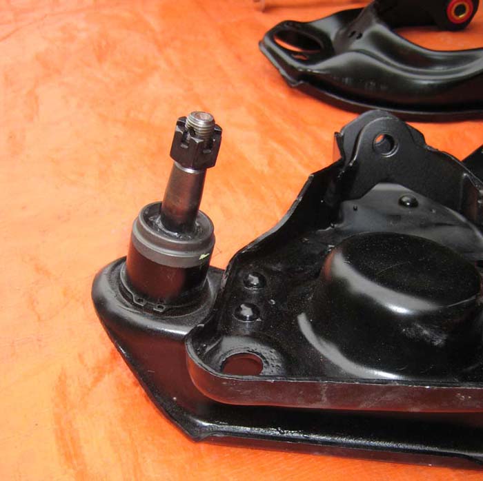

This is what the parts look like when stripped to bare metal.
Got the rear knuckles from Harrison.

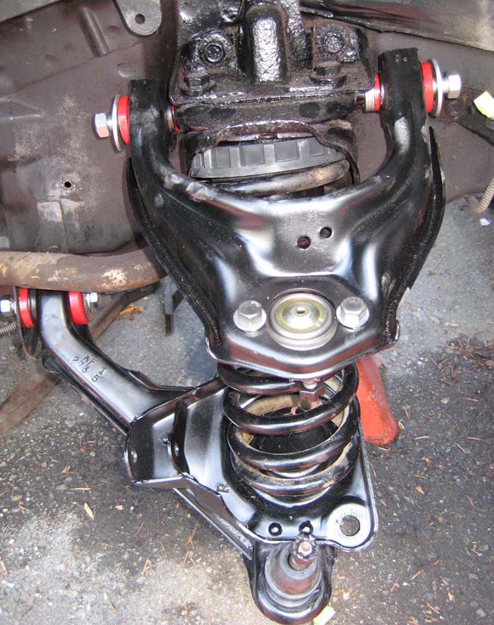

That's why Johnny hired Clynt & Patty's Budget Bushing Burning Business as we work cheap (for coffee and donuts).
I'm glad Johnny didn't post the picture of me on my ass when the first bushing popped out. I was pulling pretty hard as I didn't realize it would let go completely all of a sudden!

All parts painted for $18, (no powder coating) remember this is on a BUDGET.

The old coilover kit, changing to 400lb 7" springs, from 300lb 8" springs
Raise rear bump stop by Inverting bump stop plate and painted all parts black with KYBees painted Koni red

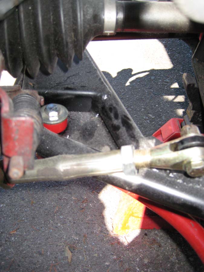

Johnny, when I dropped by yesterday with the ball joint popping tool, you were wondering where the rear camber adjustment bolts went. As this image shows, they go in the bottom hole.
I know your bolts are a bit different (I believe they're the same as what Colby got), but these are what mine look like. Yours have the eccentric on the actual shaft of the bolt, whereas these have an eccentric washer that rides against the protrusions on the strut (as in the picture above).

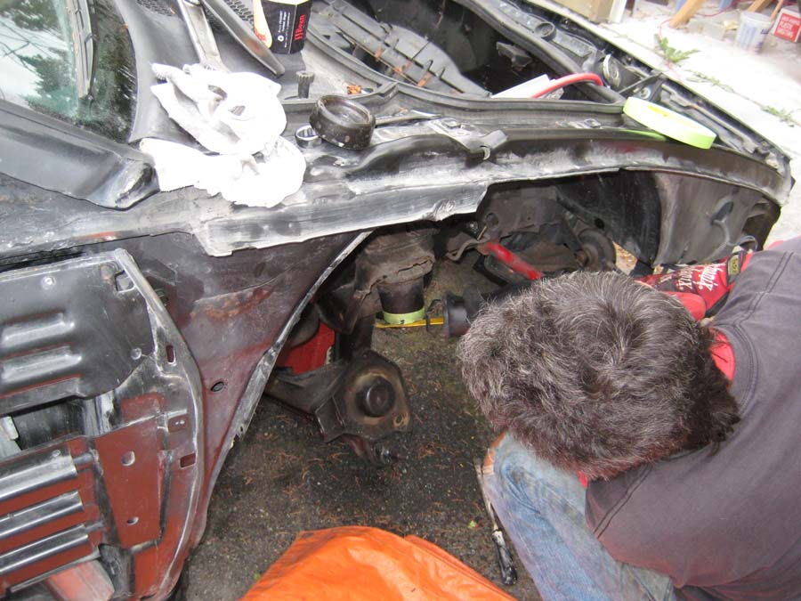

Finally the rear bump-steer suspension is in   .http://westshorefabricators.com/Fiero/Fiero-bump-steer.htm - http://westshorefabricators.com/Fiero/Fiero-bump-steer.htm
Fred (my brother-in-law at 84) helping me out installing (PAINTED ) Koni red struts.
Just have to slip on brakes next. As you can see in pic I've taken off all wheel well liners and later will be cutting wheel fender about 1"higher.

Patrick, these are the bolts you saw yesterday and I had them about 5 years now, I don't know how they work, maybe the wrong bolts?
So I put on the old ones for now, where can I get those camber bolts you and Colby have ?

Patrick, these are the you saw yesterday and I had them about 5 years now, I don't know how they work, maybe the wrong bolts?
Those are the bolts I have and they make adjusting the camber soo much easier. Just spin them until the black part is as lined up to the rest of the bolt as it can be and slide them in. You turn the head of the bolt to adjust the camber.
I think the style of bolt that Patrick has actually lets you get a larger range of camber, but the bolts you have already should work fine.

I have something similar to what Patrick posted.  However instead of a washer on the end, it is one molded oblong piece with degree's marked in it. Which allows you to set the wheels with the same camber.  I believe i bought it at Lordco for around 30 bucks.  I have them installed on all my pre 88 Fiero's.

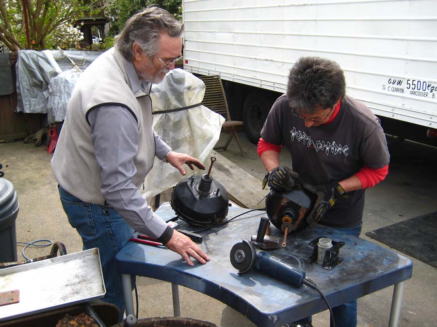

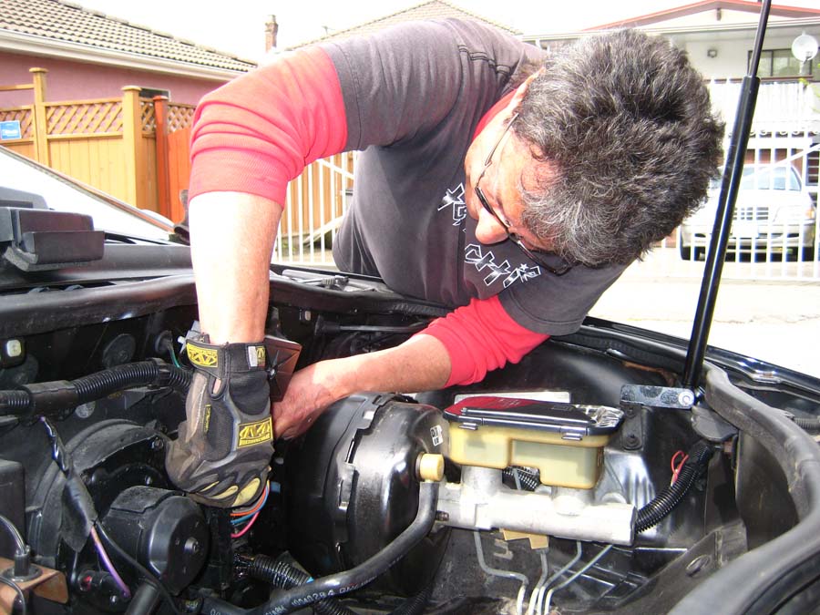

A couple mouths ago Clynt and Patrick helped me installing a larger brake booster for $50 from the wreckers.
Some fun shots of that swap, clynt showing me how it's done, then makes you do it
The brake booster did make a difference, it's a start for now.

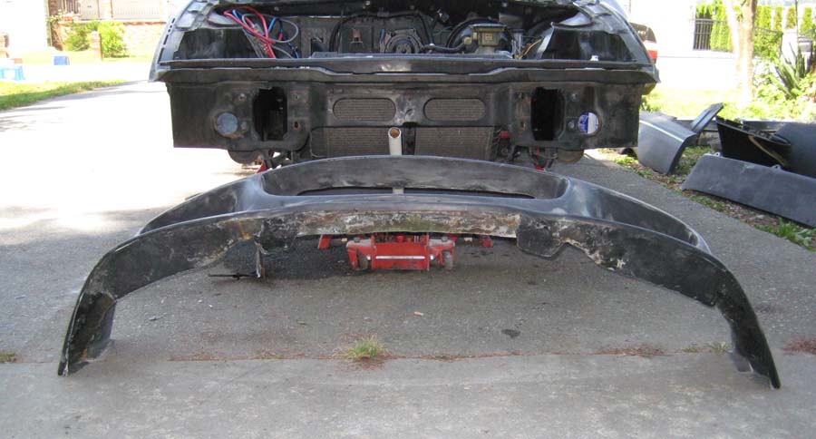

Hey Capt, the old RBS nose is ready for you to be picked up
Date Posted: 24 July 2011 at 11:04pm
Johnny Boy, when are you putting the new nose on? I wouldn't mind stopping in and helping out. With my camera.
Date Posted: 25 July 2011 at 5:58am
Thank You John.  Do you have an area to hold on to it for a while as I am horribly busy right now. Working all week, Lisa and I's wedding anniversary, and then a bachelor party on Saturday and a Wedding on Sunday.  I am thinking I might try and paint it yellow and put it on the front of my 88GT, as the change is subtle enough that it might not get noticed by ICBC collector people.
Date Posted: 25 July 2011 at 8:01am
No rush Capt, lots of room here, maybe if I'm out that way I'll drop it off in yard (dam fence is to high for me )
Romeo: it won't be for a while, got to shorten the front frame about 4" to 5" first

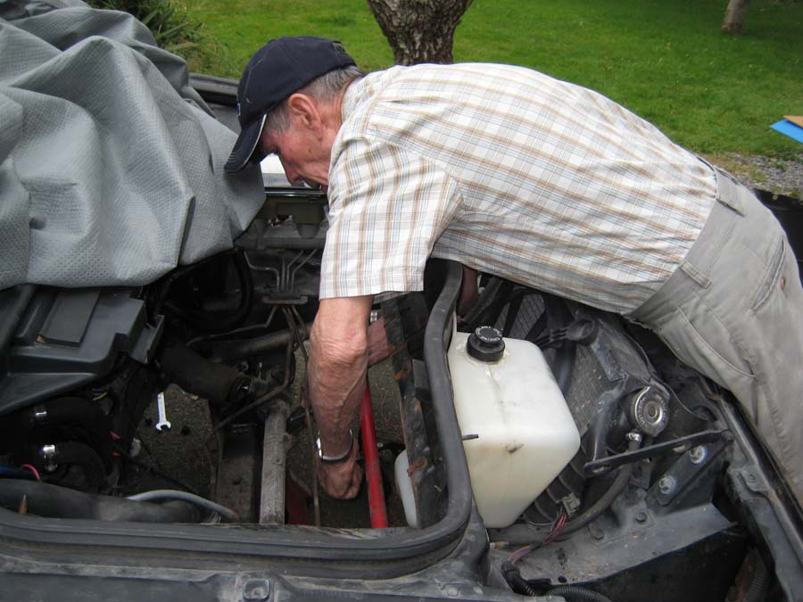

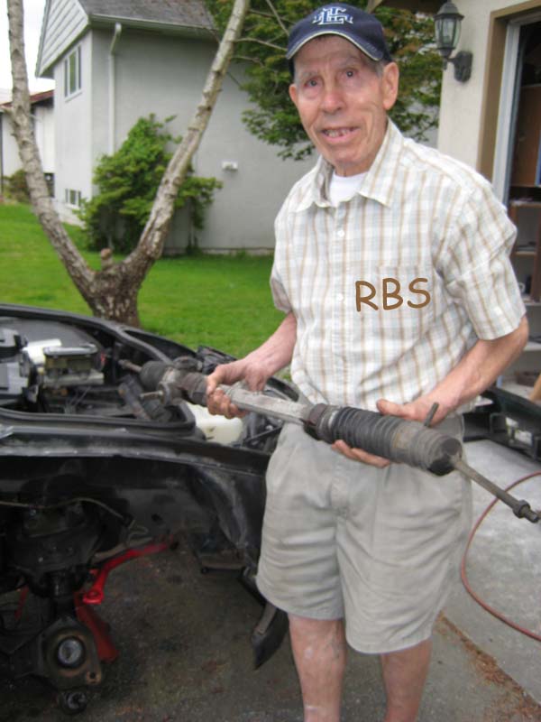

Today Fred taken off rack pinion steering (he's much stronger than me)
Got rack pinion steering from Blair last year with a latte, this spring our man Clynt rebuilt it ready to go into RBS

I wish, it's the same just rebuilt, nice clean grease, boots, bushings and inner tie rods

The front suspension and steering are all original parts (25 years old now) and will be replacing bearings and ploy bushings.

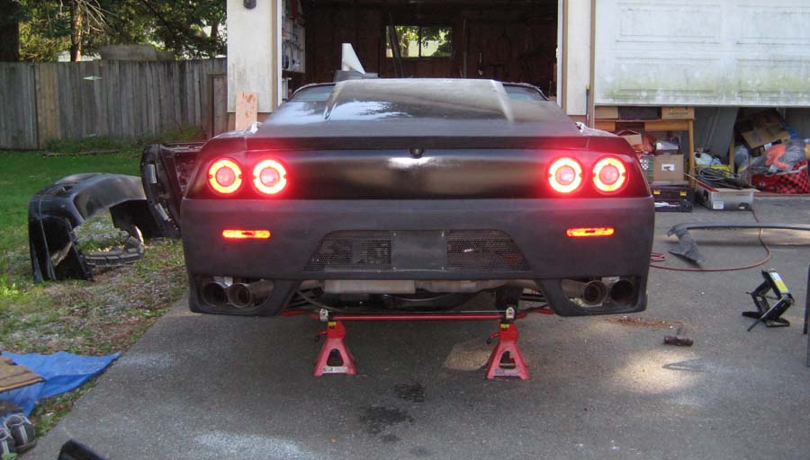

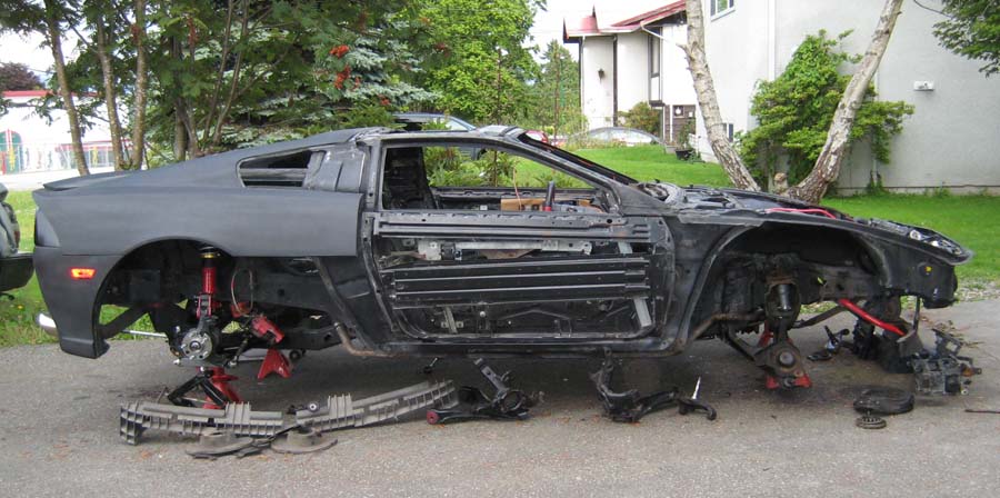

Date Posted: 26 July 2011 at 5:53pm
Today's pics...
Working on coneheads
Clynt stripping everything off in sight ( poor RBS )

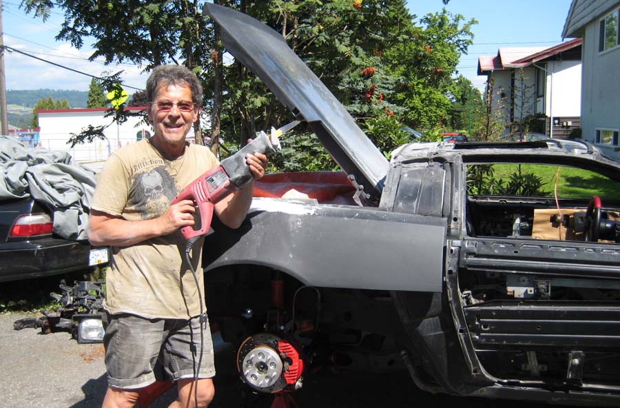

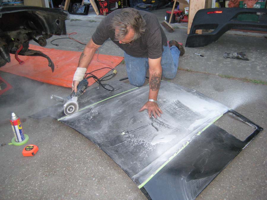

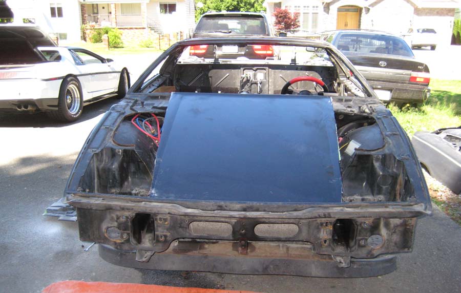

Date Posted: 28 July 2011 at 7:14pm

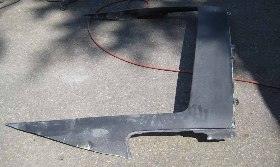

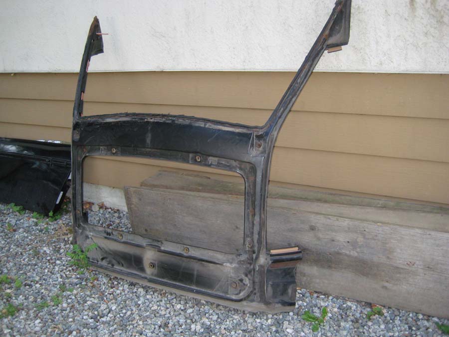

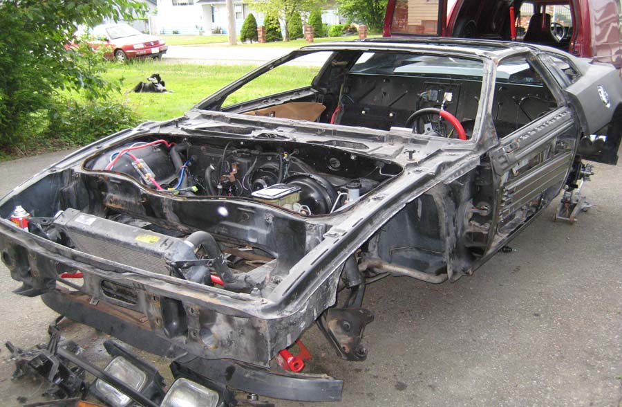

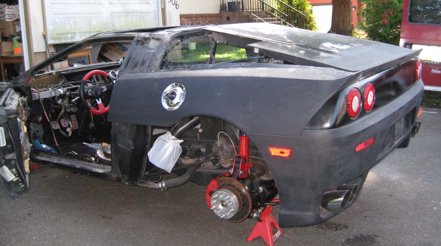

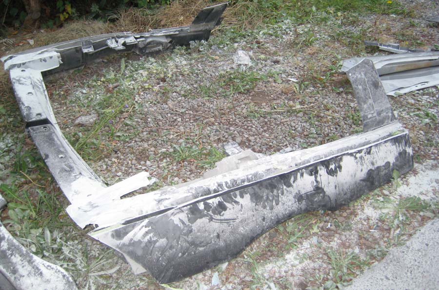

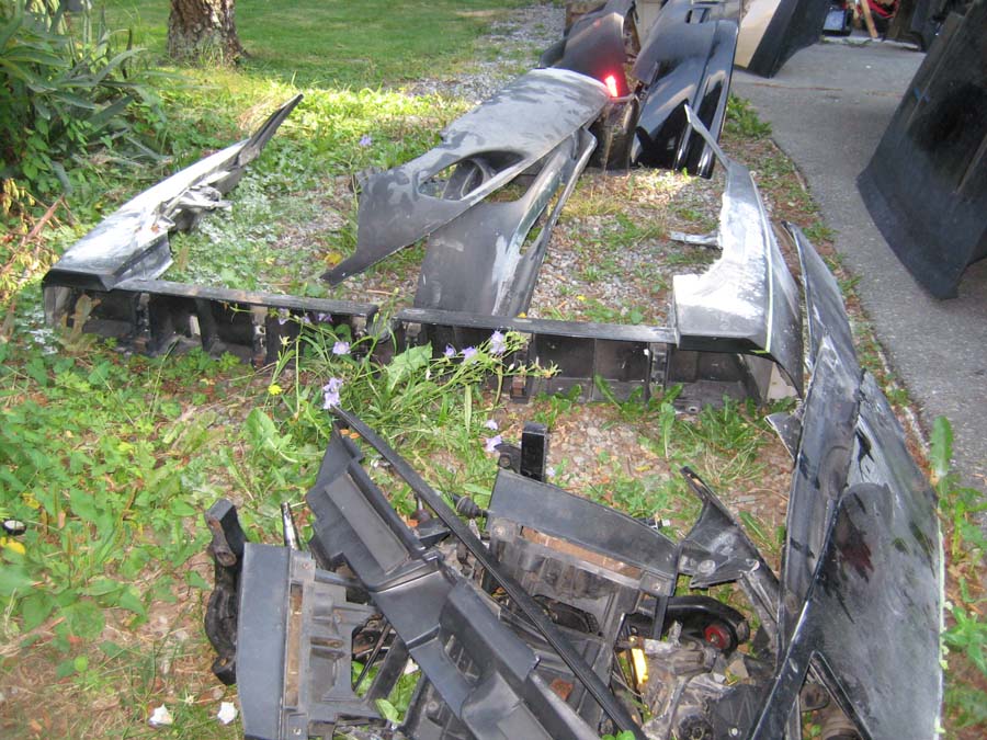

Nice day for butchering...
Looks great as a fastback...
Donating left over body parts to WCF Club Locker...

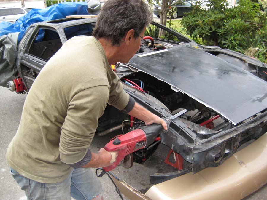

Date Posted: 31 July 2011 at 9:34pm
Hard working pensioners...

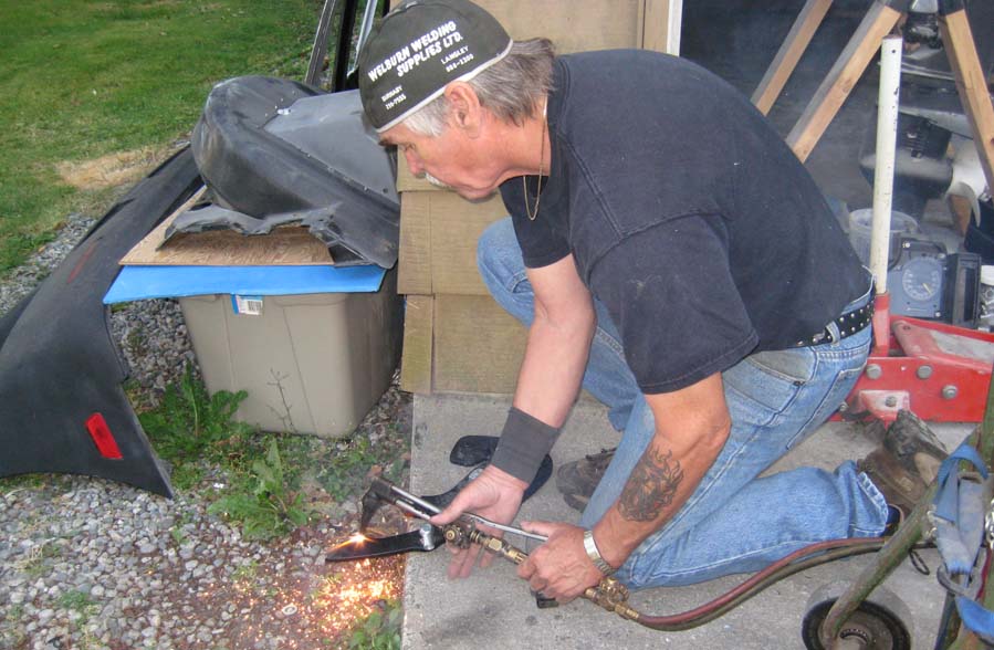

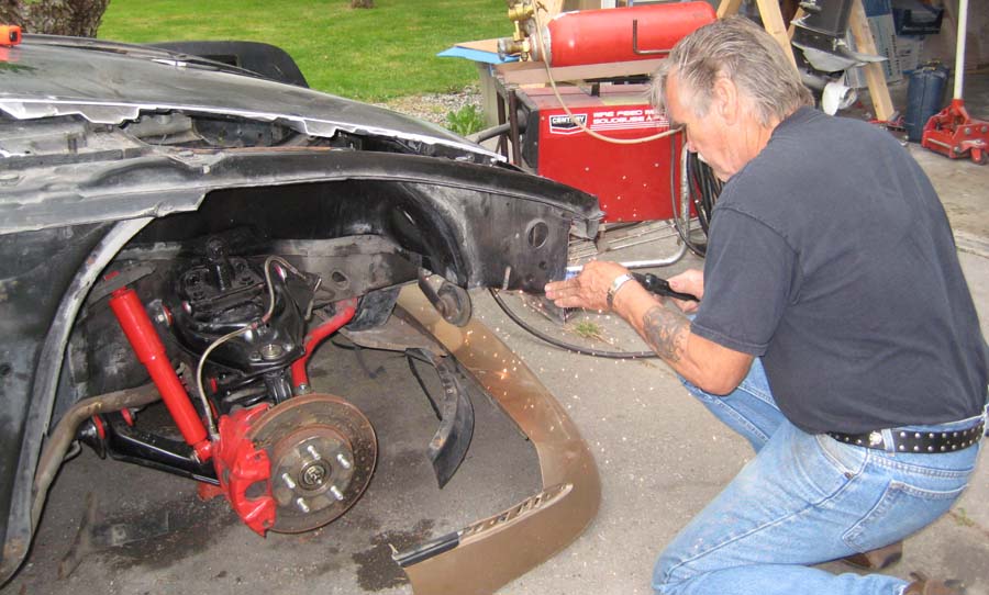

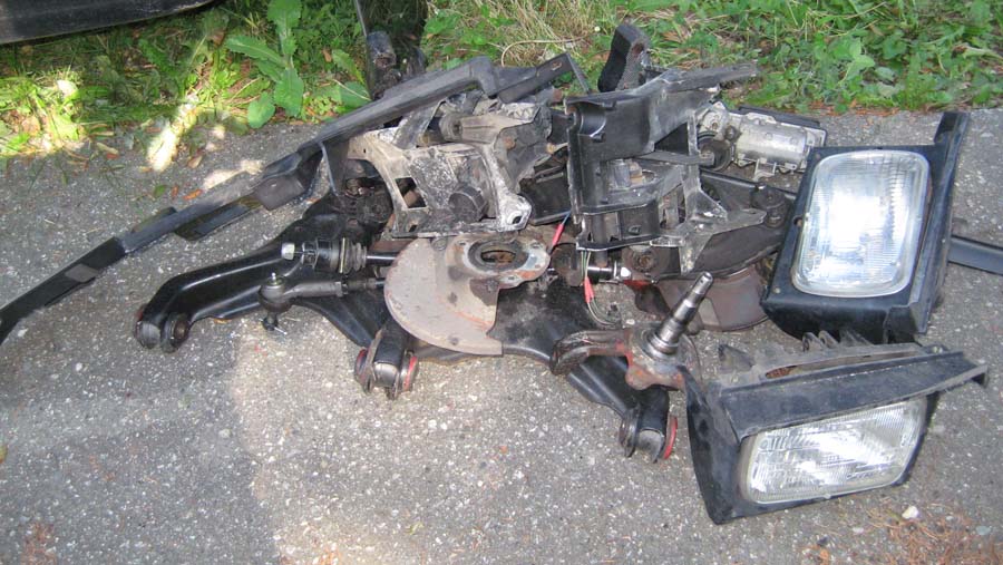

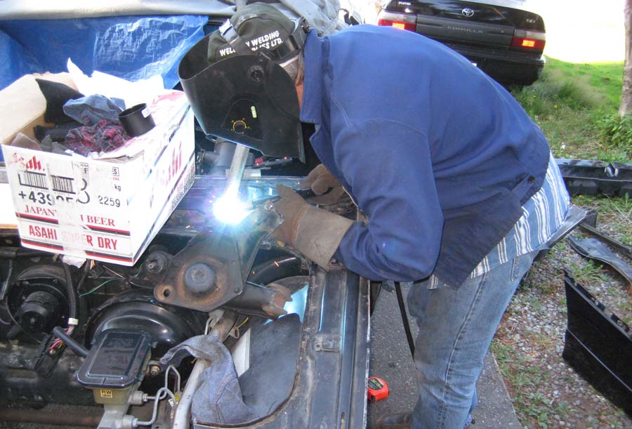

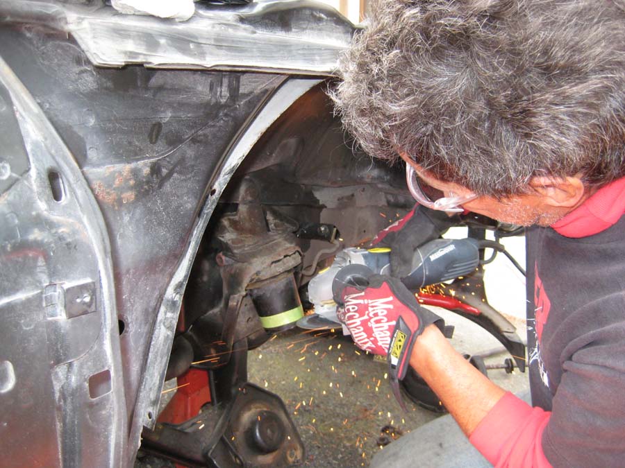

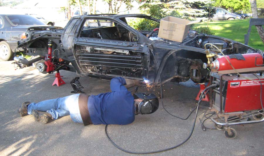

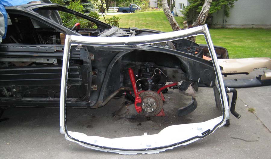

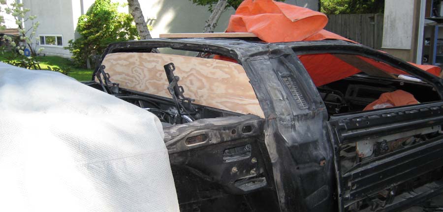

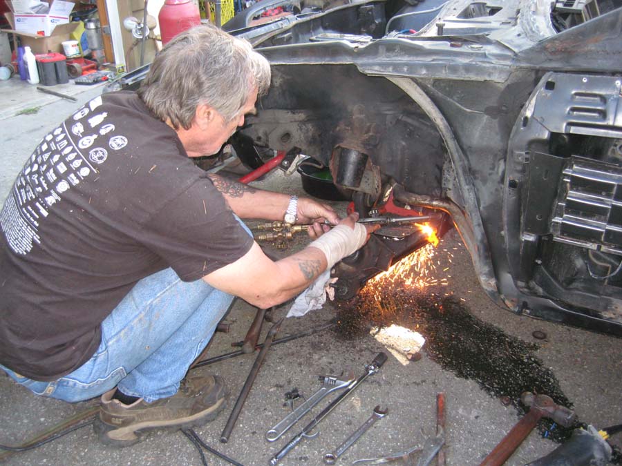

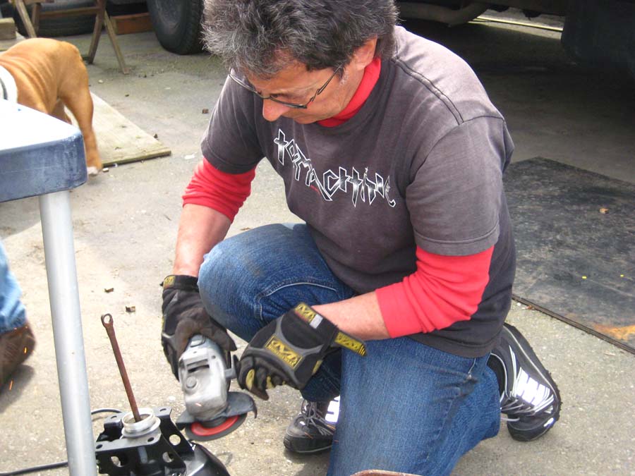

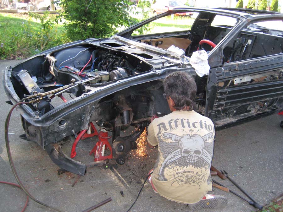

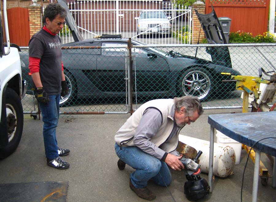

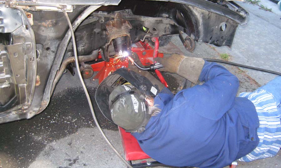

Today was the hardest, taking off front a-arms, grinding torching
I was grinding headbolt, grinder kick up into coolant tube and sprung a leak
Clynt torching a-arm off
Finally a-arms are off and ready for a clean suspension install

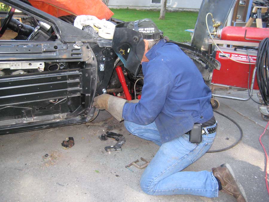

Clynt welding door shut

OMG, what have you guys done!
Looks like you're preparing RBS for the scrap-metal guy.
I'm getting worried.

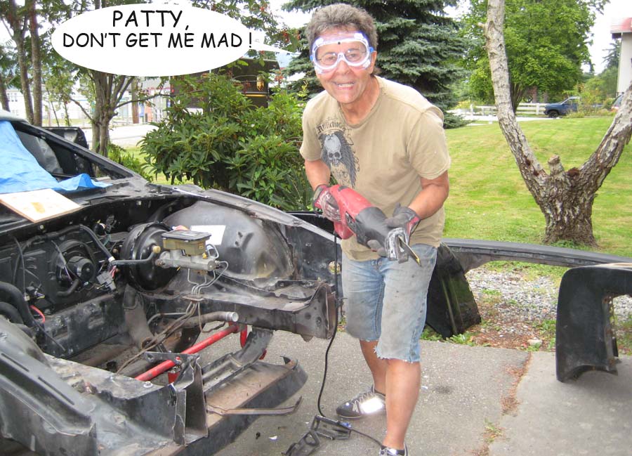

just wait and see how crazy johnny boy really is with a sawzall and grinder  ..the fun begins
Date Posted: 01 August 2011 at 6:10pm
Oh gawd, this really is serious... Clynt posted!

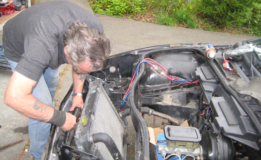

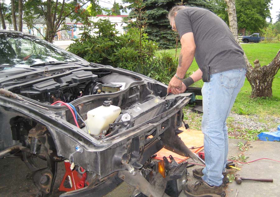

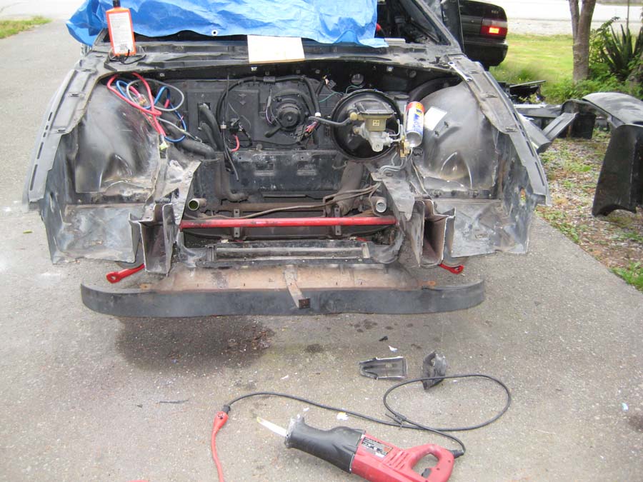

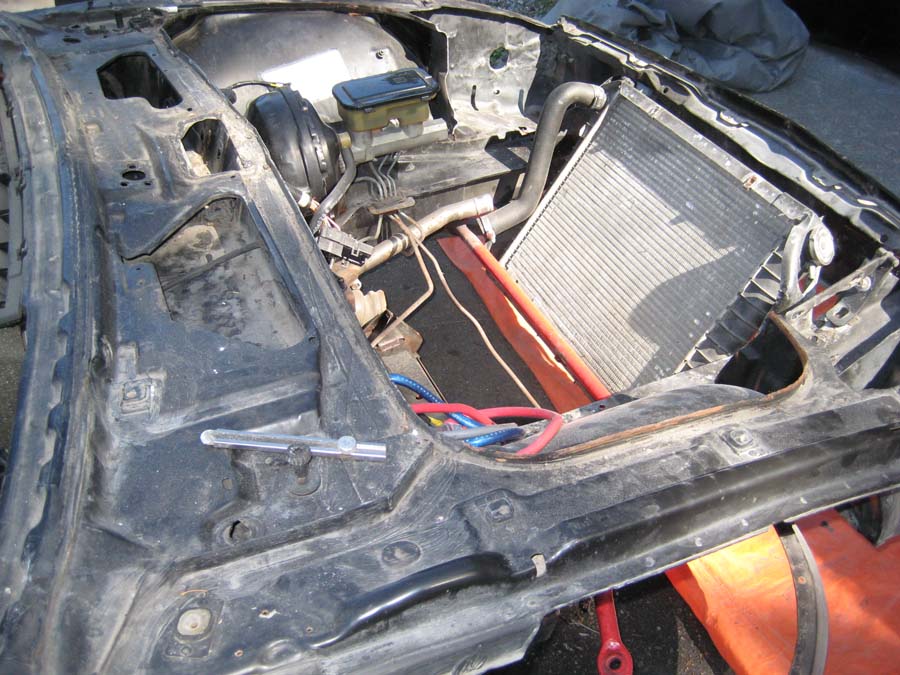

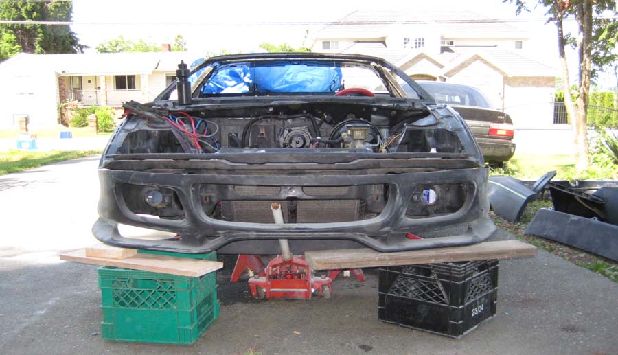

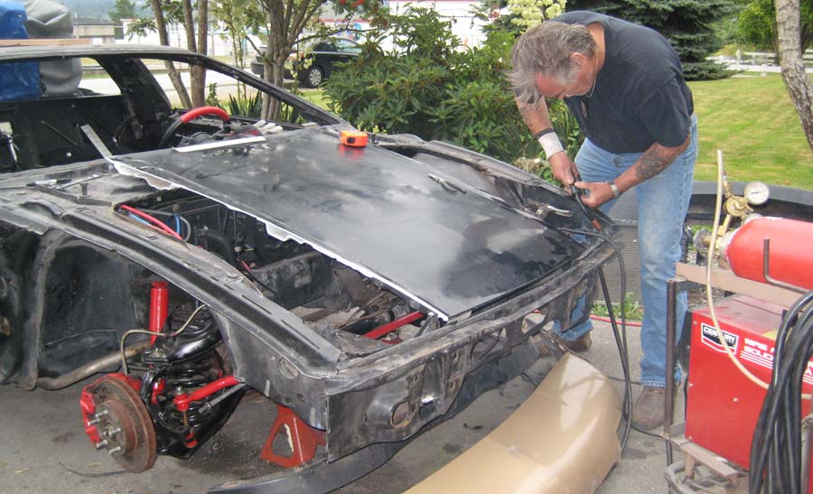

Relocated rad, it's mounted back and lower angle
Hood is sitting lower at a nice slope as you can see front frame to be cut to match hood.

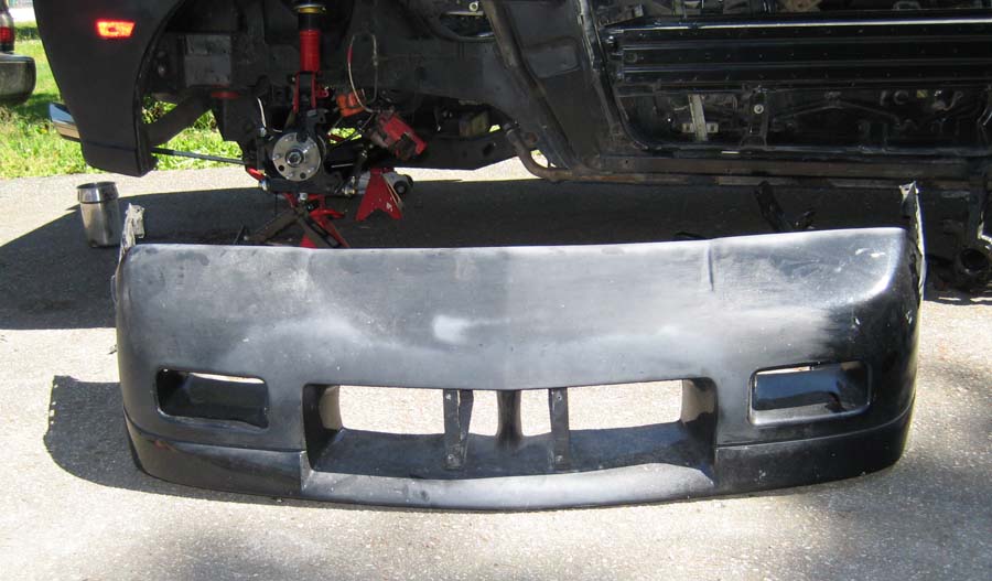

Date Posted: 02 August 2011 at 4:57pm

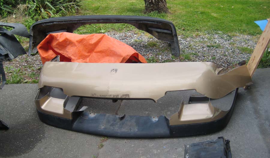

Here is the RX7 nose, it was to wide and I cut it to fit, that was a long time ago (maybe 3-4 years).
Clynt and I took the nose down from the garage rafters, it was full of dust and place it in front and it wasn't going to
work out at all. It was way to wrong and too round. I'm going to use Tim's old stock nose that Dave gave me and I'll play
with that.
Way to round for me, the stock nose is easier to make changes to and it will fit

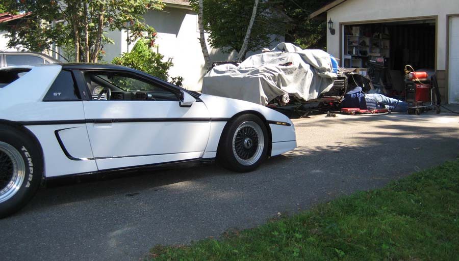

Date Posted: 03 August 2011 at 9:55pm
With Clynts chopper parked in the front driveway we hardly get any work done as people stop by and ask questions about his
chopper. One cool dude stopped by with his Mustang ragtop and he was just salivating over Clynts chopper, then he was
talking cars then ended up talking about politics to us
Clynt is finishing welding up the coneheads and tomorrow I'll start to install the new front suspension parts.
Clynt is welding up my leaky coolant tube that I mess up yesterday, the old A-Arm on top of the cooling tube is to weigh it down
while he is welding.

RBS's boneyard
Posted By: clynt
Date Posted: 05 August 2011 at 6:50pm
johnnyboy  ...you crazy man ..look at all the stuff i got to weld back on..

This morning had a Latte & muffin at Blair's, got great instructions from Blair how to install front suspension (thanks Blair)
Started to install NICE NEW CLEAN PARTS, tomorrow I'll finish the front suspension.
I'm using Dickman's 1" Drop Ball Joints, it's welding in on the bottom side.

More car crazy people stopping by...
This one lives next street over, saw him driving by a few times and today he finally stop by and was curious what I was up to
stripping a nice custom Fiero, then it was Show & Tell time (so not to much got done, installed steering rack, breaks and some cutting )

Damien's (Dawg) roof ended up at RBS place (ready to be butchered by Clynt and Johnny Boy)...
You can see Damien's black notchie tear down http://www.westcoastfieros.com/forum/forum_posts.asp?FID=10&TID=2595&PN=1&get=last - HERE

Tim's old nose got chopped up today...
A little tease...
Date Posted: 10 August 2011 at 8:26pm
Nose is being put together...
Clynt tack welding front frame back, it's sitting 2" lower and 2" shorter, it's the wedge look
Cutting and bending sides to meet 2" lower front frame
Date Posted: 10 August 2011 at 9:24pm

This is a CLIFFHANGER THREAD...
About the windshield, keep on checking back

Hum, what is Clynt torching off
Date Posted: 12 August 2011 at 8:29pm
My good pal Patrick stopped in to help and it's a good thing he did, he caught a few mistakes I did (but I'll never tell)
Romeo you'll be happy that I'm cutting off lots of fat, it's pretty thick and heavy, ( looks like a slab of halibut)

Clynt is tack welding something

Date Posted: 18 August 2011 at 7:30pm
RBS is going on a diet...
Removed 20lbs of fat from rear clip
Date Posted: 18 August 2011 at 8:18pm
BOO YEAH! Put her on a diet, Johnny Boy.
Date Posted: 18 August 2011 at 9:27pm
She's going for a tummy tuck... RBS is going to look lean, mean and sexy
Overall chop will end up 4" , making it miserable for Patrick

With the new bump steer suspension, I had to relocate the sway-bar from the back to the front (just like Patrick did).
There was a hole already on the a-arms and I just flipped the sway-bar around and bolted to the cradle
Date Posted: 21 August 2011 at 3:04pm
Johnny, it's fortunate that the sway bar mounting brackets were able to be attached directly to the cradle (no spacers required) just in front of the lower control arm bushings. Looks great.

Blair just called me and the VDC hinges are all finished welded up, it will be lift off time
Thanks Blair
