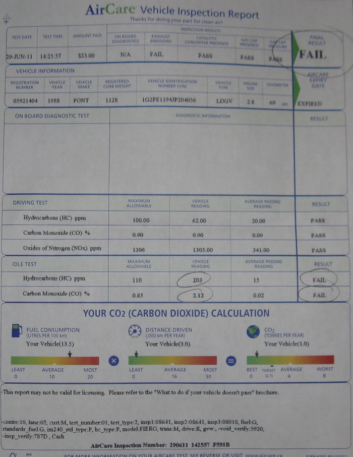

Hey Colby, you should post your aircare report.
Date Posted: 30 June 2011 at 3:42pm
Uh oh...

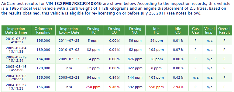

Date Posted: 30 June 2011 at 4:16pm
Sure, here you go:
The car is running rich and you can smell it. What could cause this? I'm thinking to check the timing and replace the O2 sensor before trying again. I kind of thought it would fail, I just needed to do it since I couldn't transfer the last two months of insurance over from my old car without at least failing.
Date Posted: 30 June 2011 at 4:44pm
Colby, these are your readings from http://www.aircare.ca/inspinfo-get-results.php - Here .
Has this car never been AirCared previously?
Here are the readings from my '86 GT with no cat (which I posted about http://www.westcoastfieros.com/forum/forum_posts.asp?TID=1727&KW - Here ) just to compare with your readings.
Are you absolutely sure you can still transfer the insurance? I was told I could NOT transfer insurance over from my '86 GT to my '84 unless the '84 passed AirCare.
Date Posted: 30 June 2011 at 5:16pm
Yep, first time through and first fail, that means I'm allowed at most 3 months of insurance. I transferred it last night.
It looks like if the car was an 86 it would have passed easily.
Just for reference, this is what my duke did:
The difference between 2008 and 2009 is a working EGR valve.
Date Posted: 30 June 2011 at 5:25pm
Ah right, you're lucky!
My duke didn't want to feel left out, so here's it's readings compared to your duke.
The difference between 2010 and 2011 is a functional cat.
Date Posted: 30 June 2011 at 5:29pm
What changes did you make to your duke between the two most recent results?
Edit: I see you updated your post.

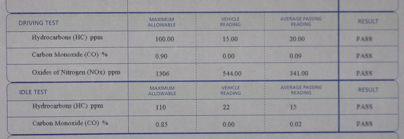

Date Posted: 18 July 2011 at 2:51pm
Yay, the car passed!
So, what changed with the car? Well, I had swapped MAP sensors with a known working one, and at the end of the last meeting, David had a scan tool with him and determined that the TPS wasn't in the correct range or something like that (Thanks! ). I think these things solved the richness. Rather than take it through again, my dad and I decided that we would replace the cat with one we had in storage here. When the old one was out, I decided to take a look at it and found that I could see right through it, it was empty. With a working cat and the car no longer running so rich, getting through AirCare was easy.
Posted By: Graeme
Date Posted: 18 July 2011 at 4:42pm
I think I had mentioned that the cat most likely needed replacing because I knew the previous owner hadn't done any work and I didn't do any. My GT needed it too when I bought it, same idea, could see right through it... crazy stuff.
Great to hear you got it aircared. Great readings too.
Date Posted: 18 July 2011 at 5:00pm

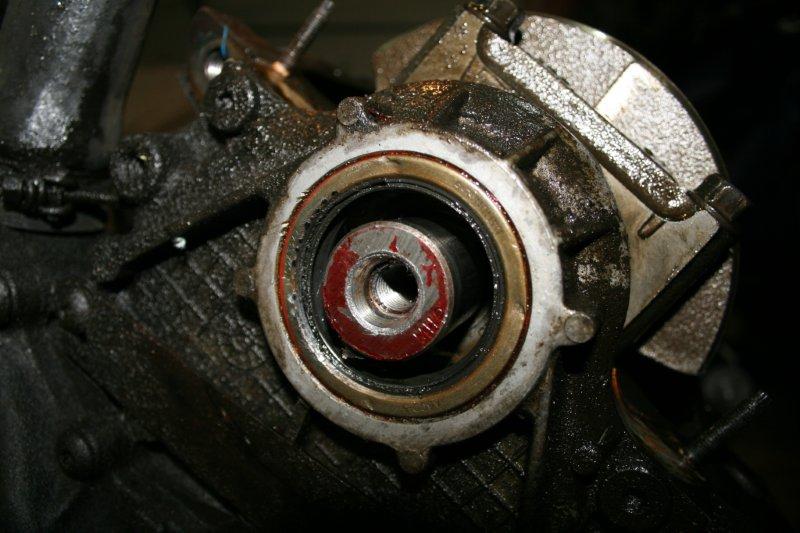

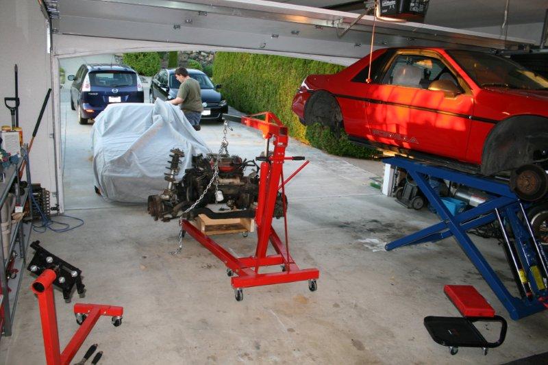

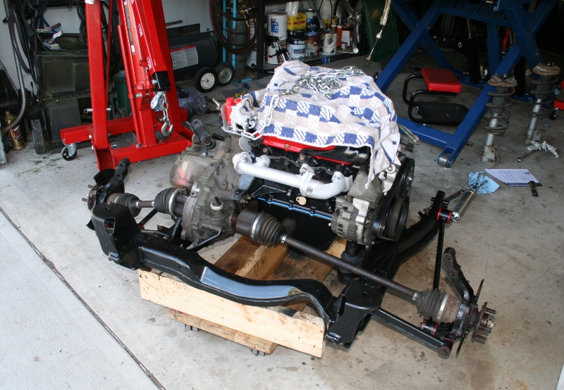

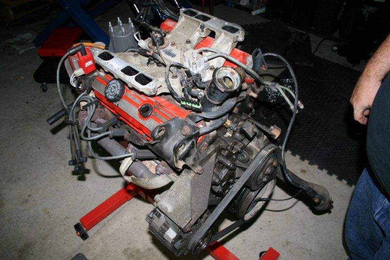

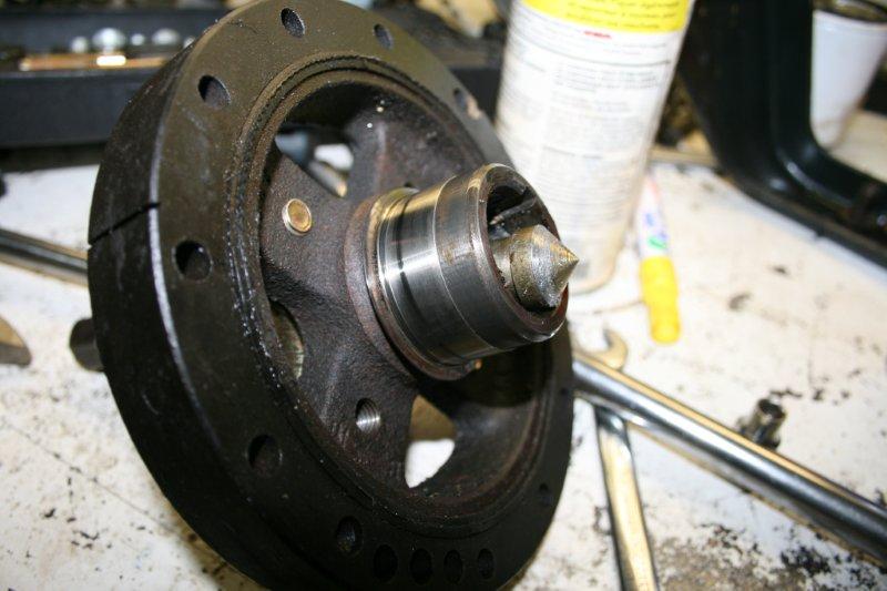

So, as an extension of this thread, i felt best to post here, the chronicles of the Formula's overhaul.

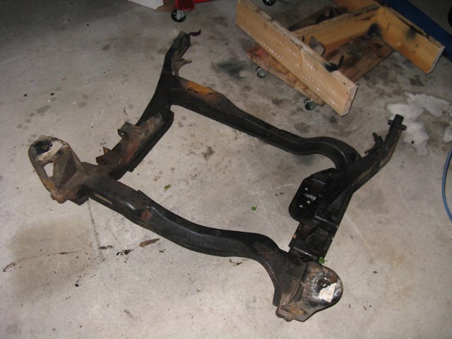

it starts with a Cradle removal and getting the engine onto the stand.
then i started removing the bits. i found some history with the harmonic balancer. seems someone had a leak they tried to repair with a sleeve and a new seal. the only problem is the seal was hammered in and then the harmonic balancer was set in to locktight and hammered on. pretty poor...
anybody have a balancer they want to part with?
Gary
Date Posted: 07 September 2011 at 11:17pm

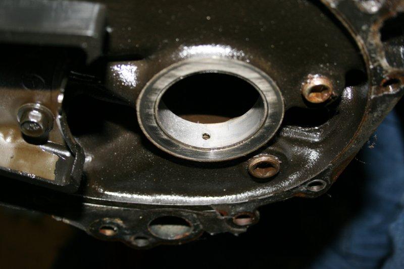

Gary, that seal installation definitely looks poorly done.  It's difficult to tell from the pictures though, but is the harmonic balancer actually damaged (from being pounded on)?
It certainly seems strange to me that a low mileage engine would've required a sleeve on the balancer. What would've caused a groove to have been worn into the balancer in the first place on an engine with less than 70,000 kilometers on it?
I changed the balancer on my '86 GT (almost 200,000 kms) because the rubber part of the dampener had deteriorated to the point where the outer ring had begun to spin. Made timing a real challenge!  However, there was little appreciable wear on the balancer where the seal had resided.
Date Posted: 08 September 2011 at 10:36am
My conclusion would be that the engine in fact has way more miles
on it than first thought.
As for the balancer repair, not uncommon to do it that way. Fiero
balancers are no longer available. There is a balancer that fits but
the timing marks are wrong.
The guy could have been more careful with the seal however.
Barbarian....:)

I thought about the way too many miles on it item too but since I have a near perfect 88 fiero here to compare to. I can say that the engine in the formula just felt and is stronger in comparison and my 88 here is no slouch. It's an absolute shame to see such problems, I would never have sold the car had I known any of these things.
Posted By: karnak
Date Posted: 08 September 2011 at 9:14pm
The balancer may have had a sleve put onto it to make the diameter larger .. for the sake of the seal... the other side's seal was dry but has no signs of leakage. i want to look for a balancer and make it right since it is so easy to do now. pictures in a bit...
Date Posted: 08 September 2011 at 9:19pm
The balancer may have had a sleeve put onto it to make the diameter larger .. for the sake of the seal
Well, the seal is designed to ride directly on the hub of the harmonic balancer, so without a groove having been worn into the balancer I don't see a need for the sleeve. (Take the sleeve off, let's have a look!)
Anyway, let's see those pictures.
Date Posted: 08 September 2011 at 9:22pm
Gary, I ordered my balancer from the Fiero Store and David installed in last year...but the marks are off so will have to score on your own timing marks.
http://www.fierostore.com/Product/Detail.aspx?s=65401 - http://www.fierostore.com/Product/Detail.aspx?s=65401

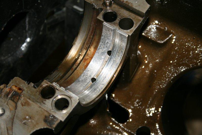

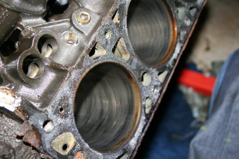

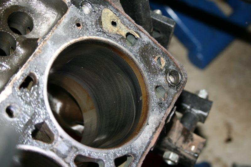

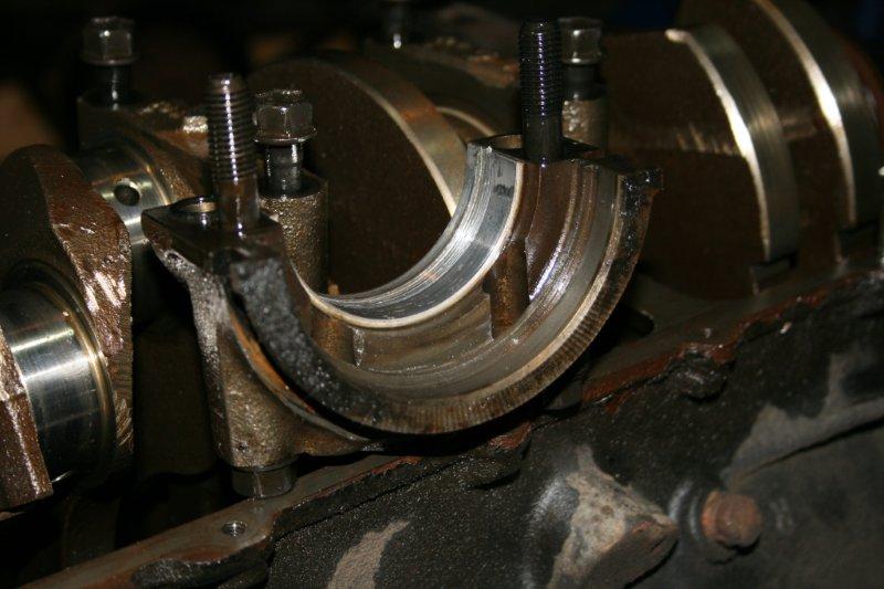

ok.. here are the pictures!
the first couple show the main bearings. notice the pitted look and the 'flake' that appears to mottle the surface. there are groves on all the main bearings but the crank is 'ok' (but was starting to wear). it would seem to me that only the one connecting rod bearing was really shot. (stamped GM, so we know it was OEM)
this next picture shows a cam bearing. you can see on one side (lower) there is a difference in appearance from the other. this is like a corrosion from sitting and being under-oiled for too long (i suspect).
finally, the cylinder walls. there is a very mild ridge on the top of the bore and that ridge is not detectable on the sides (just on the edges).
a quick run thru with a hone will be all it will need.
note the crosshatch i s still visible.
well .. i am taking a small break from the motor and will post more pictures as i do more.
the other internal components of the motor are clean and re-usable.
Gary

Date Posted: 09 September 2011 at 4:36am
Ya those mains don't look to bad at all, and being able to see the cross hatching means the motor does have low kms on it.  Glad to see that there were no major surprises.

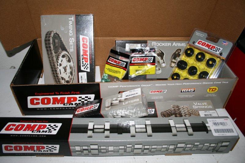

I would mix all the main and rod journals and see if you can get away with stock mains and then go .005 under rod bearings.
I have used the clevite tri metal bearings before, a little more money, but in a 2.9 (bored out 2.8) with 10-1 compression, shifting at 7000rpms nitrous assisted, I destroyed a piston and tore the engine down the bearings still looked like new.  All make sure to pick up a high volume oil pump.  It has the same pressure relive spring as stock, however much larger gears in the pump.  It allows the use of 5w30 full synthetic for great oiling and yet still have 80+ psi of oil pressure.
Stock pistons will be fine just get some good rings.
Here is the cam I used and loved it.  Couple it with either 1.52 or 1.6 roller tip rockers and it was great.   Oh and pick up Comp Cams lifters 858-16 they are a fast bleed lifter.  At idle and below 3000rpm, they bleed down fast making an aggressive cam seem mild so you get great torque and idle.  However over 3000rpms, the lifters pump up fully and allow you to take full advantage of the cam with great high rpm power.
Just in case you did not already have this info, this is from my 2.9 building days.
Hope some of this helps.

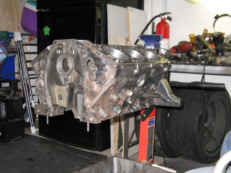

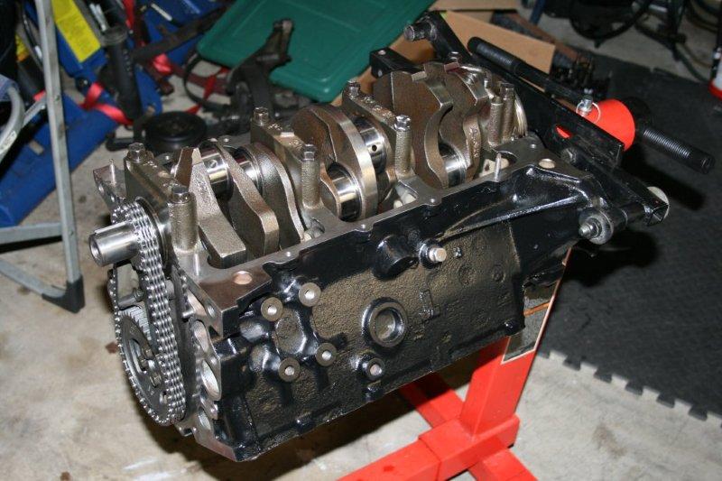

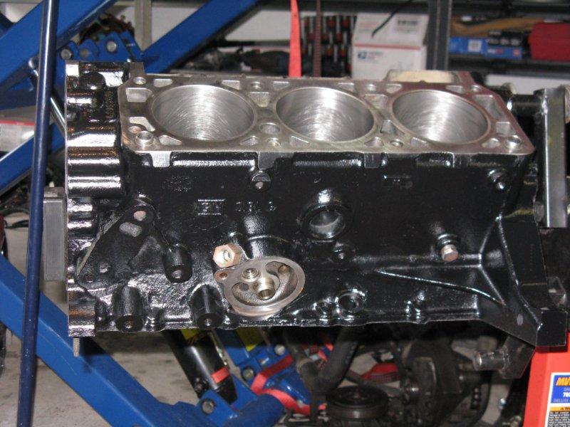

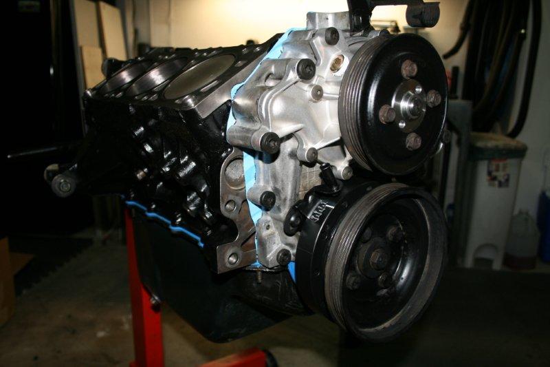

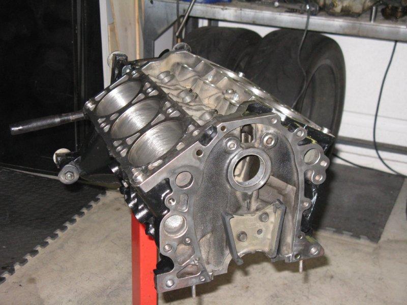

here are some shots of the block. Today i cleaned, and re-cleaned the thing until it was ready to take paint.
Before:
During:
After:
Now we are sort of waiting for parts. i will be cleaning up some of the brackets and tubes for painting. not too exciting.

i think the motor did have issues early on and it was parked. the lower cradle rust is definately an indication that it sat over earth for a time. later on i think someone came along and forced the bearing that had locked up to spin (causing this issue). the sold the car as a runner and with low K.
all the time sitting basically ruined the bearings.  there is evidence that the clutch was changed but i believe the motor is original. the bolts that i removed do not look like the had been tampered with...as best as i can tell...

In a home shop environment, what's the best way to clean that block (and oil galleries) of contaminants from the worn/scored bearings?
Posted By: karnak
Date Posted: 19 September 2011 at 9:36pm
well Patrick, i think it is best described as over and over.
i started with the heavy dirt removal and finished up with a tap to clear threads and a good washing with clean clear solvent.
before any parts go back in. it will be cleaned again. blown with compressed air and critical areas (bearing / gasket surfaces) will be carefully cleaned to ensure a perfect fit / seal.
when the motor gets first run, it will only run for perhaps 5 mins or so. then the oil will be changed. (cant wait for that...)

For the first bit, i took the block and put into the litter box for a "up close" scrub before just using the litter box for a drip pan.

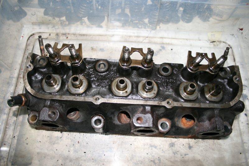

...still waiting for some parts and the crank to get done and am starting the cleanup on the heads.

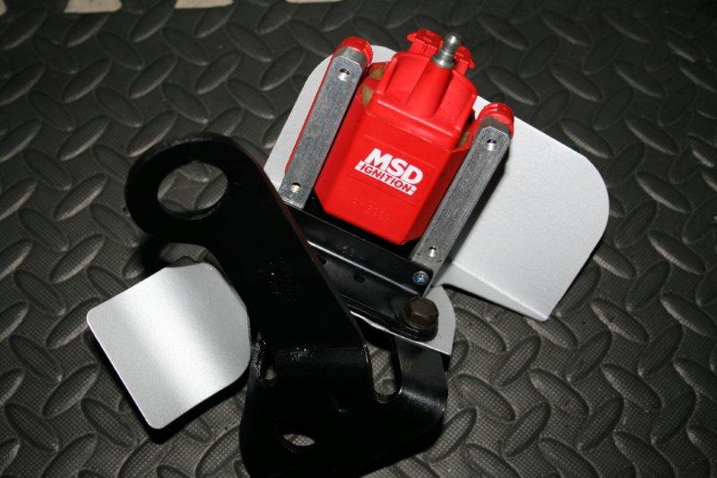

some stuff arrived today  this will go a long way to ensure the top end will not give any surprises.
one to the valve springs had a broken clip on it and of course all the seals were cooked.
here is a before shot. (just so it is here)
getting ready for the scrub down:
here is a bracket and some sheet metal that i had brought back from beyond the grave. i used hi heat gloss black and a flame proof ceramic matte silver paint to help it to  "pop"
well, that is all for now.

Cool!  What are the specs on the parts you bought?  Stock-ish or mild performance boost?
Date Posted: 24 September 2011 at 12:06pm
Well, the cam was advertised as being good for towing, if that helps.
It'll probably be a bit better than stock, but they're not really high performance parts. I just want a car that's pleasant to drive and I don't want to deal with anymore issues like this for a long time.

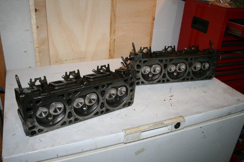

Well, this weekend i did a ton of cleaning. The heads are ready to be
built back up and the pistons and intake manifold have had 2 out of
4 cleanigs. Colby has the cradle stripped and will start cleaning it
shortly.

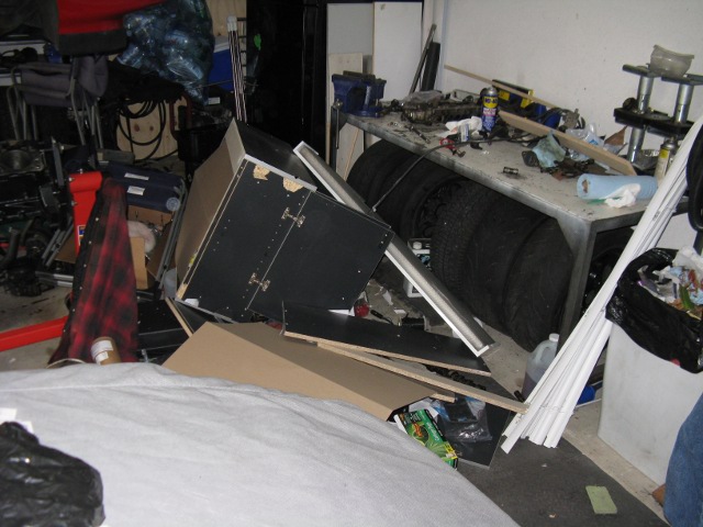

The weekend was not without some excitement though. We have a
cupbord above the workbench that randomly fell down. It was a bit
scary and could have been costly... think we dogged a bullet there.
One of us will post some pics soon...
You will see that the top, back fell apart as the mount they give you
to hold it up is still up on the wall. This is the type you get at
Canadian tire that is in their flyer quite often. Dont buy them.
we had some wire in one and books in the other. They were empty
enough that there was room for the pistons and old cam (none of
which was heavy)
Date Posted: 25 September 2011 at 10:47pm

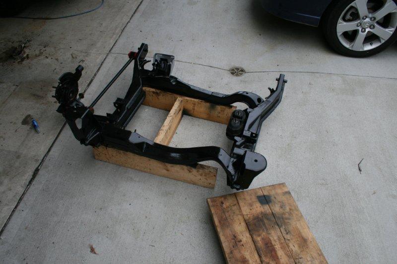

Yeah, I was busy removing the last piece off the cradle when suddenly this happened:
The cradle is stripped now and ready to be restored.

Sheving gave in?
Posted By: AllanJ
Date Posted: 26 September 2011 at 8:22am
Sucks about the cabinet, bro.
Particle board = the "Potato Buds" of furniture.
If you buy more crappy cabinets in the future, screw a ledger board to the studs underneath the cabinet for the cabinet to sit on.  Will greatly reduce the stress on the crappy particle board when you screw that to the wall.

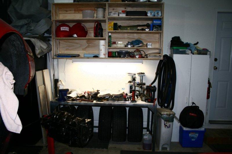

Date Posted: 01 October 2011 at 7:57pm
took a bit to get to post bu from the pictures you can see the "potato buds" are gone and 5/8" plywood has the workbench back in business!
...also, the cam and crank are in along with the timing chain and rear seal

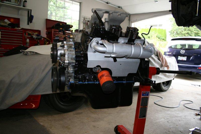

So it has been a couple of days so i thought i would toss in a couple more pics. Most of what i have done is clean. Clean and Clean...
things are shaping up though.
here is a shot of the motor with the modified balancer installed. i grooved it and filled the groove with white paint.
the heads with new valves, springs, seals etc.
..and now, installed and torqued.
push rods and rockers next!

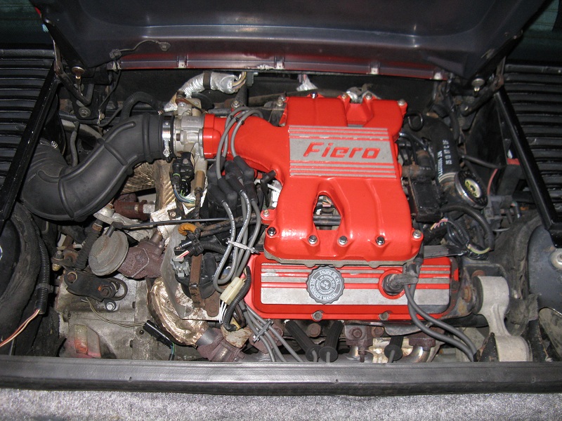

Date Posted: 11 October 2011 at 9:10pm

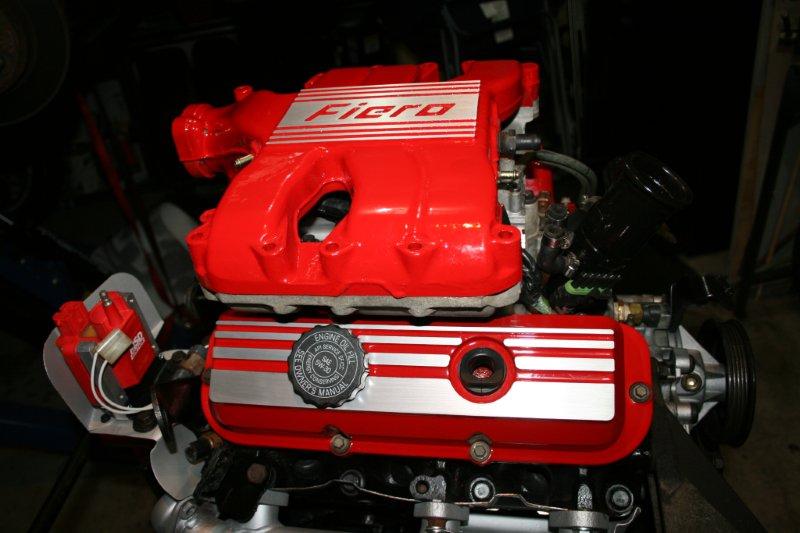

...been a while, so here is a bunch more pics...
first, a updated cradle shot. it is moving forward.

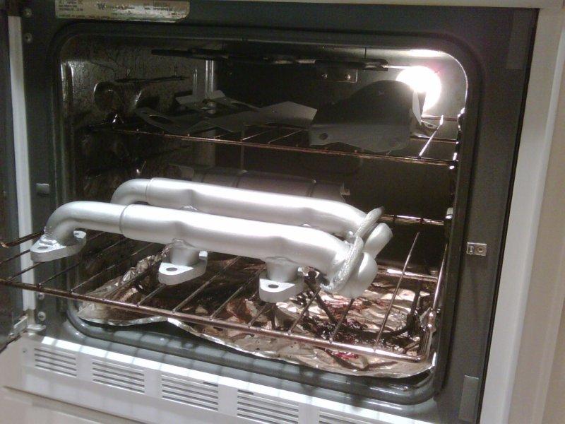

here is some "cooking" i was doing. lol.
and the parts on the block. cleaning up nicely...
here are a couple of the motor, nearly done
and a before / after just to show how far it has come...
i can't wait for this to get wrapped up...

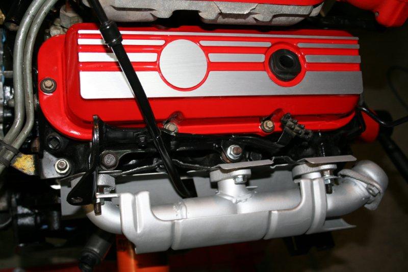

Please tell me you ported those exhaust manifolds!
Posted By: Graeme
Date Posted: 11 October 2011 at 9:29pm
wow.. that looks amazing. I'm really glad this car went to the right person. A jewel in the rough (rougher than I had an idea about...) but very shiny now. I can't wait to hear how it runs.
Posted By: karnak
Date Posted: 11 October 2011 at 9:51pm
I can't wait to hear it also and yes, the extra metal was removed from
the pipes and a crack was welded.

Date Posted: 12 October 2011 at 4:27pm
That's not your stove in the kitchen is it?

Date Posted: 12 October 2011 at 7:23pm
yep that is the kitchen. the oven is slated for replacement.

We've made a bit more progress the last few days. The transmission and engine are together again on a freshly painted cradle. We're getting pretty close to being able to start it for the first time.

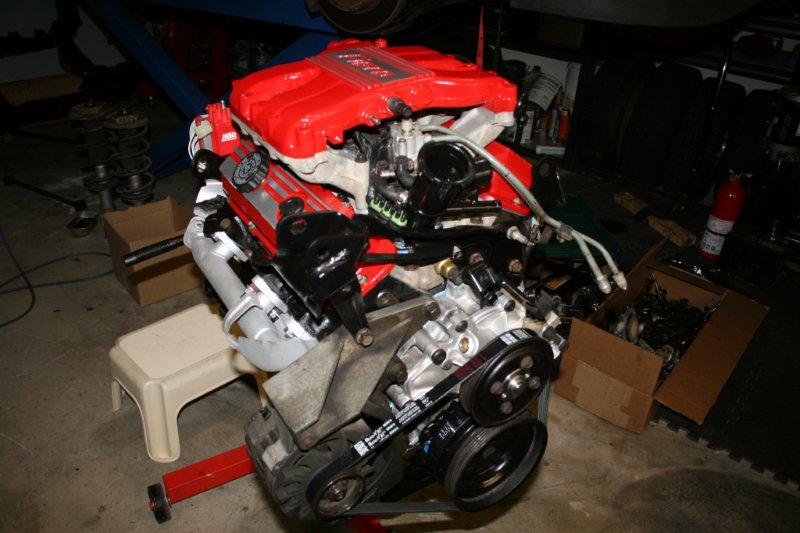

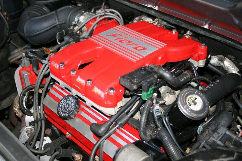

Date Posted: 22 October 2011 at 10:47pm
It's alive!
The cam break in is done. Still some things to do...
More to follow in a bit...

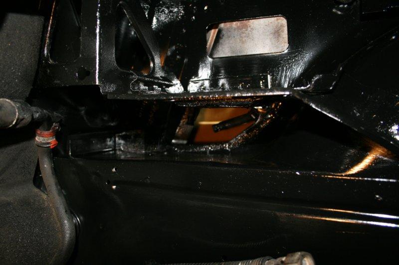

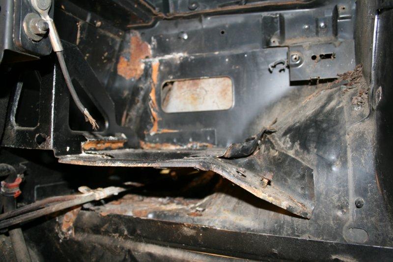

before putting in the motor we had to take a peek at the battery tray to see if there was anything going wrong there.
turns out there was some minor rust that needed some attention and an application of POR 15 paint.
after that, the insulation was put back and tubes and wires re-run.
next was putting the cradle/motor in. no pics for that but it was pretty much the same as taking it out.
here is a shot with it in.
