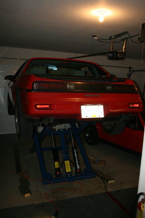

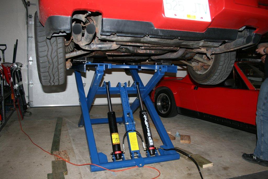

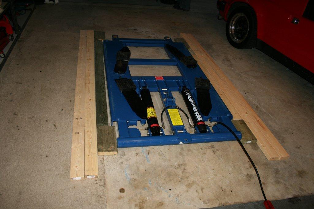

okey dokey.. here are a couple of pics.
first blush, i cant say it will make the manifold bolts easy to get at without removing the lower exh. (cat is in the way) but there is much to see while the car is up in the air...
Gary

Gary, that gizmo is incredible!  I've never seen one of those things before.
Date Posted: 05 July 2011 at 11:36pm
Awwwesooooommmme.
So what, do you just have solenoids between compressed air and the shock?
Date Posted: 06 July 2011 at 12:22am
OMG I thnk I need to go change my shorts, that is awesome.  I have never seen a hoist like that, that will fit in a garage.   Dare I ask how much it was.
Date Posted: 06 July 2011 at 7:14am
Nice...
Posted By: karnak
Date Posted: 06 July 2011 at 7:39am
This unit comes with a hydraulic pump and goes up and down
smoothly. It goes up about 4feet. It was just over $2000. My back will
like it. Yesterday we mainly just payed with i and found that as low a
profile as it is, a stock height fiero struggles to get on it. Some lumber
on the sides helps.
Gary

Siiiick. But the Fiero has trouble clearing it? How low do you have it set? Normally I can swing in two-post lift arms no problem, and they tend to be comparitively high profile...
Date Posted: 06 July 2011 at 11:38am
...as low a profile as it is, a stock height fiero struggles to get on it.
That's not exactly true, the tires I have on the car right now a shorter than stock so there's about an inch less of clearance. With stock sized tires there would probably be just enough room.
Date Posted: 06 July 2011 at 12:36pm
