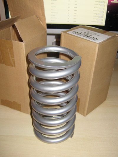

Yesterday I picked up springs (#400) from Mopac in Langley and with that a "back brace"
I'm still not sure if I'll use the old KYBs or go with the Konis, what do you think ?
Romeo, what spring rate are you choosing ?

Stock springs for now. I lack the finances (And lately, the patience) for anything beyond just shocks and bushings, which is more for safety (And convenience in the case of bushings) than performance. Switching to high performance now just allows me to install the rest of what I want later, without having to re-buy shocks.
As for the shocks, it depends on what you're looking for. If you just want comfort for a good price, stick with the KYB's. If you want performance for cheap, get the KYB's and resleeve them with a smaller orifice/valve. If you want both, it isn't cheap, but then I'd go with the Koni reds. Dial them up around 3/4 when you're autocrossing, dial them all the way back for daily-driving. You could hypothetically go with the yellows (If you have an '88 suspension set-up) but those range from stiff to stiffer, and would probably negatively impact comfort during daily driving.

I only have two options with shocks, use the existing KYBEES ( painted red ) or spend more $$ for the KONI reds.
The only reason going with the stiffer springs(400 from 300) so it won't bottom out, the 3800SC swap
made the rear heavier and I don't want the fenders hitting the wheels, that should help ?

Honestly Johnny Boy? I'd just stick with the KYB's you have now, exactly the way they are now. That's just my opinion though.
