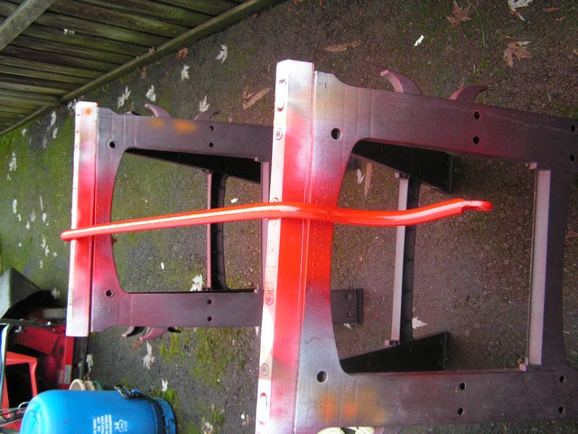

cleaned and got painted just need to get the end links and mounting bushing.just not shure on what size endlinks i need.

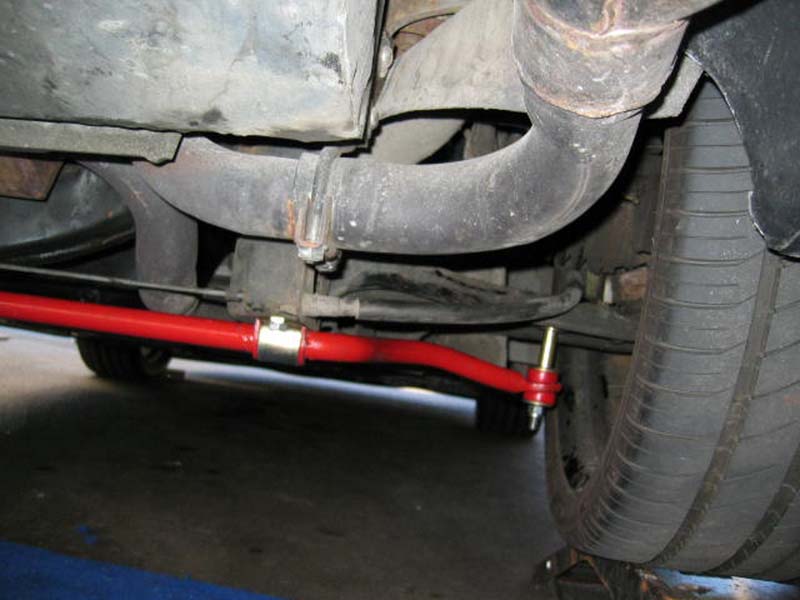

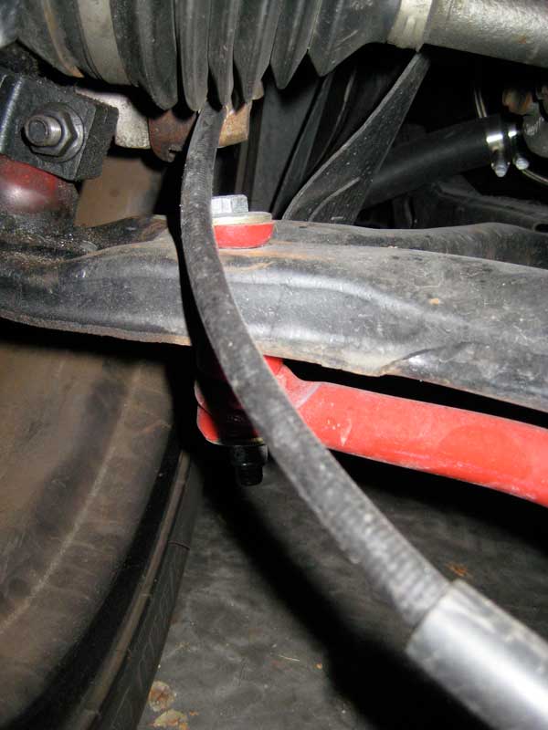

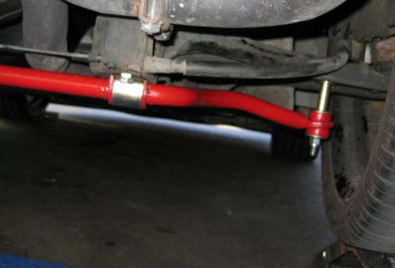

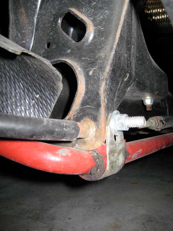

This is how Blair did mine...
Bolt length 4-1/4"
Notice the top poly was cut in half only !
EDIT: Top ploy cut in half only and the rest are stock !

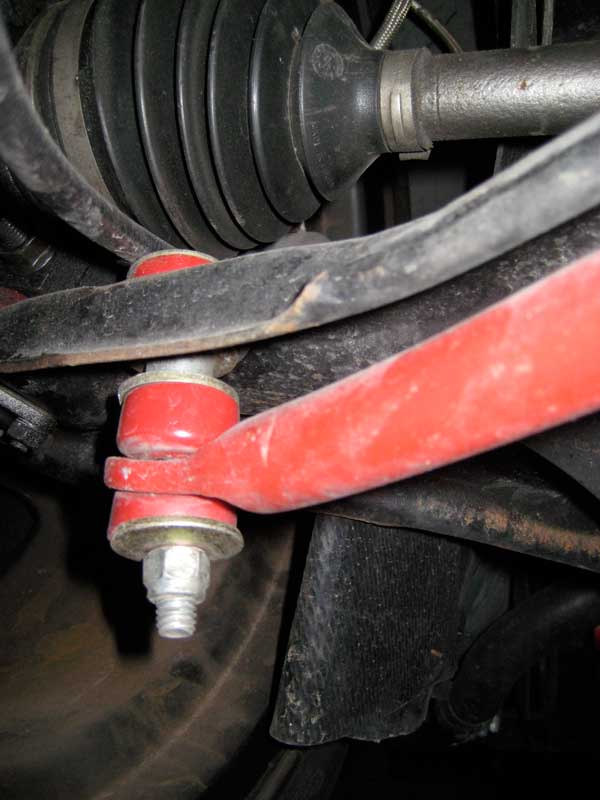

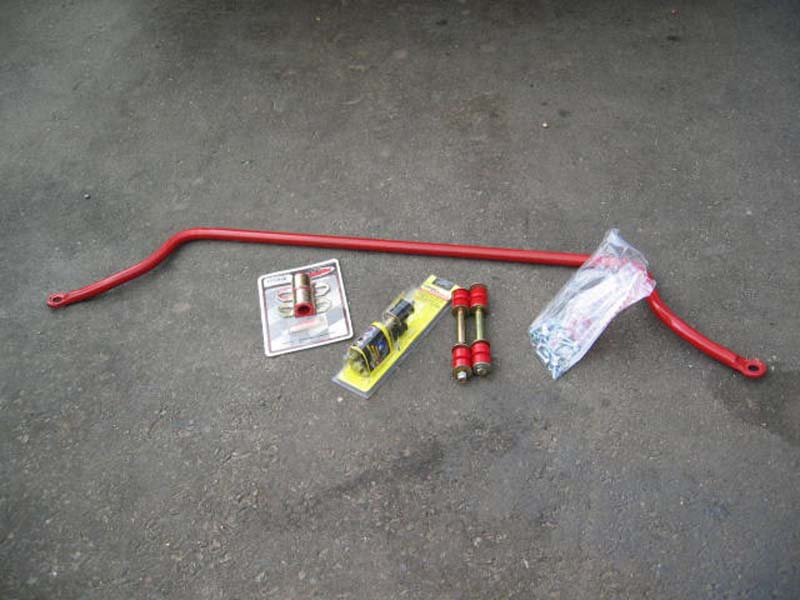

This is what you need...
This is the old set up, notice the bolts are longer, now there shorter

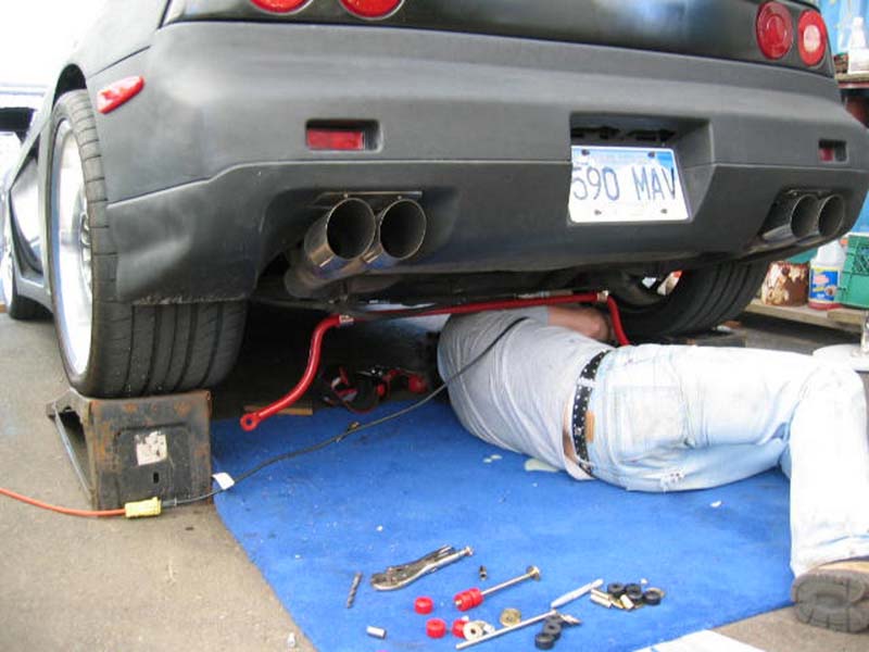

Clynt installing the first set up...

Thanks Car-2-Lo thats what i need to know that i need to us 4 1/4" bolt.i'm going to get all the parts and give it a go.

One more thing, two ways of install...
The first install by Clynt, clips mounted flat on frame
the last install by Blair, notice clip bent straight up and mounted at end of frame with lag bolt at very top end
