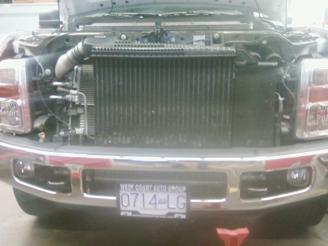

Found an intercooler for you. It actually goes a little past the bottom of that chrome bumper. It's larger in every dimension than the Fiero's entire radiator.

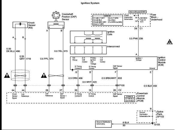

Ok, well here's a wiring diagram:
Did you have the starter out?  Might have whacked the crank position sensor.  If you have a scope, you could back probe at the ECM, and see what the signal from the CPS is.
Check for power and ground at A & E on the ICM.  Make sure the block is still well grounded (maybe a strap got removed during the last fix?).
That's a start anyhow - LMK what you find.
(where are you anyhow? I have a handheld scope meter)

I did all the recommended fixes as per the Doctors preliminary orders and the car is still a no fire. Spins the engine much faster than before but still a no start with ether.
 Good constant Power to the ICM but I am thinking there is no spark reaching the plugs and possibly no injector pulse.
Will replace the Crank sensor as it is cheap and can rule it out.

See if the signal is reaching the ECM before you just toss one in. If it
does turn out to be a connector or wiring issue, you'll be chasing your
tail in circles.

Good news, I pulled the connector/wires off the CKP and removed the black tape covering the splice. One of the wires had come off inside. Resoldered it and the car now fires. It runs for a couple seconds then it dies. on the right track..............
88 GT Northstar 6 Spd
Date Posted: 13 April 2011 at 2:03pm
Hm. Do you happen to know if there's any codes? That could help point you in the right direction for chasing down the remaining fault(s).
Check that passkey bypass module.
That sounds like the security system kicking in.
Posted By: Medic
Date Posted: 13 April 2011 at 5:34pm
That was the first thing that came to mind. The are part of the BCM and apparently pretty troublesome and give a lot of grief. There are a couple bypass options out there.
Not sure how it works in conjunction with the fireo ignition though. I do get a "chime" when I put the key in, it speeds up after a few seconds.
There is a process to reset it but I haven't had much luck with that so far.

You know, I've read about all sorts of trouble people have had with trying to retrofit stock ECM's to their new car bodies.
If I ever go beyond a 3.4L and need to change out the stock ECM I'm going to take a good long look at MegaSquirt.  Seems to me that you would have the most flexability.
Sounds like you're getting close anyway.

It's Alive!
The BCM must have reset itself.
