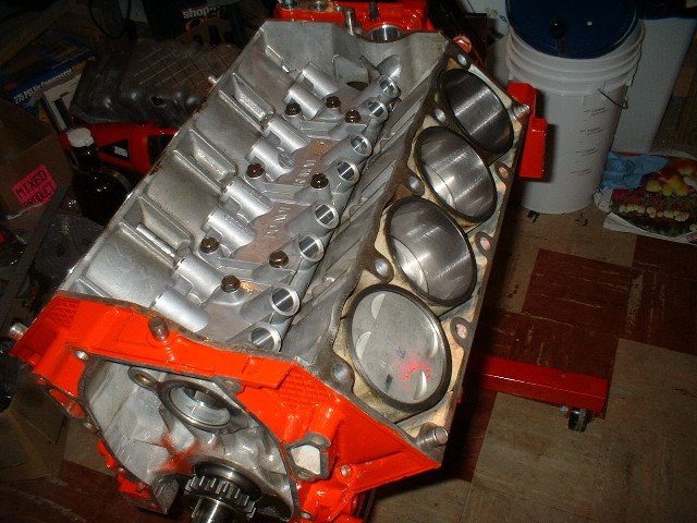

Date Posted: 02 November 2010 at 10:44am
Have you 100% determined that there's REALLY a problem?  This thing still has not been run for any length of time (like, a few hundred miles of real world driving)!
You WILL hate yourself if you take this apart from everything I've read & heard.
It's not a conventional engine.  They use a wet sleeve, instead of a normal block.  Picture a rectangular box, and 4 tubes sitting in the box.  Then the lid (head) gets bolted down to the box.  You just happen to have two boxes at a 90* angle, and 8 tubes.
If you've ever seen a commercial diesel engine taken apart, that's what they look like (sort of).
edit: Oh yeah, and the bolt holes might end up all needing heli-coils.  That's why they don't want to touch it.  Labour costs could be astronomical.
edit edit: Found a good picture.
See the cylinder liners?  Those 'pop out' (so to speak).  They're removable anyhow.
Date Posted: 02 November 2010 at 10:53am
Always preferred wet-sleeve, personally... Keep that coolant actually on my sleeves.
Date Posted: 02 November 2010 at 10:56am
Don't get me wrong - not saying there's anything wrong with them (or they wouldn't use them on zillion dollar "gotta run" commercial engines!).
They're just not 'normal' for the average joe to rebuild, and can cause headaches if you don't know what to look for.  If you're a certified HD mechanic (which I'm not!) it's all in a days work (literally!).
