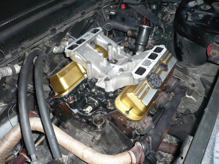

OK.....It's head gasket time.  Here we go.
This is our baby with her top off.....:)
While I'm at it, may as well spiffy things up a bit.  I'm trying to stick with our Gold on Black theme.  Here's the before.
And the after.  I like it.
I'm going to do the Upper Plenum in the same color scheme after I give it and the Throttle Body the big bore treatment.
Should look grand....eh?

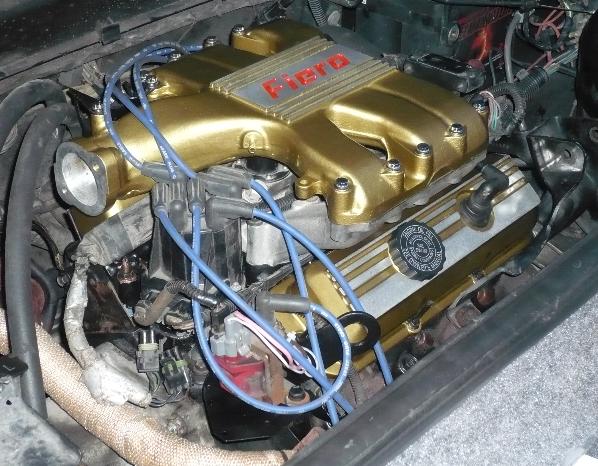

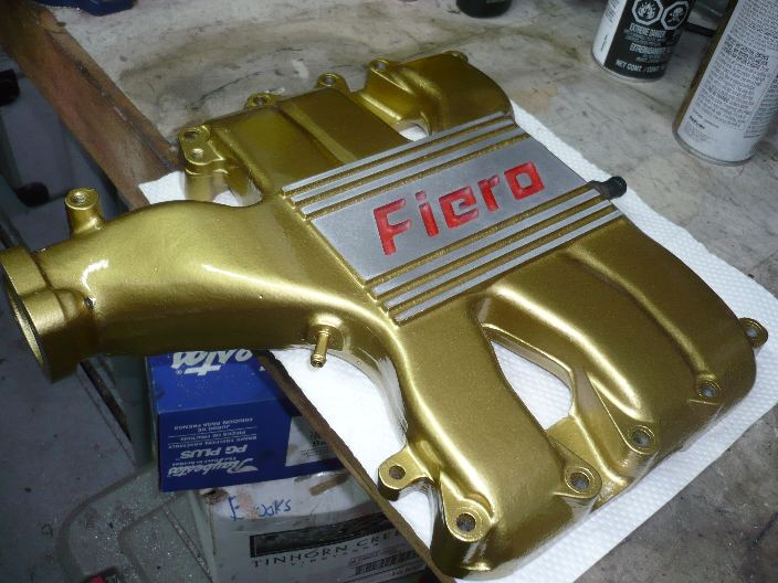

Didn't get the valve covers on today as hoped.  But decided to make the upper plenum pretty instead.
Man, there's a lot of nooks and crannies on this darn part.  All the cleaning and prep work and multiple coats of paint.  It took way too long......Oh well, it turned out great!
I did the big bore treatment too so I guess that's not too bad then.
It's going to look pretty fancy once it's all assembled.

More progress.
Adjusted the rockers (Couldn't find the info you suggested John).
Installed valve covers and lower plenum.
It's starting to look like something again.

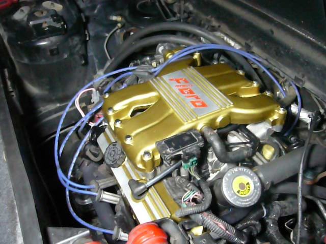

Almost done now!  Just a few bits here and there and it's time to start it up.  If I had had the chance to work on it all day it would be running.  But we need to go to a birthday party so tomorrow will have to do.
The biggest thing left to do is finish the big bore throttle body.  Lots of hand fitting the butterfly valve left to do.

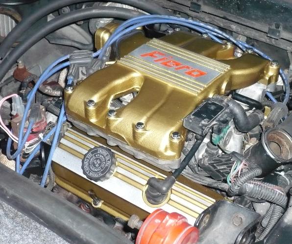

Now the big red dog bone will stand out like a sore thumb.  Sheesh sounds like something Tristan would say.
Date Posted: 15 October 2010 at 7:05pm
Now the big red dog bone and coil will stand out like sore thumbs.
Fixed that for you.
Date Posted: 15 October 2010 at 7:07pm
Just my opinion (for whatever that's worth!) - fill in the "FIERO" with gloss black enamel.
Date Posted: 15 October 2010 at 7:15pm
Now the big red dog bone and the coil and the word "Fiero" will all stand out like sore thumbs.
Fixed that some more for you.
Sorry Damien, we're a bad bunch.
Date Posted: 15 October 2010 at 7:23pm
Na keep the red and add some nice red wires.  IMHO its the blue wires that are the odd duck in the stack.

Good news my homies!  She started up just fine with no issues.  I don't have a timing light so I set things up by ear for now.  It certainly sounds different that's for sure.  I punched the throttle and with no air cleaner it whoops good.
Here's totally finished just about to start.
I made a short video but it's way too big to upload.  I'll try and figure something out.
Happy Days!
