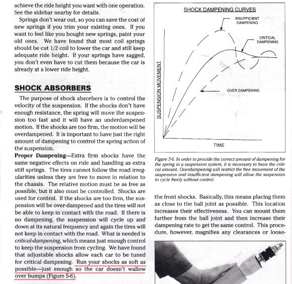

Date Posted: 19 September 2010 at 12:08pm
From what every site I've read says, the fronts can be adjusted outside of the vehicle, but that doesn't much help me. The rears are still externally adjustable, meaning that you can reach in the tire well and stiffen/softer bounce jounce and rebound settings without taking anything out. The Koni yellows, which are both stiffer and adjustable at all four corners, are worth about half of what I paid for the car. The reds are a little softer (But still plenty stiff), but can only be adjusted (Normally) on the rear, and still arn't what you'd call "cheap". Also, the fronts are usually $110-130 per shock, and the backs about $200-240 each (For the reds).
Date Posted: 19 September 2010 at 1:11pm

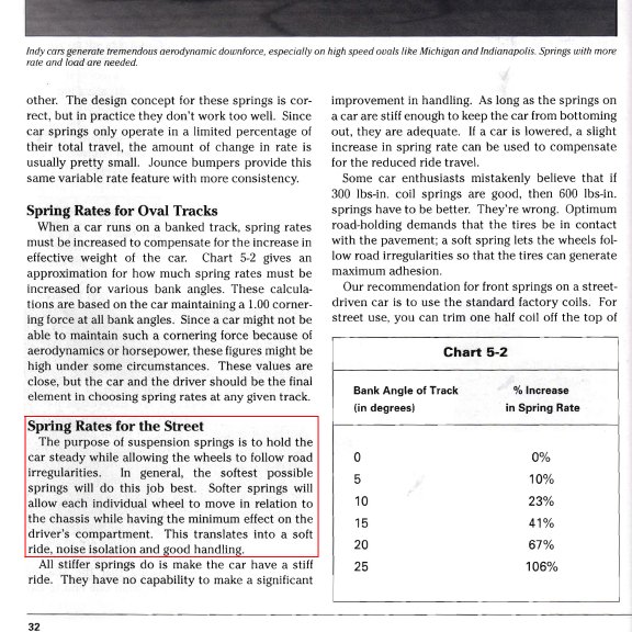

OK... but you seem to be forgetting something. In general, for maximum cornering traction, you want the least amount of vertical force/weight at each wheel. Of course other factors come in like body roll and alignment.
If this doesn't make sense to you, consider what happens when you add a large rear anti sway bar to a stock Fiero. A stock Fiero understeers a lot (ie. the front wheels lose traction). Adding a large rear sway bar, in addition to taking away body roll, effectively increases the amount of downward force on the rear wheels and results in a car that will more readily oversteer. Since it hasn't really given the front wheels any more traction while corning, it must have taken away traction from the rear of the car. So with this in mind, you can just take the front shocks and set them to the softest setting then just tune the rear struts for balanced handling.
Edit: Now that I think about it, using the sway bar as the example probably wasn't the best choice since the fact that it increases the weight at the wheels isn't so obvious. But it seems like you already get that to make an understeering car more neutral you want to stiffen the rear. I'm just suggesting you consider why that is and why a totally stiff suspension isn't necessarily ideal if you want to maximize cornering traction (for example, instead of stiffening the rear to eliminate understeer, make the front softer).
Date Posted: 20 September 2010 at 9:30am
Bare in mind that friction is dominated by normal force, which itself is generated by how much the car is "pushing" on a tire. While it's true over-stiffening can aversely affect a car's handling, a softer suspension is bad in three ways:
Driver confidence will naturally go down as body lean is increased. This unto itself is probably a soft shocks single greatest sin.
The second reason is transverse balance. In a car that's leaning, there's too much weight to handle on the outside tire, and not enough weight to get friction on the inside tire.
Third reason being momentum. As the car leans over, it wants to continue moving to the outside. Off-setting this is key to cornering quicker.
Remember, the fastest cornering vehicles on the planet - Formula One vehicles - Are also one of the stiffest, with a suspension capable of deflecting only 1/2" at 5 g's.

Found in the book Chassis Engineering by Herb Adams (interesting parts highlighted in red):
and
In other words, make your suspension as soft as you're able to, given the conditions. Then if you need to, add anti-sway bars to limit roll.
