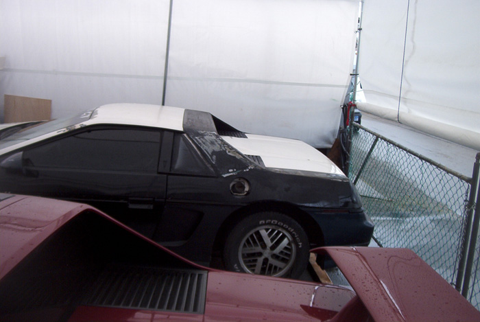

Looks like someone will be the first in WCF Club to have a choptop?
I really like those ausie scoops.
Date Posted: 26 May 2007 at 11:35pm
I have heard many a rumor of this car, nice to finally see some pics of it.  I wonder which engine is going to go into this car.  I know the builder of the car does some really clean engine installs.

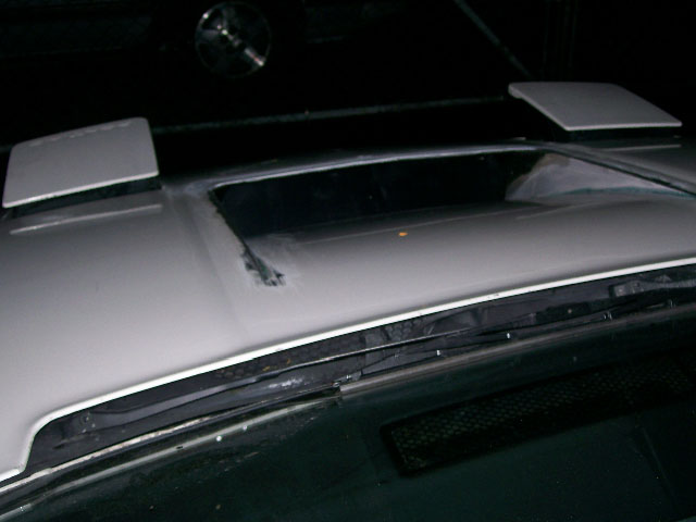

Latest update: Clynt picked up a hardtop roof, (gone is sun roof), the lines
flow better this way. He also picked white trunk lid and fenders/looks
like choptop might be turning white on Clynt.
That's looking really sharp!

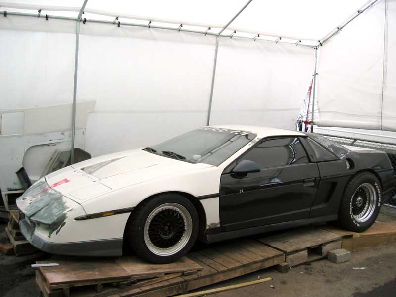

Date Posted: 06 July 2007 at 9:48pm
Just a few updates...
Clynt has the chop top running now!
Clynt's bubble top and chop top...

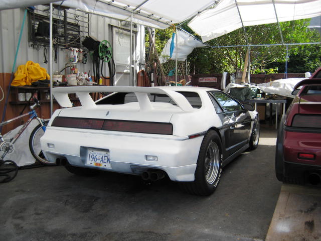

Clynt was over at my place picking up a few things for the car this weekend.  I do have some pics of the car from the last time he drove it out to the club meeting.  I will see if I can find them and post them up.

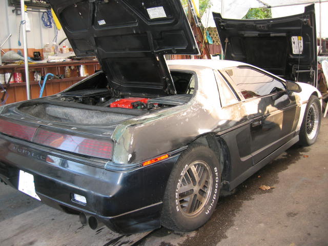

Date Posted: 18 August 2007 at 8:55pm

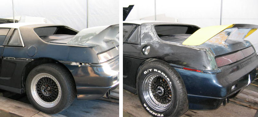

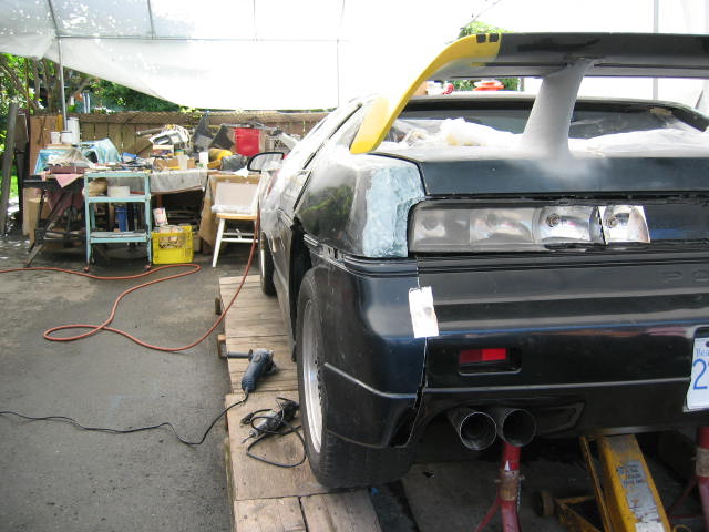

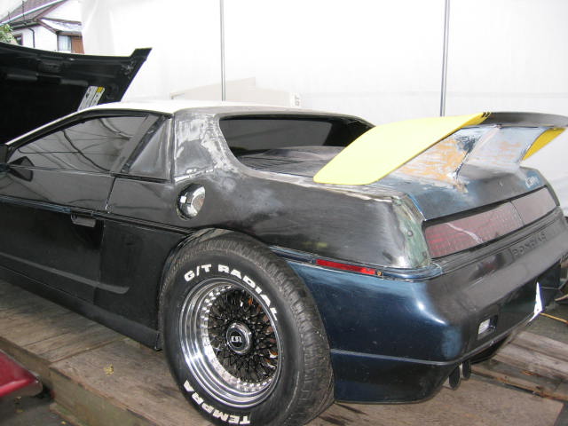

Clynt has gone over to the WIDE SIDE...
Yes, he's doing a wide body adding extensions from rear clip and
widening rear bumper (parts from Capt Fiero)
Rear wheels will be: 10"(wide) X 16" with 295 tires

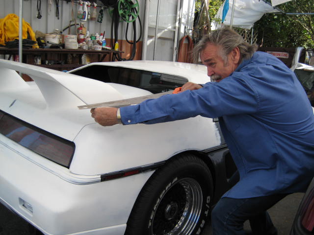

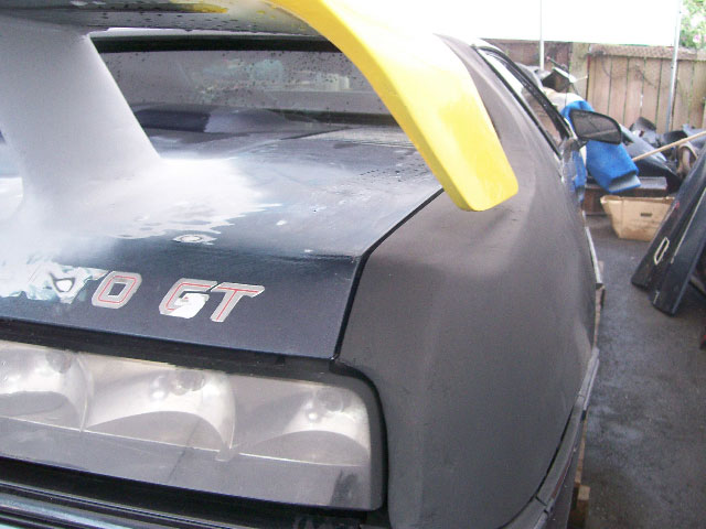

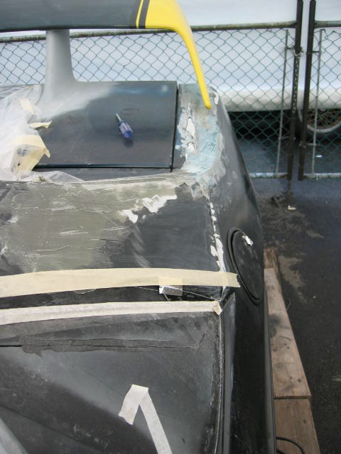

Sunday's update...
Rear clip panels are roughed in now and rear bumper is being widened.
Date Posted: 27 August 2007 at 1:56pm
Our man Clynt...
Has been having to much fun again, the roughing in is now smoothed out!
The wide body is looking very nice and slick Clynt!

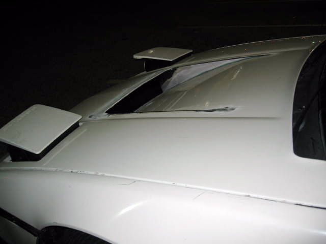

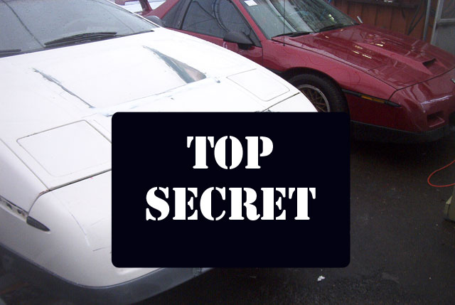

Here's the scoop...
I only sneaked one spy shot (saw Clynt's dogs coming) !

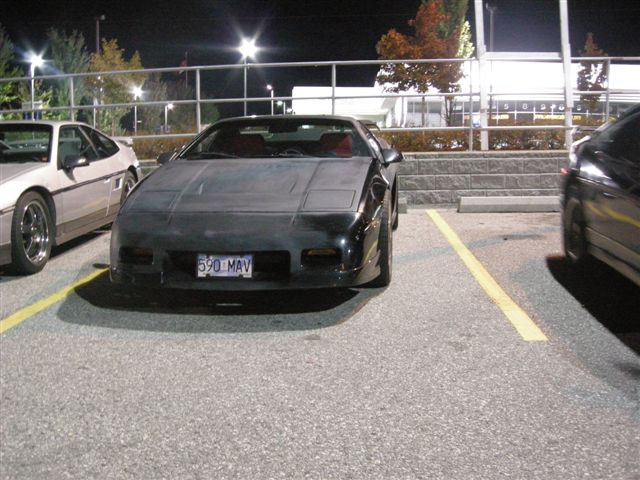

Date Posted: 21 October 2007 at 7:12pm

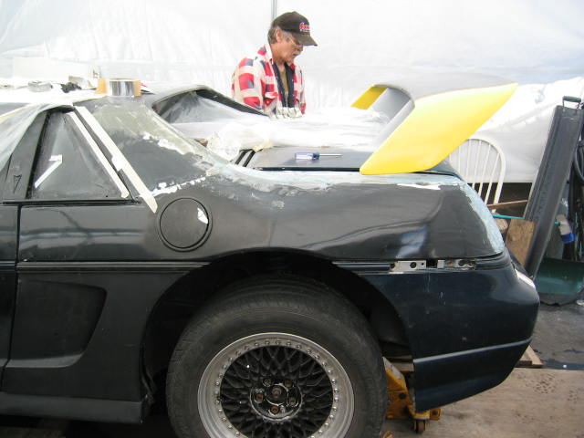

Last Saturday's club meeting Clynt's chopper was there and members were
taking pics of it, so guys post pics of Clynt's CHOPPER!

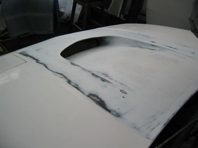

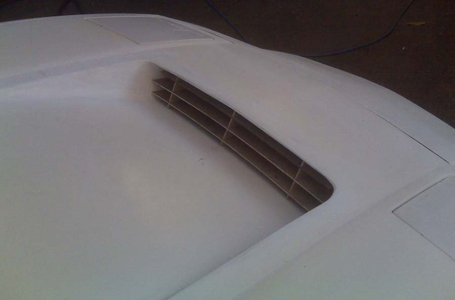

Date Posted: 07 November 2007 at 10:24pm
Clynt's latest redesigned hood scoop (just roughed in)!
It's looking so cool..... (I'll be stealing his design).
Posted By: Blair
Date Posted: 08 November 2007 at 5:53am
Looking pretty good, I'm a little jealous.

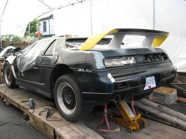

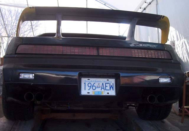

Date Posted: 18 November 2007 at 7:53pm

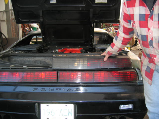

I SPY...
Made friends with Clynt's dogs.
Clynt holding stock tail light above tweaked tail lights,
the whole tail light panel is illuminated "red" right across now...
(back end looks wider with illuminated red band from end to end).
Recessed red reflectors on bumper are replaced with backup lights.
Date Posted: 19 November 2007 at 12:35am
Dang that is looking good.
Posted By: Borteep
Date Posted: 20 November 2007 at 1:15am
those taillights look great!
Date Posted: 26 November 2007 at 9:58am
I want to see the lights up close, might be something I would consider for my Cadero.

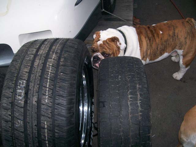

Date Posted: 09 December 2007 at 7:06pm

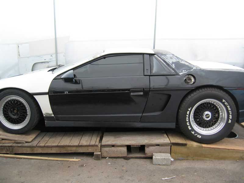

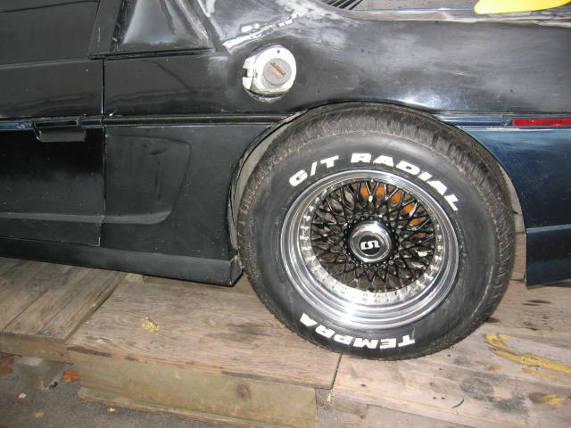

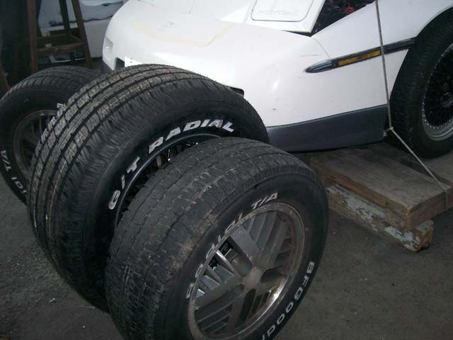

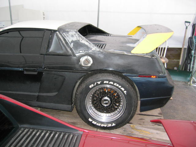

Clynt had the rear 8" mags widen to 10" (deep dished)
from Kodiak Motorsports Inc.
Comparison between stock and new 295/50/16 tires
Fills in the wheel well very nice, hot roddish looking.
Clynt, your ride is starting to look..... super cool !

Date Posted: 09 December 2007 at 10:54pm
My god that is huge.
I have had 26.5" tall tires on my 85GT and those are a full inch taller.
I hope you have a good trans to put in front of those massive tires, as with any spirited driving, it is going to tear things apart.
Congrats on getting something custom made up and fitted on the car.
For those that are interested, take a pop over to http://www.dakota-truck.net/TIRECALC/ - http://www.dakota-truck.net/TIRECALC/  and play around.
The stock Fiero rear tire size is 215/60/14 or 215/60/15 for GT's.  I have fit 225/60/16 on the rear of a Fiero that has been dropped 2 inches.

Date Posted: 11 December 2007 at 11:09am
Interesting comparison...
BEFORE 8"/ AFTER 10" wide custom rear wheels ( deep dish look great!)

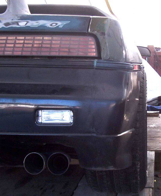

Date Posted: 12 December 2007 at 8:42am
There you go Marcel, Clynt has just taken these pics...
It's really looking nice and wide.
Posted By: marcelvdgn
Date Posted: 12 December 2007 at 11:43pm
mailto:WOW!?@##$ - WOW!?@##$ @!?????????????????
Love it..........Now what are goin to do for the front???

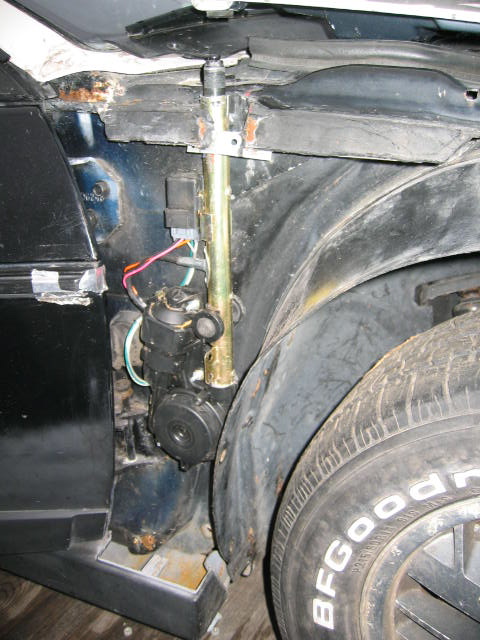

08' SPY SHOTS...

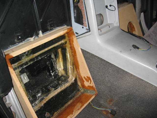

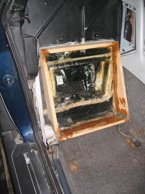

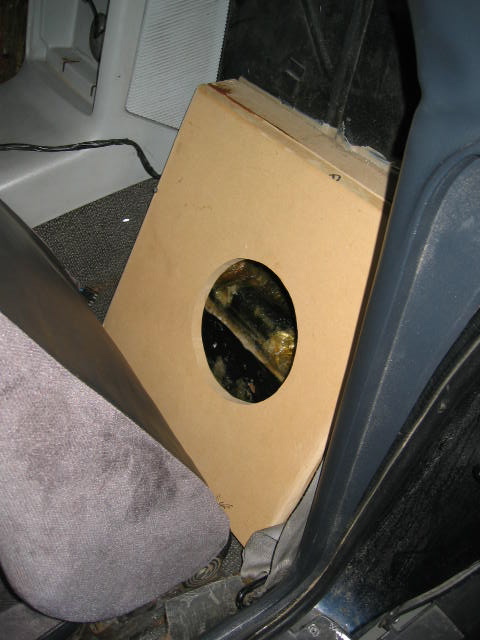

Clynt is playing again!

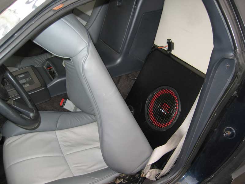

Sub boxes fibreglassed into firewall
Caddy power antenna (no need for antenna topper).
Date Posted: 08 January 2008 at 10:56am
Ooh Clynt got bit by the boom bug.     Now with Clynts wild imagination for building things.  I forsee this being an interesting mod.

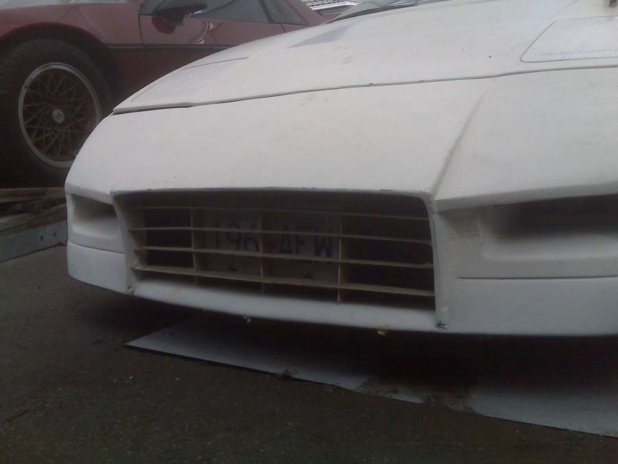

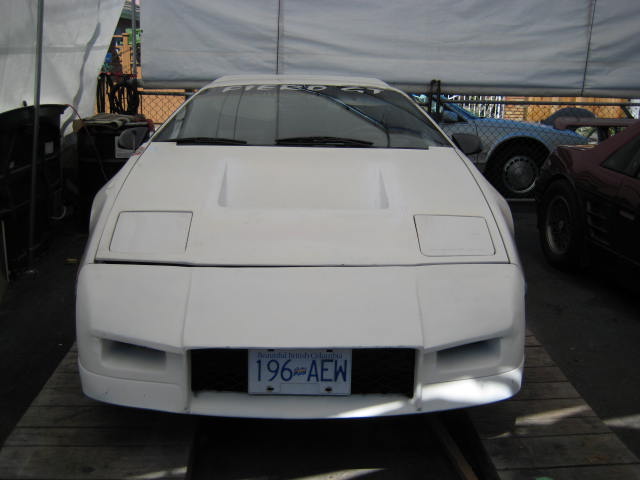

Date Posted: 17 January 2008 at 12:55pm

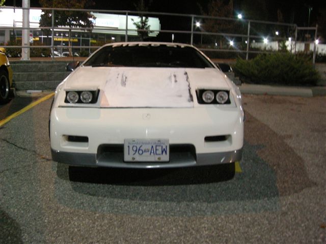

Another view of Clynt's custom front fascia
Posted By: exoticse
Date Posted: 28 January 2008 at 8:58am
OK, time for another spy trip ! :)

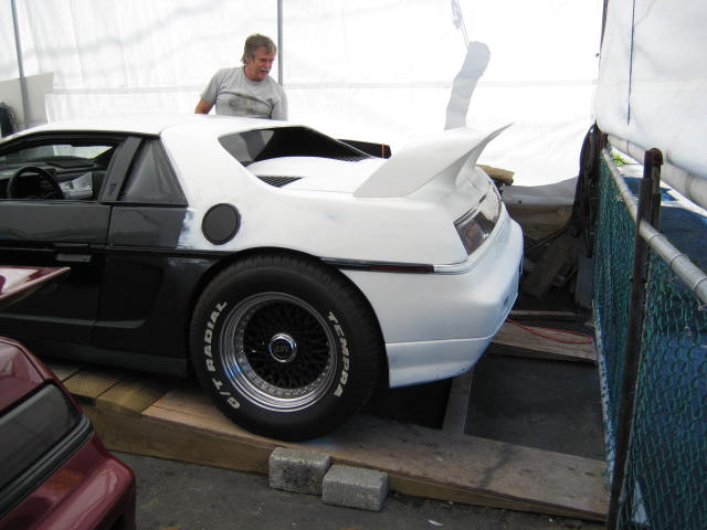

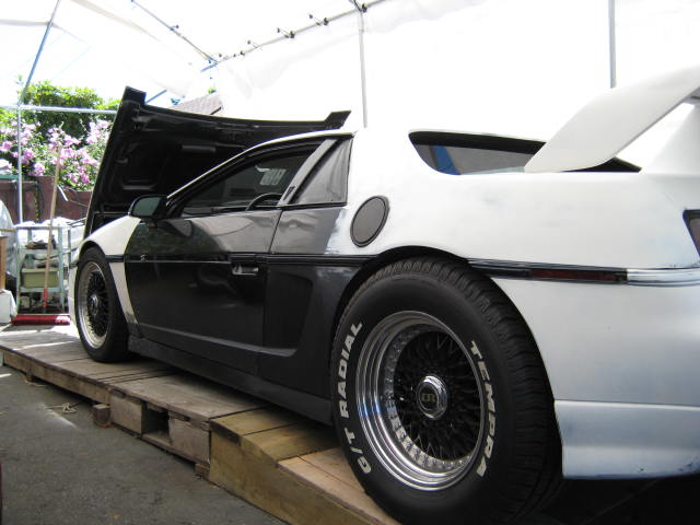

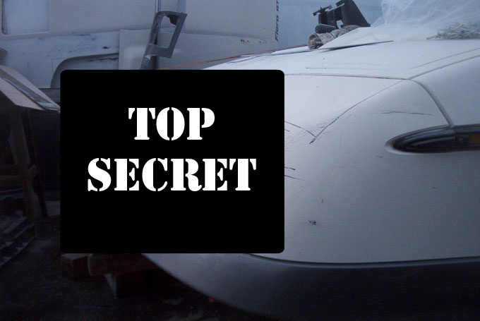

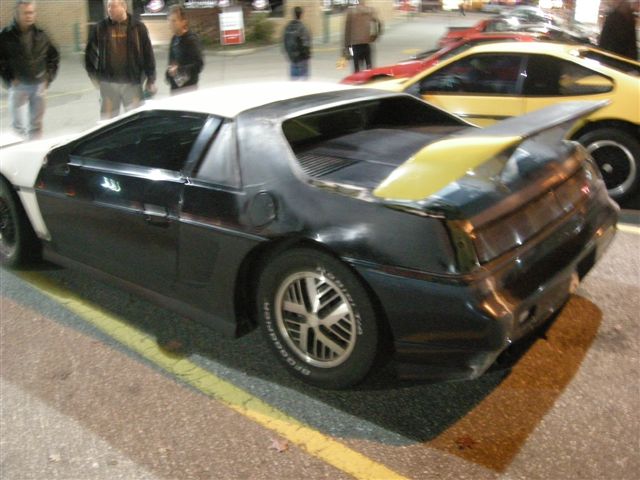

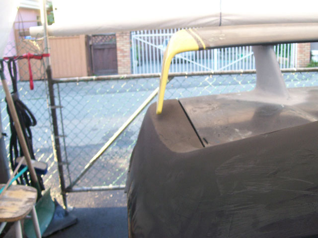

Date Posted: 13 February 2008 at 8:45am

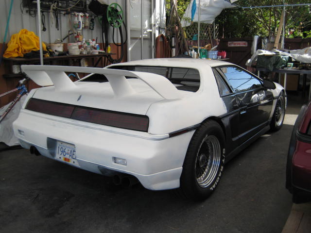

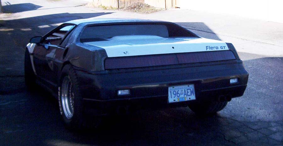

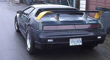

Latest spy shot...wingless (I don't know, but it sure looks nice) ?
Note: Front custom fascia is still CLASSIFIED !
Posted By: Blair
Date Posted: 13 February 2008 at 4:49pm
WELCOME TO THE WINGLESS SIDE
Look great!
Date Posted: 18 February 2008 at 12:54am
After going with a wing for years and then without a wing for a fair bit of time.  I am going to put the wing back on the car and maybe even thinking about adding a roof wing.   I started playing with it today and really think it might be and be functional.  (just a small thing about 1" high
Posted By: Borteep
Date Posted: 22 February 2008 at 8:14pm
I betcha some of those shark-fin things along the top of the rear window would up your top speed or highway fuel mileage a wee bit :D
Personally I can't give up on the amazingly excellent rear vision a wingless Fiero has. Then again, I don't run into any traction issues with the stock V6 either.
But if you have more power... a Fiero GT (with the headlights down) has a better CD than the Veyron, so I figure it can spare a bit for the sake of downforce. You'll still need a very big engine to hit 400 km/h, though.
Posted By: exoticse

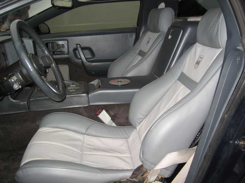

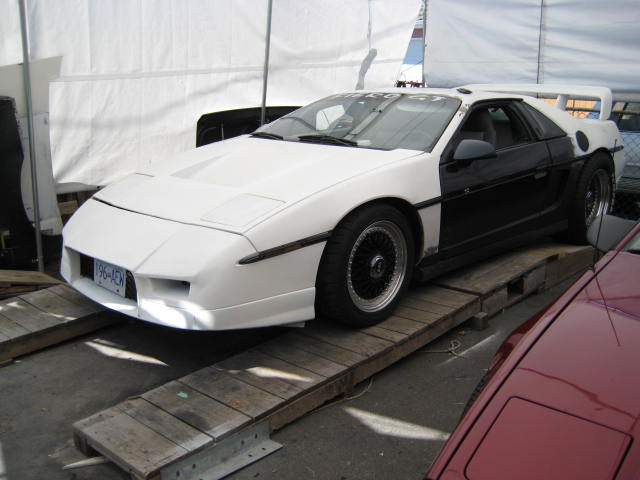

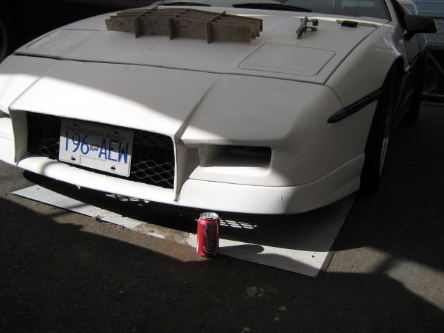

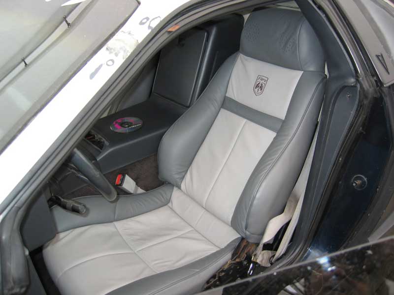

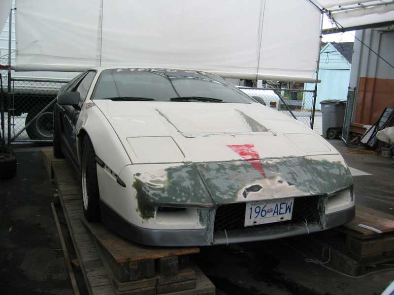

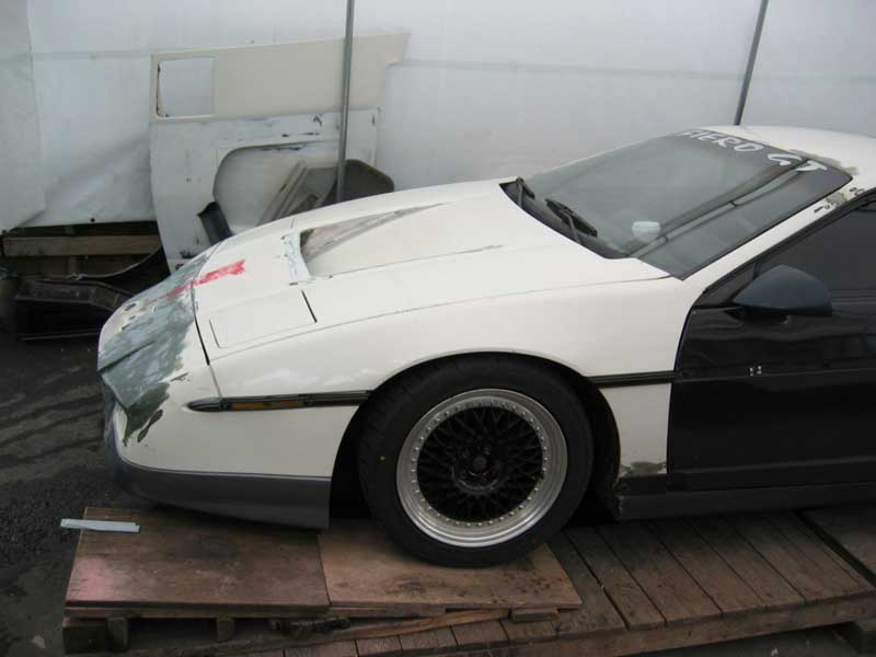

Date Posted: 23 March 2008 at 6:05pm
Update: Today I dropped off parts (from Marcel) to Clynt's shop and shot some pics...
Front fascia roughed in and Clynt is still tweaking it.
Mr. Mike's seats
Subs behind seats and it sounds great (better than Car-2-Lo's)
Date Posted: 23 March 2008 at 6:12pm
Oh my God, that nose is dead sexy. Anyone else think it looks Ferrari'esk. I want a step by step on how he did that. Those seats are really nice too. Are they Mr. Mikes?
Date Posted: 23 March 2008 at 6:51pm
Guessing from where he said:
Mr. Mike's seats
Yes...  yes they are....   ;)

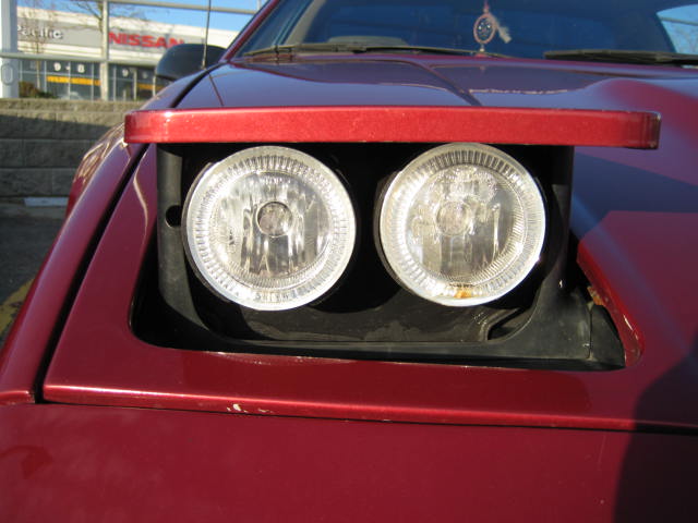

Date Posted: 10 April 2008 at 8:46pm

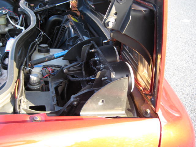

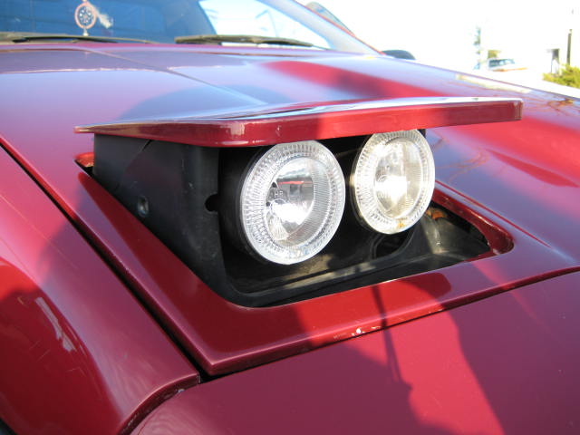

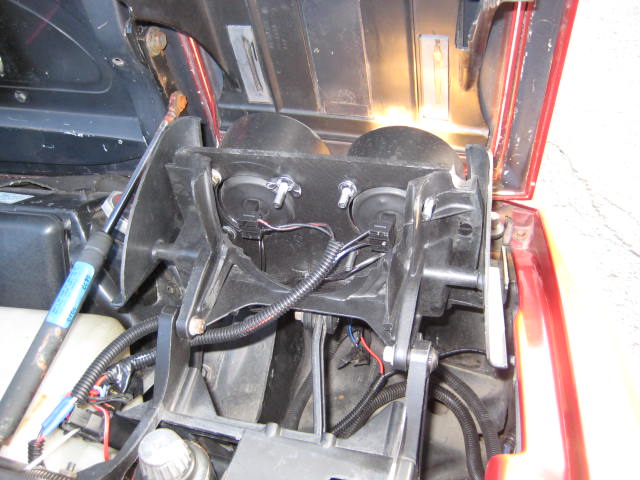

I Really like these headlights... Where can I get some??? Or what parts are needed to make them??? Are they bright enough??
Posted By: Borteep
Date Posted: 11 April 2008 at 2:57pm
Those are definitely bright enough! Depending on whether they're the HID units or not, they're either the brightest or second brightest lights (with the best pattern either way) that you can get on a Fiero. All you need is the four lights, plug adapters and a new headlight bucket. There's a dude in (I think) Germany that makes them. You can find his thread on Fiero.nl.

Very sweet looking car. I was curious to what brand the wheels
are.  Sort of look like BBS RS wheels but the center caps say otherwise. Thanks!
Those are my old "CSI WHEELS" back in '88 we wanted stock looking mags (with mesh).
Front 16"X7" rear 16X8" ( +35 offset)
Clynt has brought new life to them rear 16"X10"
Their not around anymore, I think Smurf (WCF club member) works for a wheel company
should know who manufactured the CSI WHEELS ?
That was a bit of history, any new info on these wheels, let us know.

well there;check out fieroking as its his idea,but i only used lites and wiring non of the abs parts .mounted lites in flat plexie and trimmed housing to fit stock bucket.total cost was the price of the lites,,as far as brightness there fine for me,i wanted the look more than the effect!!
http://cgi.ebay.com/ebaymotors/93-97-MAZDA-RX7-RX-7-DUAL-HAL O-
HEADLIGHTS-LAMP-94-95-96_W0QQitemZ380016174913QQcmdZViewItem
as for the wheels,i think they are bbs but branded under another name. now that they have been widened the offset is different but the back space is the same.

Date Posted: 12 April 2008 at 11:14pm

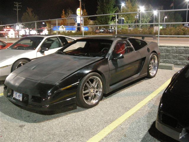

We shot some pics of Clynt's ( bubble top) lights at tonights meeting.
Posted By: exoticse

Date Posted: 04 August 2008 at 5:35pm
Clynt's Panda Chopper...
Okay, just joking, it won't stay this way!
So finally went to visit Clynt's shop, he is still having fun tweaking here and there...
The wing went back on (he has two deck lids, one with wing and one without, so he can switch over anytime).
I like it better without or trim wing ends a bit (but, that's my taste only) What do you guys think?
Next, he's going to do something with the rear bumper and tweak it.
Date Posted: 04 August 2008 at 6:12pm
The nose is amazing.  I am sorry that when Clynt stopped by Lisa and I were racing out the door so we did not have time to chat.   Clynt if you are reading this, I am totally jealous, it looks awesome.  P.S. I tried to call you the morning after we saw you in Surrey, and it turns out I no longer have your number.   Drop me a line on my cell 604-807-2623 and let me know how things went.
Posted By: exoticse
Date Posted: 04 August 2008 at 9:40pm
Great job on the nose !
I agree with you Car-2-lo, IMO the wing tips are DEFINATLY toooo long and need some trimming, but otherwise the car looks great !
P.S. i might also lower the wing an inch or two.  :)
Posted By: 85SEnochie

Date Posted: 01 September 2008 at 5:11pm
Originally posted by exoticse exoticse wrote:
Great job on the nose !I agree with you Car-2-lo, IMO the wing tips are DEFINATLY toooo long and
need some trimming, but otherwise the car looks great !P.S. i might also lower the wing an inch or
two.  :)
This much off ?
Okay, we are just joking, Clynt likes it as is, (it does look very cool and mean).
Date Posted: 01 September 2008 at 5:21pm
This afternoon's pics...
Madcurl's show Coke can
Posted By: Roadfury
Date Posted: 02 September 2008 at 7:33am
i spy a red widebody in progress?
Date Posted: 02 September 2008 at 8:51am
Is the grill on the hood in the last pic going on soon?
Date Posted: 05 September 2008 at 5:40pm
I don't think he's doing that ( ? )
That's Clynt's red daily driver (4.5 caddy) 10" rear wheels, he had to use plastic flares to cover the rear wheels.
Nigel did the same to his wide track ride.
Date Posted: 17 September 2008 at 9:22pm
The grills are just a mock up for now, Clynt plans to do that. What do you think?
This rear pic is a couple months old, thought I would show it anyway for 85SEnochie.

   I like I like!.......The mock up for the grills looks both elegant and mean color will be black right or gun metal black would be sweeter.

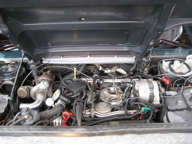

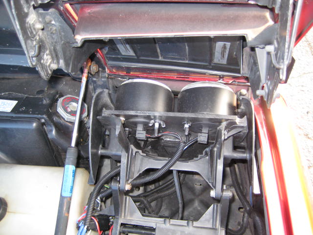

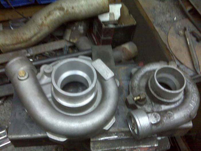

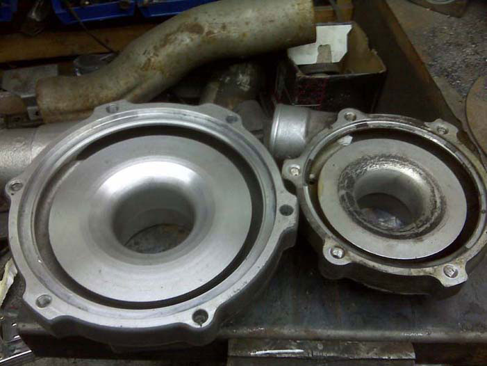

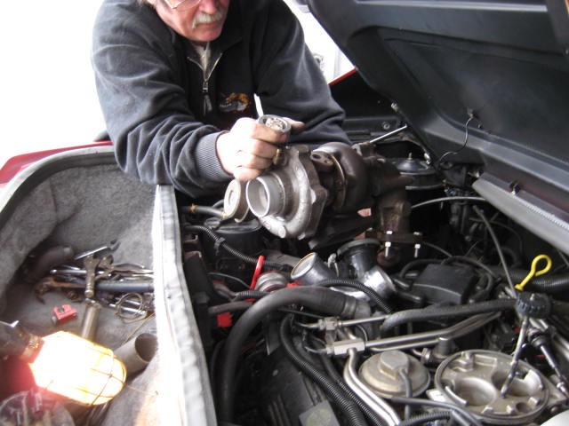

This afternoon I went to visit "our man Clynt" and look what's he's playing with...
a TURBO, he's installing the turbo to his V8 Caddy, WOW !!!!!
Posted By: kawana
Date Posted: 19 October 2008 at 5:47pm
wow, thats one cluttered engine bay lol :P Looks like it will be a fun ride :D
Date Posted: 01 November 2008 at 9:47am
Yeah, very cluttered now, he had to relocate and make room for the turbo and now even a larger
turbo as you can see left side of pics, this is for Clynt's red bubble top.
Latest news for the panda chopper, Clynt is installing a 4.9 Caddy 4 speed automatic !!!!!

This car goes beyond amazing. And does anyone happen to know how he protected the subs and enclosures from being damaged, as they're partially in the engine bay. And now I feel like my subwoofer enclosures arn't so original... Sigh...

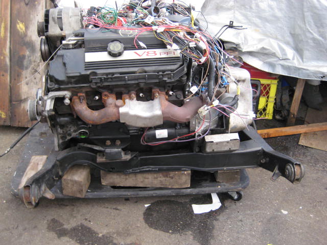

Date Posted: 24 November 2008 at 1:29pm

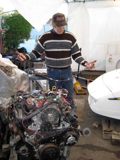

No lottery win here, Clynt also nickeled and dimed it...choptop, wide body and V8!!!!!
He only paid $500 '91 Caddy (for the whole car) !
V8 Caddy on cradle now, this is going into the chopper.
It may look messy NOW, but all wires are labeled and Clynt is making harness.
Clynt does super CLEAN INSTALLS.
Added note: okay, I saw wires tagged with #s
Date Posted: 24 November 2008 at 1:41pm
Next time you see Clynt, give him a poke and ask him if he has forgotten to swap anything.  In those pics, he has not moved the valve cover yet.   Just jokingly ask him how he will put oil in the car with the oil cap being on the firewall side rather than the trunk side.
    Really glad to see another 4.9 hitting the streets.  Now if I could just get enough time to put mine back on the road.  Oh how I miss the sound and torque of that car.  Then I have to decide if I am going to install the fastback clip on it.
Date Posted: 24 November 2008 at 2:06pm
That's to funny, let's not say anything to Clynt !
Date Posted: 24 November 2008 at 2:30pm
Are my eyes deceiving me, or is there an oil cap on the other valve cover as well?
Date Posted: 24 November 2008 at 3:18pm
Ya know what Patrick, you might be right on that, so he has either swapped it from the time the first and 2nd pic were taken, or he installed 2 Valve covers both with oil fill caps.
Date Posted: 24 November 2008 at 3:32pm
Hey Capt, I guess the jokes on us ! Pics where taking at same time.
Posted By: clynt
Date Posted: 24 November 2008 at 6:40pm
hi guys;
  just a quick comment .two front covers yes .picked it up when i got the exhaust manifolds (wanted cross over instead of cross under).
i need the room under the hinge where the cutout is for the ps pump
just fits better. and the wiring no its not all labled still a lot to figure out.
no rush on this project though ,body still need lots of time/money.
 time i got!!
will also need a 4 cyl throttle cable anybody got spare???
