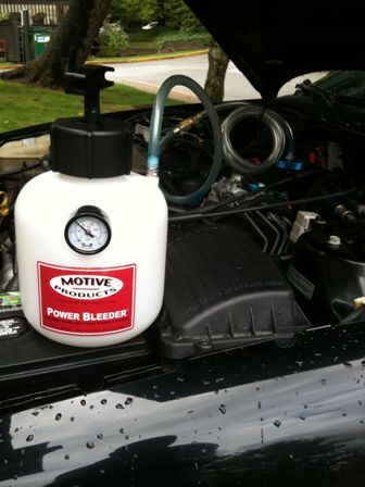

Well, I gave in and ordered one...so if anyone in the club has a need for a brake and/or clutch bleeding unit, let me know...I picked up this one with the catch bottle, we can do a tech day:)...and since my Fiero is done except the clutch with the ATE Super Blue Dot 4, we can do my GA GT and get rid of the stock Dot 3 whioch I cannot remember when or if it has been changed...Cheers
http://store.motiveproducts.com/american-bleeder-kit--0252-p15.aspx - http://store.motiveproducts.com/american-bleeder-kit--0252-p 15.aspx

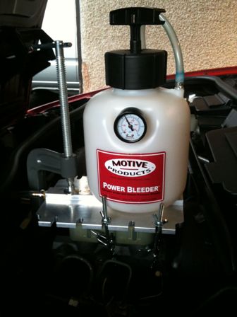

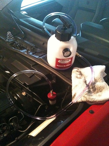

Brian kindly dropped off his brand new brake bleeder at my place yesterday so that I could pressure bleed my brake and hydraulic systems before the autocross on Sunday.
To make a long story short, I can't get it to work properly. There's a supplied plate/seal that sits on the top of the brake fluid reservoir that's supposed to be held down air tight by four wing nuts/bolts and two chains that wrap around the bottom of the master brake cylinder.
I've cranked them all down pretty good and as soon as I build up any pressure (3-4 lbs) with the supplied pump, it hisses in one place or another somewhere around the "seal". To use this bleeder, it's supposed to be pressurized up to around 12 lbs.
I'm hesitant to really crank down on the wing nuts as I don't wish to collapse my plastic reservoir!
I even tried to use a modified factory rubber seal along with this plate while it was on the reservoir, but the rubber seal won't sit properly unless the factory "cap" is also used. (The factory cap sort of sits in the seal and pushes it out towards the edge.)
Any advice from anyone who may have used one of these devices?

I've noticed with mine that you need to try and center the "cap" on the plastic reservoir or it tends to rock slightly.
My bleeder is a huge industrial one but it's rather old and the rubber is less soft then it was years ago.  So I have to be extra precise.
Try that and try to gauge the amount of pressure applied between each chain tightener.  Make them even.
Also, you can do a good bleed with very little pressure.  It just takes more time.  So push the pressure as high as you can and see if the fluid comes out at the other end.
This BTW is one of the BEST things you can do to your brakes.  That being flushing everything out every year or so.
Good advice Damien, but this particular supplied plate is just barely large enough to cover our Fiero brake fluid reservoirs. There is no room for side to side movement at all, and only about a quarter inch front to back.
That's the key right there.
It's difficult to explain, but the bolt/wing nut chain assemblies are rather poorly designed. When tightened up the bolts end up being on weird angles and sort of get jammed in the slots in the plastic lid/plate that's supposed to be tightened down. This no doubt results in uneven torque being applied to the four "corners", and this then results in a poor seal.
With that in mind, I might see if I can put something under the master cylinder (as wide as the plate) so that the chains would be coming straight up after wrapping under it. Like this... U ...more so than this... V ...if that makes any sense!
Date Posted: 03 September 2010 at 6:23pm
I cut out a piece of plywood basically the same size as the top of the reservoir to go under the master cylinder. This allows the chains/bolts to be sitting straight up and down. I've got the wing nuts cranked pretty tight, but the fricken thing will still only hold 4 lbs of pressure before it hisses and leaks. I'm starting to lose my patience as I've been baking in the open sun for hours fiddling with this thing.
I just don't think the rubber pad on the underside of the plate is soft/pliable enough to fit snugly/tightly enough on the top of the Fiero's plastic reservoir.
I don't want to try tightening these wing nuts anymore. Something is bound to break if I do.
I'll try bleeding with 4 lbs of pressure. It'll be better than gravity bleeding, but not by much.

My bleeder has a good setup.  The "chain" goes from one end of a spreader bar, down under and to the other end of said bar.  The middle of the bar has a threaded rod that bears down in the middle of the cap.  So the pull is always straight up.  Works great as long as it's centered.
Brian, you might need to rig up thumb screws on both sides instead of one.  If the cap is leaking on one side, you simply loosen the screws on the good side just a bit and tighten the one on the leaky side a little more.  Eventually, it would seal perfectly.
I bet it would be easy to rig up too.
Date Posted: 03 September 2010 at 10:17pm
I'm pretty sure they were for use on the old style oval master cylinder that was all cast (one piece).  You'd be able to crank THAT sum'bitch down so tight it'd never leak.
Bingo, that's no doubt what it was designed for. Cranking that sucker down on a cast iron reservoir would probably be fine. On a plastic reservoir, not a chance.
...you might need to rig up thumb screws on both sides instead of one.
If you look at that image I posted earlier you'll see that there are four wing nuts/bolts - two on each side. It's no good. It leaks on the ends.
Brian came over so he could see what I was dealing with. There's no way that plate (as supplied) is ever going to seal properly on a plastic reservoir. John's idea of using another piece of softer rubber is actually something that Brian and I were discussing as an option while he was here.
However, it would be best to simply have a plate supplied that seals and works as advertised.

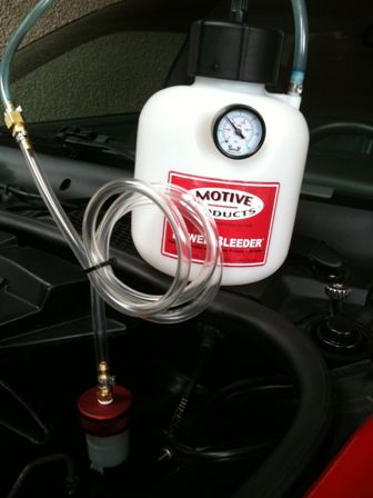

In talking with Brian, who in turn is in contact with Marco (the fella at Motive), it appears that the rubber seal may indeed be a little softer on the metal 1115 as opposed to the plastic 1105. Let's hope that's indeed the case.
So, did I notice any difference after bleeding the brakes with Brian's bleeder?
Yes!
As soon as I stepped on the brake pedal I could feel a bit more firmness. Obviously there must've been some air trapped in the system previously. The biggest advantage of using the http://store.motiveproducts.com/ate-super-blue-1-liter-p16.aspx - groovy blue brake fluid is that it's so easy to tell when all the old fluid it outta there.
At the autocross on Sunday, the brakes felt really good. No pulling, no lockups, no fading (although to be honest we probably weren't on the course long enough each run to get the brakes overly hot).

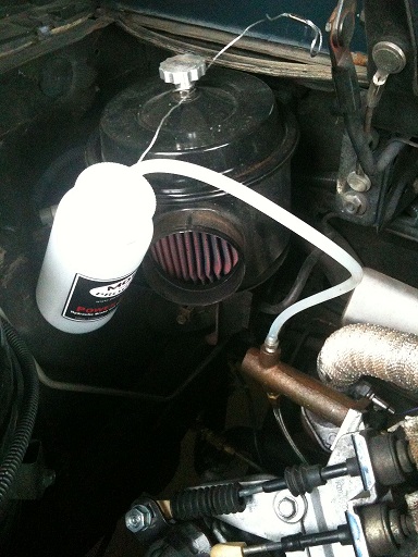

I'm looking forward to trying Brian's bleeder on the clutch hydraulic system next and seeing if that makes a positive difference as well.

Update from yesterday and I just was lazy to post:
I have ordered 3 correct adapters which in value would be $135USD, Marco is providing for $50USD and I am keeping the current ones that came with the kit.
This means that the Fiero clutch and GA brake will have a sealed screw on which is awesome, and the metal retangular unit also...just need to have a couple plates made and buy a C-clamp as illistrated above...can anyone help me with the brace plates?.

Ok, here's some pics...
Fiero Brake adapter, holding 12lbs psi:
Fiero Clutch holding 8lbs psi:
And my GA Brake holding 8lbs psi:

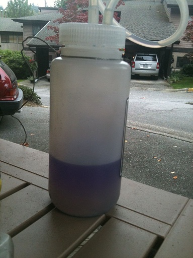

Well, new Purple DOT5 in my clutch, man was this easy, so lots of Blue & Purple running through my lines...Royal Purple maybe for oil...lol, Spring maybe
Test drove and nice and smooth...very happy, Patrick might be on his way today to do his...system cleaned and ready
