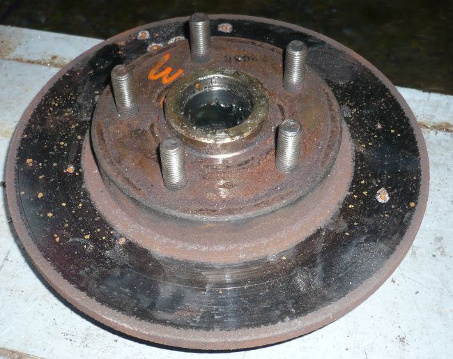

I finally have a set of stock front rotors to turn into Grand Am hubs.  If anyone wants a set of hubs, let me know and I'll get to them sooner than later.

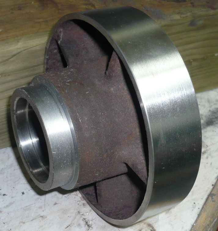

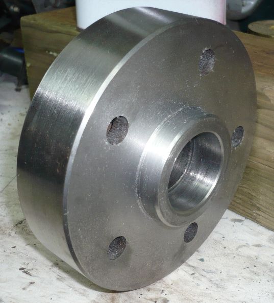

Well I had some time to spare tonight so I decided to whip up a set of hubs.  Only got one done since it's the first time I've done one.
Here's before:
And after:
I'm not putting the studs back on because you really should buy longer ones to be real safe.  I still have the stock ones if someone wants to use them however.
Eventually, I'll come up with a spacer ring to keep the Grand AM rotor perfectly centered.  It seems from what I've read that it really isn't a big deal.  Not having done the conversion myself I don't know.

Having had & used a few of these - I can say for sure that NOT having a way to center the rotor is a major shortcoming.  The rim is lug-centric, but the rotor isn't.  With no centering ring, it flops all over the place and makes braking nasty...

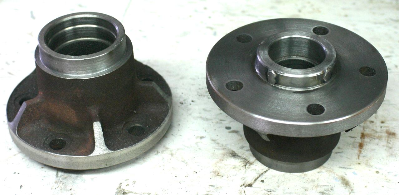

OK, I finally got a totally finished set out the door.
The original units above were too large in diameter to fit in a Grand Am rotor.  I got my hands on some rotors and realized they don't fit...:)
Here are the hubs totally finished.  Tim came and picked them up today.
These are quite a bit lighter and just as strong.  The metal left behind on the originals was not adding to the strength.  It was there for the rotor only.
Lots of machining but nice final product.  I'll make a few more at this price and see how it goes but I suspect I'll want more to do these in the future.

Dawgs idea with the tabs in the centre of the hubs to keep the Rotors in place worked perfect.  I took Tims car out and did several high speed stops and not a hint of shake or vibration.  The car locks up the tires from any speed.  I am a little nervous about how well / easy it now locks up the fronts and will probably have to modify the proportioning valve or remove it all together.   THe nice thing is from now on all brake jobs will be easy and cheap.  On a side note, the Grand Am calipers are only $34 from Lordco, however the core's are $40 each.
