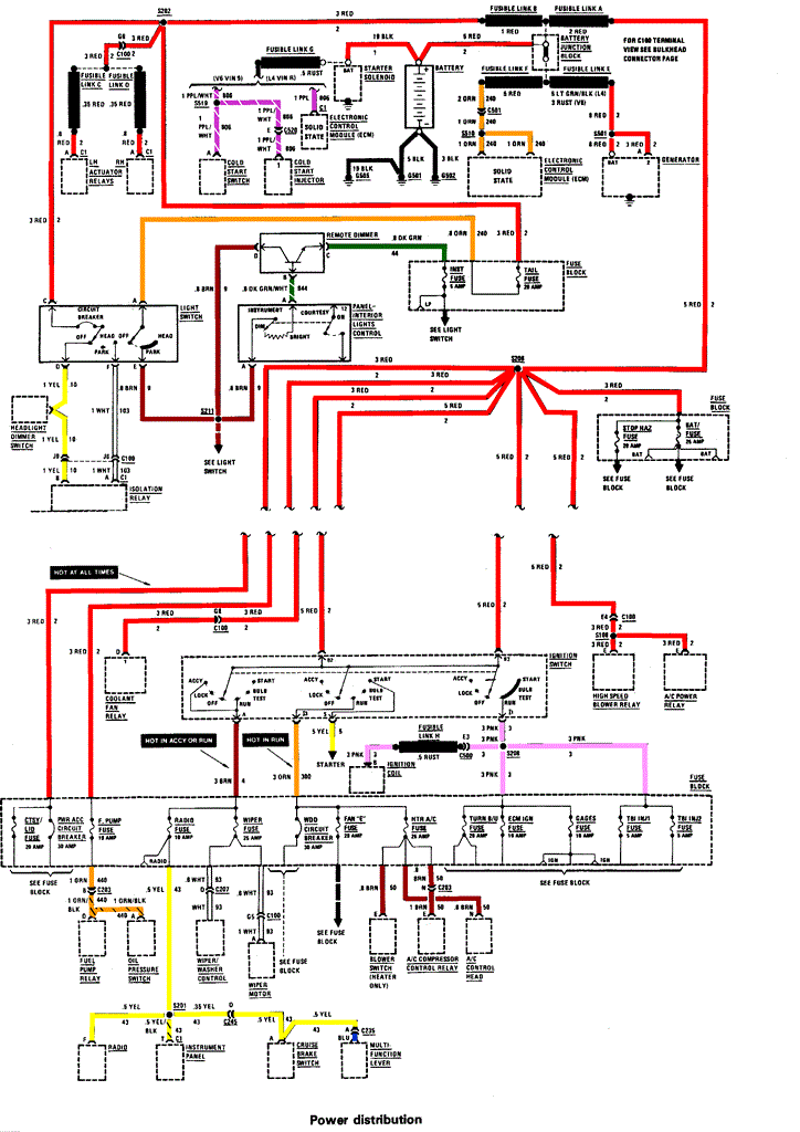

Bit of a loaded question, as they don't even list the ampacity in the manual - only the diameter of the wire.
That being said...  http://wiki.xtronics.com/index.php/Wire-Gauge_Ampacity - THIS chart shows the amperage of a given size wire.
The links are listed in sizes (metric) in the manual, and by color.
If you want to take a chance, you can go by this chart and replace them with fuses.  Or just get the correct color one, and solder them back in place.
Remember that they can LOOK like they're alive, but 1/2 the strands can be rotted away.  So what used to be able to pass 'x' current can now only pass 'x/2' current.
If you see "5" in the drawing...  it's probably "0.5" BTW.  There are no 5mm (that's almost 1/4"!) diameter wires in the main harness.

on your wireing diagram, there is a fuseable link between the starter and the cold start switch /injector/ecm why the thin dashed line? what does it mean?
Asso when you use a jumper wire between the A & B terminals on the ALDL connector to count the flashes on the engine check lite... are the shift light and the rad fan suppose to go on?
