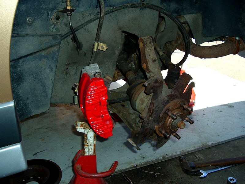

Here's what it looked like once I had one side apart up front...
And here's the options I had in regards to front spring replacement...
On the left is the factory spring (DMF) that I took out, the middle spring is from Intrax, and the spring on the right is a Suspension Techniques unit.
I'll leave you all in suspense for awhile before I tell you what I eventually used to lower the front of the '84.

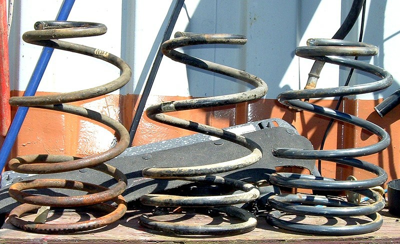

Okay, here's the back all apart.
Here's three back springs lined up. From the left... stock (NWY), stock (NXD), Suspension Techniques.
And here's my able assistant, Clynt's dog (one of 'em)... Sam.
I'm purposely holding off reporting what springs I used. I'll take some pictures of the actual car and how it now looks... and then I'll reveal what was done.
Here's a shot (from a frame of video) taken at one of the autocross sessions last fall...
It's probably no secret now after all this time, but yes, I used the stock springs with two complete coils cut off front and back. I'm very happy with the stance, and with the Monroe Sensa-Trac shocks/struts, the ride is nice and firm.
I was discussing installing sway bars and custom end links with Colby on page 4 of  http://www.westcoastfieros.com/forum/forum_posts.asp?TID=2484&PN=1&TPN=1 - This thread , and I went out to look at my factory end links. Something else caught my eye. See anything unusual in this shot?
The bumpstop is sitting right on my lower control arm!  No wonder the ride is so "firm"!  I guess I haven't had a close look at my suspension since I lowered it while the suspension was compressed.
I may need to make some alterations here...

Date Posted: 08 June 2011 at 2:03pm
Thanks Colby. I've seen that page, and that's exactly what Clynt did to his choptop. However, I don't have the required tools to cut and weld that metal "cone" on each side. (Being the good guy he is, Clynt probably would've helped me with this, but he's recently moved and no longer has a "shop" in his backyard.)
I was hoping that simply cutting down the rubber bumpers (like Kevin did) would be enough, but I won't really know until I can at least take a closer look at what I'm dealing with.
