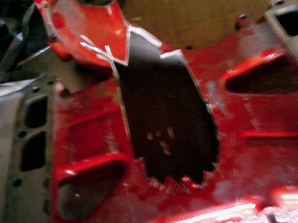

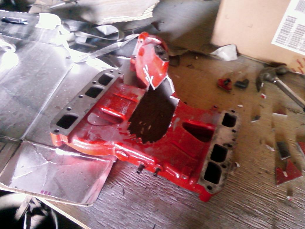

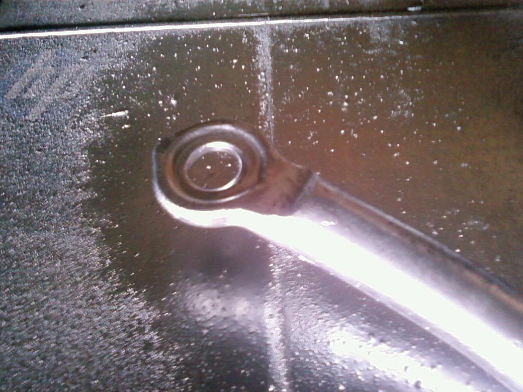

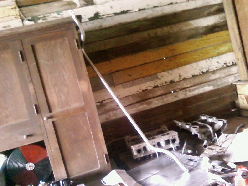

Whew, got a wee bit accomplished today. It's amazing what an hour and a half, two cutting discs and three showers trying to get metal slivers out can do for productivity.
Got the Doc's slave bracket off and Rodney's put on (Funny story about that later). I got my sway bar sporting three fresh coats of chrome (Ok, so it's chrome spray paint, but shhhh) and the energy suspension bushings were bought. Granted, I'm now concerned my ass-end will be way stiffer than the front. Will need to buy another set of bushings soon. Anyways, I also got started on Gretchin's new Frankenstein (TM) intake system. Those of you who have already been told about it (David and Patty) or those of you not wanting to read a long paragraph (Everyone else) about it may wish to skip the next paragraph.
Because the 3400 heads have the ports spaced differently, and because they're larger than the iron-head intake ports, the Fiero's lower intake plenum wouldn't bolt up, so I had to use the one from the 3400. I left the mid and upper 3400 plenums at the junkyard, because I wish to retain the Fiero upper intake plenum for looks, and because that doesn't line up with the lower plenum, I'll be fabricating a mid plenum to act as a transitional piece (Out of aluminum) between the two. Up front will be the 80mm throttle body of an LS1 (Go big or go home) followed directly by the air filter (A la speed density system. See here: http://www.eficonnection.com/coilpercylinder/33WillysCoilMount.jpg - http://www.eficonnection.com/coilpercylinder/33WillysCoilMou nt.jpg ) However, as the Fiero upper doesn't breathe too well, I decided to slit it open from about the throttle back, so I can weld in a 2.5" and 3" piece of pipe, significantly increasing flow capablility. Well, that's what I turned my attention to today, cutting into a Fiero intake from the scrapyard.
Gretchin's intake hacked and sliced.
More encompassing shot of my chainsaw (Er, grinder) massacre.
The shiny thing is the sway bar.
Ooohhh, CHROMANCE.
Now, obviousy I still to finish hacking open the intake, and then smoothing out where I've cut. From there, I'm going to smoothen out the inside of the intake next (Where it says "Fiero" there's a mammoth ridge) followed by as much of a polish as I can get. I will worry about welding and painting last (Don't suppose anyone happens to know what paint that intake uses, do they?)
