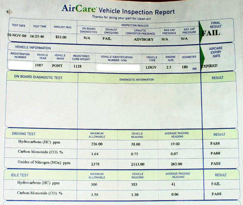

Well, after swapping out my distributor for Dave's, the car is running way better.  Unfortunetly, it failed the idle test.  Bloody Air Care!
Going to put a catalitic converter on and see if the hydrocarbons go low enough.

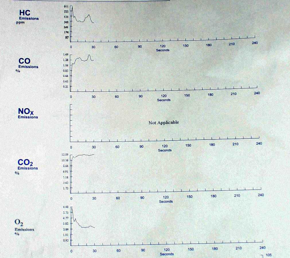

      What did it fail on, how bad, post up a scan of it, I am sure a lot of people would like to see.

You're running around with a semi-unknown combination of injectors and PROM.  That's probably the evil combo that's doing you in.
Date Posted: 19 November 2009 at 8:30am
LOL, currently he is running around with the prom from Clytns Auto car on an Isuzu 5spd.  So uhm ya, I mentioned that to him.  I am sure he will be in touch with you soon.
      Notes on the engine.
3.1 V6,
using I believe stock 15lb Fiero Injectors, if they are the larger 17lb injectors from the 3.1 then the Fiero fuel map should be fine.  If not, probably increase the high rpm range fuel curve 20%.  However leave the low side below 3000rpm stock.  If they are the larger injectors, I would say, reduce the low rpm fuel curve and leave the high rpm alone.
Timing.  Advance the low rpm under 3000 timing curve and leave the high end stock.  This is to compensate for the bleed off in the cam. (trust me on this, it took almost 14 degrees to get it to idle smooth, which I know must be hurting top end when compression catches up with cam)
Aftermarket Cam, info covered in Timing stuff.
EGR Delete
5spd Isuzu
I would leave fuel enrichment OFF
Again if you can find the last version of my 2.9 chip, which is the same one Brian is running in his 3.2 and loves it, then just tweak the fuel curve as Brian and I both had 19# injectors.  Then Burn that setup it should be perfect.   Hell just take that program reduce the entire fuel map 20% and it just might be perfect like that.

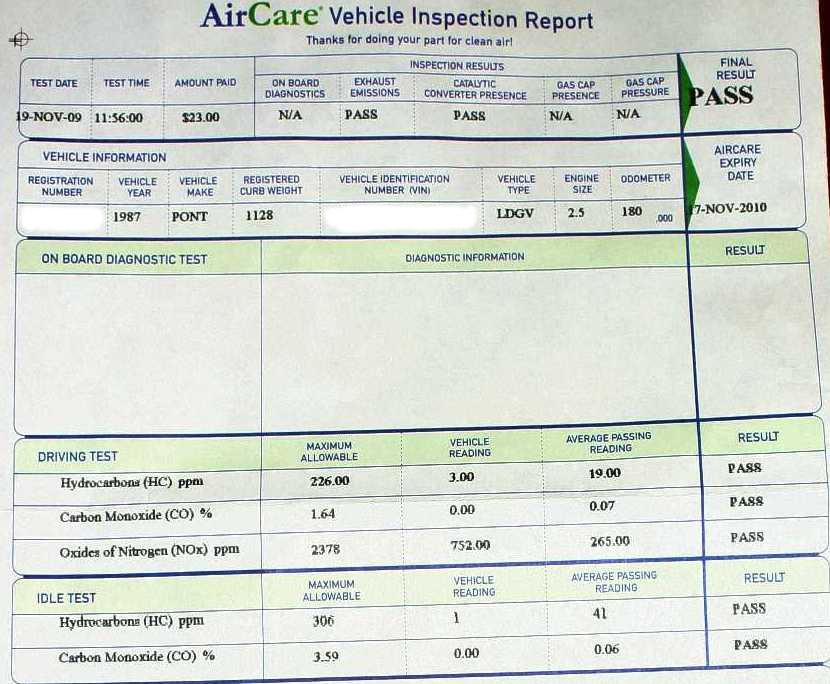

Well spank me with a wet noodle....it finally passed!
Installed a generic CAT and we're off to the races so to speak.
The previous fail was Hydrocarbons on idle.  It was just over.  The allowable is 306 and I was 380 or so.  I'll look for the test results.  I think I ripped it into a million bits....:)
Now with the brand new CAT it barely read any hydrocarbons at idle.  The reading was a 1. Carbon Monoxide was 0.

OK, here's the Aircare pictures.
This is the fail
This is the fail report
This is the pass

Here's the http://www.aircare.ca/inspinfo-get-results.php - Aircare test results  for my '86 GT. The last readings were with the EGR deleted, custom PROM, and no cat. The previous readings (where I failed the test) were when my cat was plugged!
I've added the maximum "Allowable" amounts for reference purposes.
