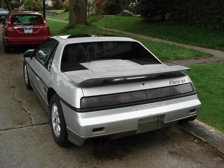

Here's how it looked with the tip out.  You can also see the nice puddle of ATF on the ground from my leaky trans line, that ended up just being a loose clamp, which was a nice break.
I have to mention something funny that I noticed as well.  This very same care was owned by someone else who was/is on these forums.  I was searching through the "old members rides" page and noticed "Vlad's 85 gt" and saw the wheels on his car right away.  They look just like the ones on my car..... appear to be mkIII vw gti rims, so I doubt too many local grey 85 gts would have them.  I looked closer and saw the difference in paint colour from where the bra on the car used to be as well.  The big kicker was the battery though.  On his personal webpage link there's a shot of his rear trunk mounted battery.  Well look at what's under the trunk of mine.....
I just thought that was kind of neat.  Does anyone know if he's still around?
Eventually, I brought it over to our pit (I've been keeping the car at work since all my tools are there and I'm allowed to use the shop on days off as long as I don't get in the way of the mechanics on duty), changed the oil and had a look underneath.
It looks so much better with the tips on both sides!  Underneath looked ok.  Rad support is rotting away, but still holding fine, just needs a patch on the bottom.  Everything else looked decent, it was $650 remember?

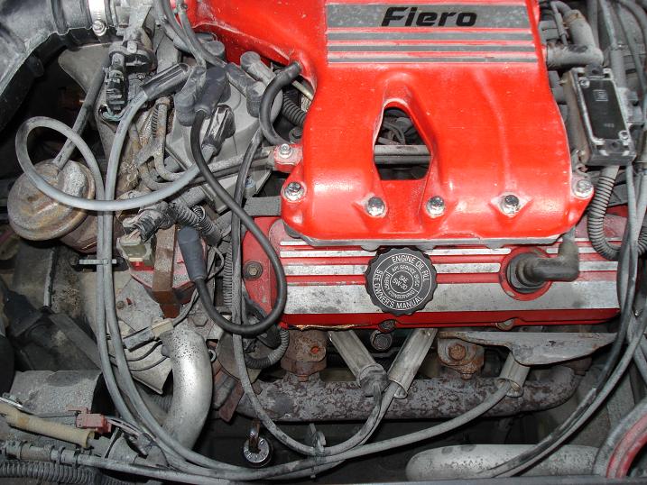

I found some of the engine shots as well, so here it goes:
Before the tune up (note the clean wire from the distributor to coil, ghetto anti-theft baby!)
The front three plugs looked ok, the back 3 were just ugly.  2 of the holes in the head were stripped, which was kind of a piss off, but the new ones are in and working now.

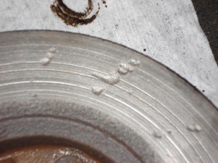

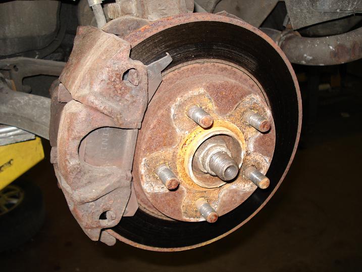

The next weekend I tossed it on our hoist to see why it brakes so poorly.
This was after sand blasting the front rotors..... they gotta go soon too.
Fronts after I was done cleaned the rotors and filing off some pad material to get something fresh contacting the rotor.

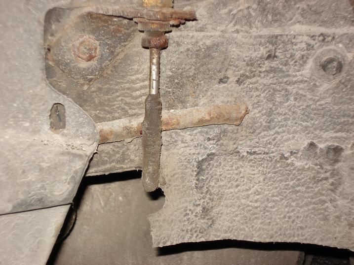

What's left of my e-brake cable
Like I said, if I find that the stock brakes are very bad, I'll change them, but this isn't gonna be a race car or anything, more just for cruising right now.

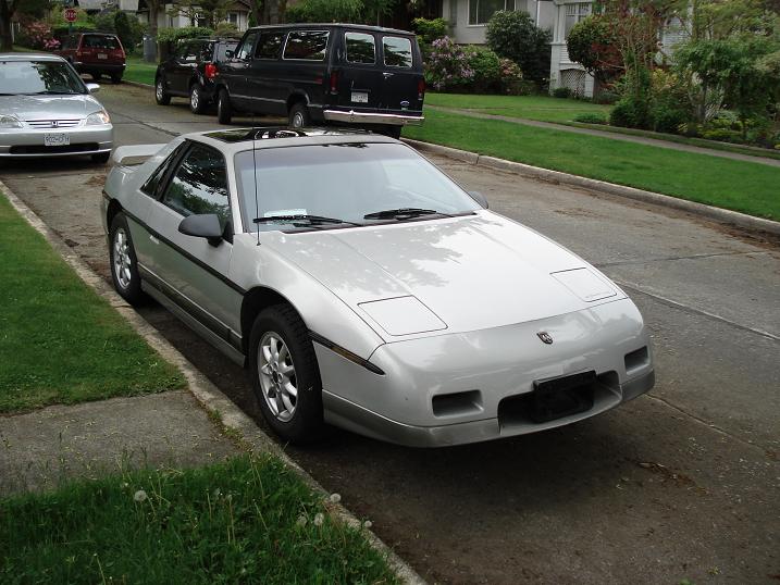

Took a few pics when I actually did get it on the road for a while.  Looks a lot better after a wash.  Too bad it started to rain later :(

I noticed a little bit of an improvement when I cleaned up the fronts, but still could not lock them on dry pavement.  Either way I'll have new everything in the back with premium pads, and maybe after my next pay day I'll get rotors and premium pads for the fronts.

Check your front middle cylinder for compression. The
spark plug looks quite a bit different than the rest.
Looks like it might have been missing quite a bit.

Good eye!
Date Posted: 09 June 2009 at 4:32pm
             Maybe its just camera angle, but, if you have not garbaged the plugs, grab a feeler gauge and check the gap on the plug that Vlad mentioned.   It almost looks like the electrode is burnt off.  If the gap was MASSIVELY different than the rest, it can also be a sign that, that injector was partially clogged making that cylinder run really lean.   There is only 1 O2 sensor in a Fiero, yet there are 6 injectors, so if one injector goes bad, the ecm simply adds fuel to the entire system, which lets that one bad cylinder run dangerously lean, and at the least will result in one plug burning out, and in worst case, can burn a whole in the piston.        Also verify the EGR system is functioning.  If the computer thinks there is an EGR however it is mechanically disabled, it can cause lean out rather badly.  Just pull up on the underside of the EGR pod, and see if the motor stumbles, and check the codes for any code 32 errors in the ECM.   If the motor stumbles when you pull up on the EGR pod, then the pipe and pod are working, if you don't get any codes, then the electronics are working and you should be fine.   To verify all is well, hold your finger on the diaphragm of the EGR pod, and use your other hand to slowly rev the engine to about 3000 and hold it there.   You should feel the diaphragm pull up on its own.   If it doesn't you need to either get a chip to disable the computer from using the EGR or fix the EGR system, OR as a last resort retard the timing to 8' vs the stock 10' or 12' that most people run there car at.

If I were you I would simply go ahead and change front
middle injector and see what happens over the next 3-4K
kilometers. Finding a single injector shouldn't be a
problem. I'd ask Capt.Fiero for assistance.

PS. I just realized that this is the same set of spark
plugs I put in the car last time I tuned it up. Don't
ask me how I know. I am sure.
I just noticed that the spark plug with the different color electrodes also has a different color terminal at the top... and is the only one that "AC" (well, the "A" part anyway) can be seen clearly. Is there a connection?
Date Posted: 10 June 2009 at 1:39am
I was kinda looking at that earlier, looks like there are 5 that say Motormaster V-Groove and one AC Delco.   Hmmmmm
Here I rotated and blew it up and cleaned up the image a bit.
Posted By: fierowned
Date Posted: 10 June 2009 at 4:47am
Yep, you're bang on, there were 5 motomaster plugs and one really ugly ac delco one.  I have some injector cleaner gunk kicking around, figured I'd add that in when I chage the fuel filter coming up.  Not saying it'll cure an injector problem if that is it, but it couldn't hurt.  I want to drive this car as soon as I can and figure I can continue doing any repairs in the fall.  As long as it drives fairly decent, I'll be happy enough with it to drive it for a couple months this summer.
Thanks for the pointers though, much appreciated.  I'm a bus mechanic apprentice, so I'm really not overly experienced with diagnosing gasoline engine problems.....well, ignition systems at least, the rest is all pretty much the same, and I've picked up enough from maintaining my own cars to usually get by.
Knowing I that I did the cap, rotor, plugs, wires, air filter, oil change, and that I'm going to be doing the fuel filter soon, do you guys figure it should pass aircare ok with that cylinder running hot?  Assuming the EGR is actually working..... just trying to isolate the bad cylinder problem.  If I can get away with not fixing this until fall I'll be really happy, I want to enjoy this car in the sunshine while I can:).

So I've been pretty busy since the last post, but I've since managed to get all my brake issues sorted out, not to mention a few other things.  To summarize what's been done:
- New rotors and pads up front
- New calipers, rotors and pads in the rear
- E-brake cables and return springs
- Fuel filter
- Replaced my wheels (it looks stupid now with 2 different sets, but they were just too cheap, I'm just gonna burn the rubber off them.)
And I must add, the rear caliper clips to hold the pad in place are about the dumbest thing I've seen!  Either way, it's all over and done now, and the brakes are SO much better with all the new stuff and a good bleed.
Like I said I would before, I added some fuel injector cleaner stuff too and it runs great with no more occasional check engine light showing up.  Took it to aircare for the hell of it because we got a permit for saturday and............ IT PASSED!  Passed pretty easily too, wasn't even close to failing, go routine maintenance haha!
I must add that while it did pass, it left a  nice trail of coolant on the ground as I left the aircare building.  It comes out of the overflow well before it should according to the temp gauge, but I had so many cooling issues with my 91 z24, that I know I should be able to take care of this pretty easily.  It needs a good flushing anyway, and I was going to do it this saturday, but I figured since it's actually driveable right now, I'm gonna take it to the meeting as it is, and try and save the repairs for sunday or next weekend.  I just need to keep it moving or turn on the a/c to get the fan going.  Will be nice to meet you guys in person, just please be nice about the wheels hahaha, I'm well aware that my car looks dumb, but with the faded paint and torn interior, I'm not making any show car, just want a reliable cruiser built on a budget.
I'll try and get some more pictures soon, I had to try and get everything replaced in one day, so I had no time to photograph anything unfortunately.
