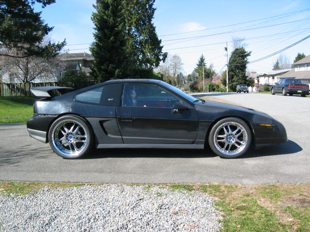

Date Posted: 28 May 2007 at 5:30pm

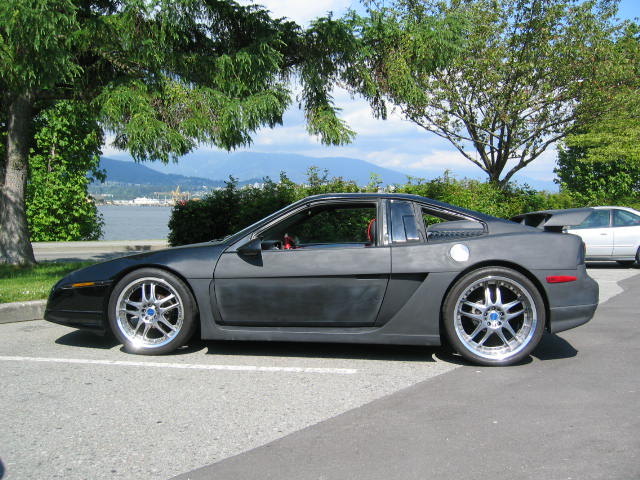

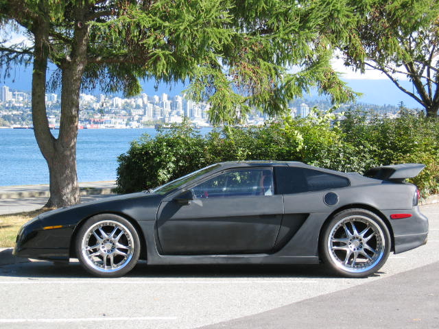

pics in Stanley Park...

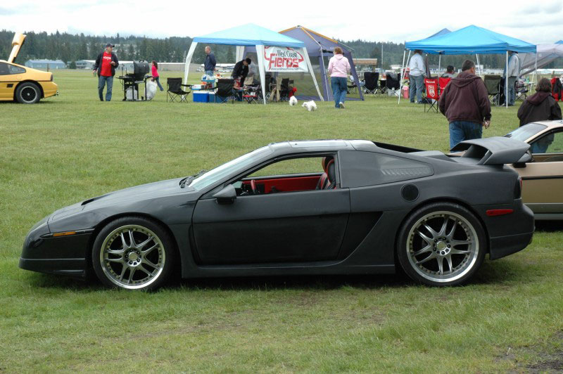

I saw this car in person and all I can say is WOW.  The pictures don't give the proportions justice.  From more than one angle it looks really Ferrari F40ish.
Date Posted: 07 June 2007 at 7:08am
Side-by-side width comparison: stock 68.9", widebody 74"

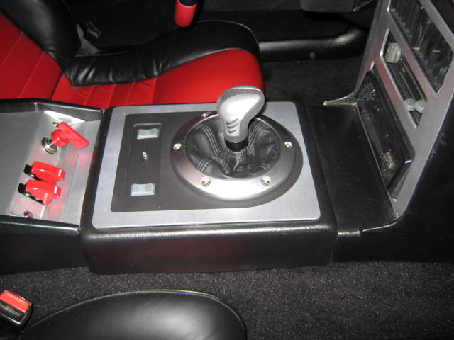

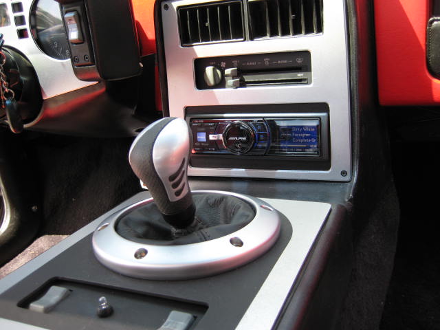

Today Waylon installed an alarm and wired up my stereo.
When all else fails, read the instructions!
The stereo sounds FANTASTIC!
Thanks Waylon (great job)

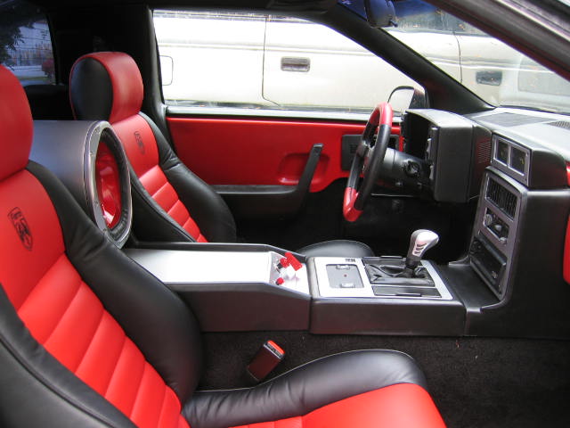

Back of sub box is fibreglassed and sealed...
What a PUNCH it has now!!!!

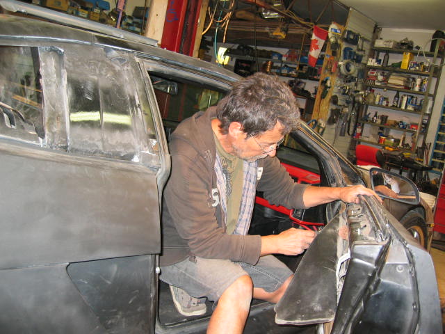

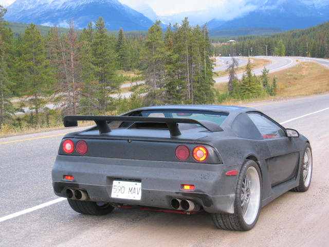

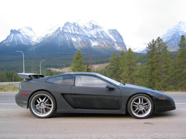

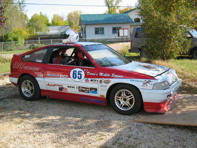

SEPT. 10...
Went to visit my brother Dario in Winnipeg Manitoba.
Fiero and I had a spectacular ride through the Rockies.
SEPT. 11...
Fiero in Dario's shop at 5pm.
SEPT. 12..
Well, what can I say?
Posted By: Blair
Date Posted: 27 September 2007 at 7:43pm
Looks like you are up to something John?

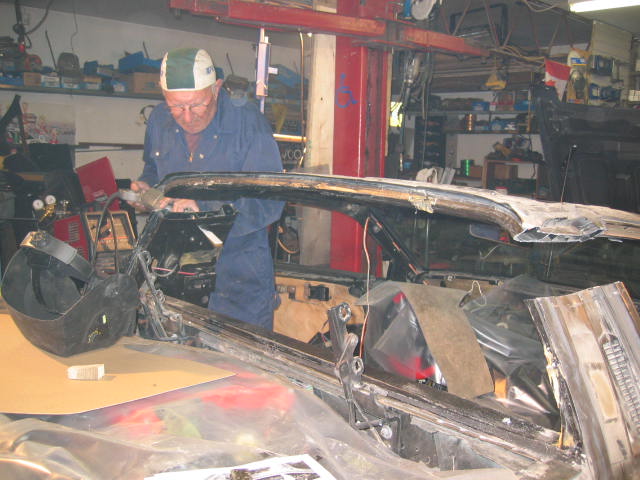

Date Posted: 28 September 2007 at 8:17am

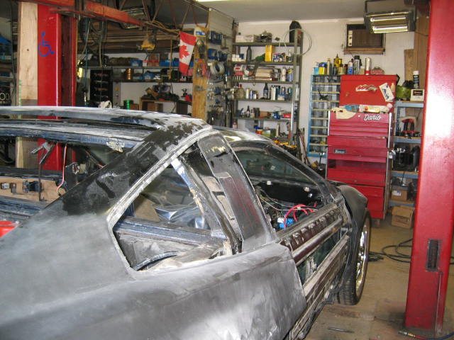

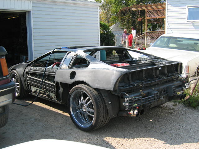

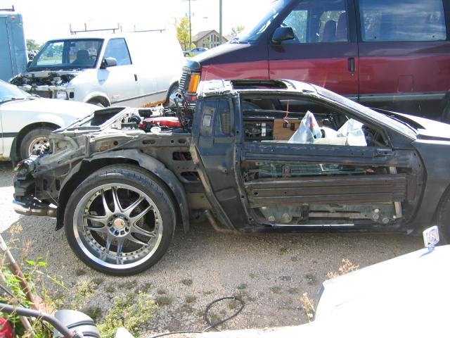

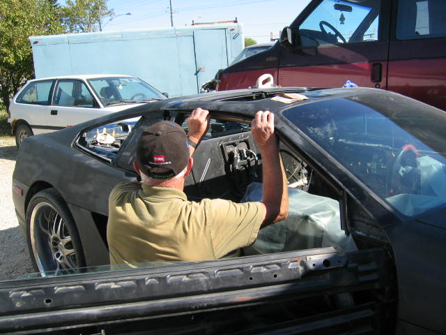

SEPT. 13...
Hey John, how much do you want chopped?
Dario, let's start with 2" for now.
Date Posted: 28 September 2007 at 11:06pm

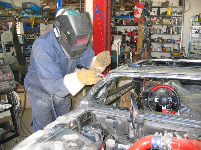

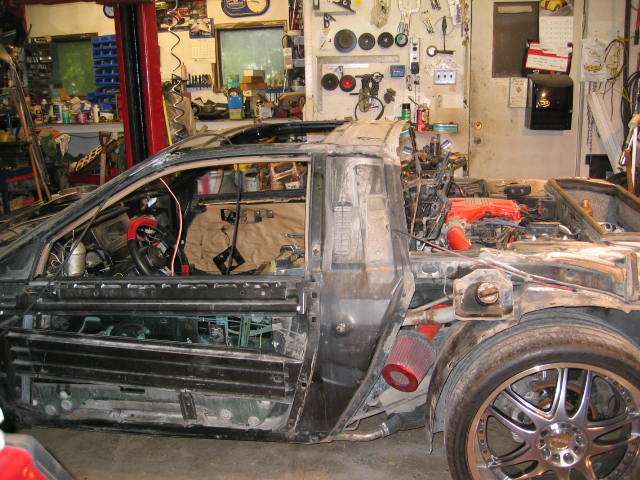

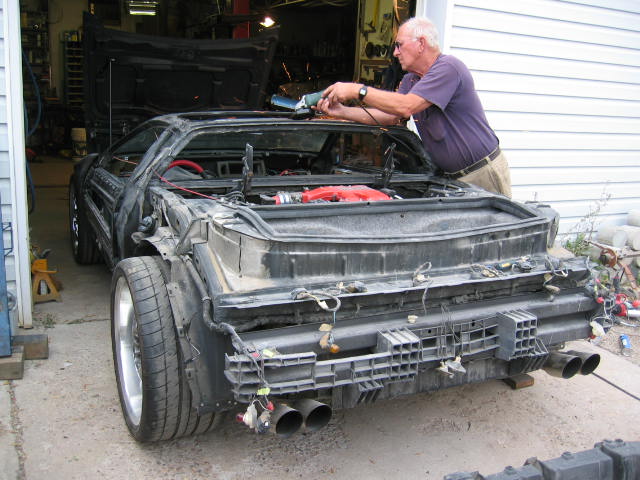

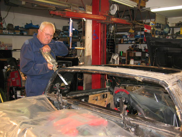

SEPT. 13-14...
Welding everything up
Ready for roof panel and rear clip
Date Posted: 29 September 2007 at 8:15am
SEPT.14-15...
Rear clip to be cut to fit chopped roof
Rear clip and roof panel fibreglassed
Date Posted: 29 September 2007 at 8:57am

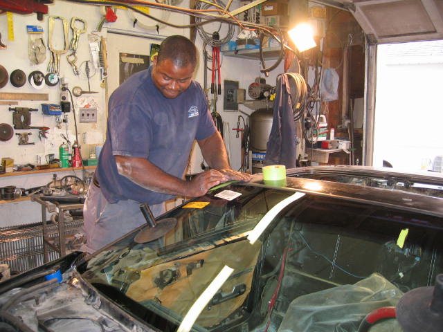

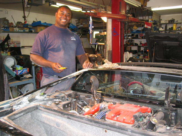

SEPT. 18...
Leighton (from Pro Body Parts)
installing new rear glass
Installing new windshield

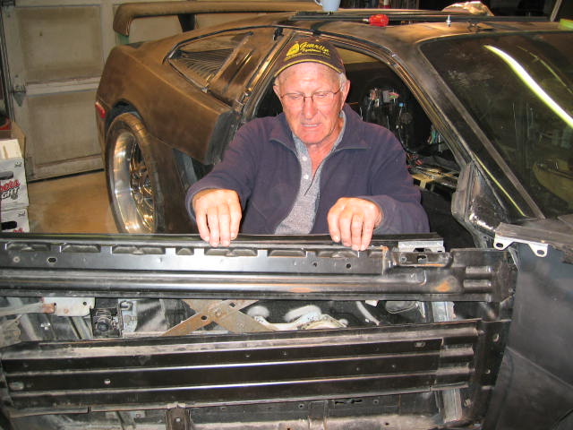

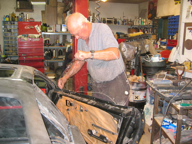

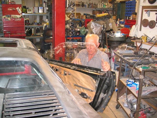

Sept. 19-20...
Dario test fitting side window
Installing side window
Note: Marcel (WCF Cub member) works for ACRYLCO MFG. LTD.
He supplied the 4x8 plastic (that makes two sets of side windows)

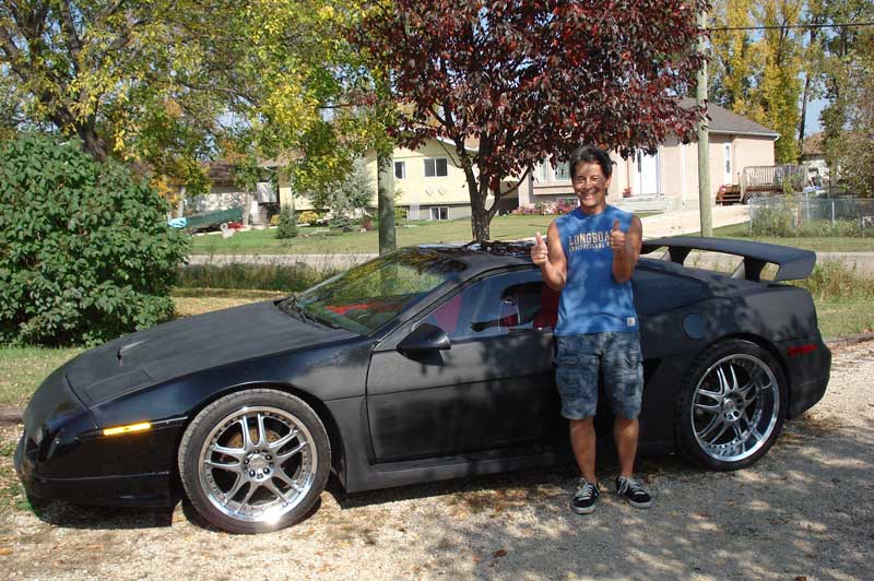

SEPT. 20-21...

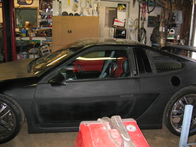

Reinstalling and custom fitting interior
FINISHED...and that's working less than half days,( Dario had to go to
work)!
I had time to play around installing body parts and interior
Finishing touch, FIERO WAREHOUSE tinted rear quarter windows
Dario and I, doing the thumbs up!!!!!!!
Date Posted: 29 September 2007 at 2:02pm

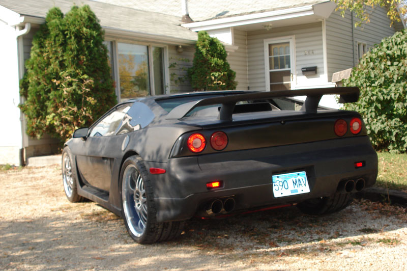

SEPT. 24...
Ride home with a BIG SMILE !!!!!
It rained on and off, fiero is very dirty
Good test, side windows didn't leak at all with all that rain.

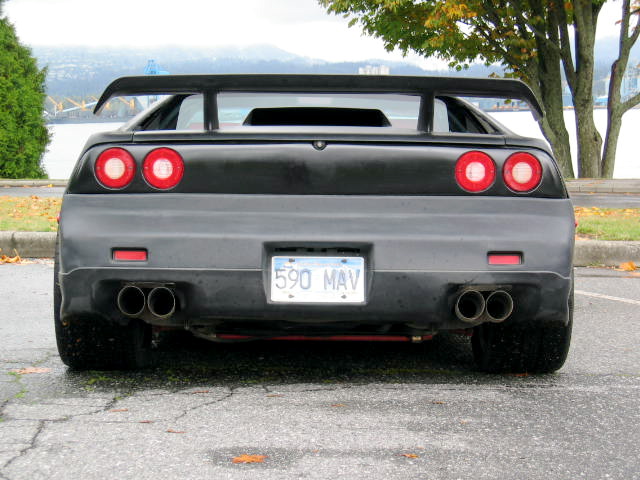

Stanley Park
BEFORE AND AFTER....

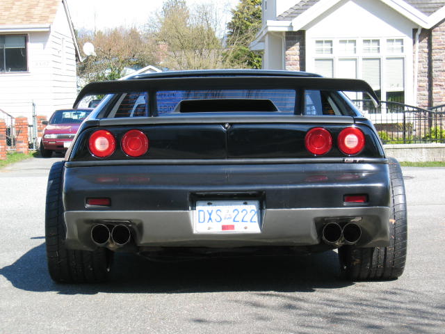

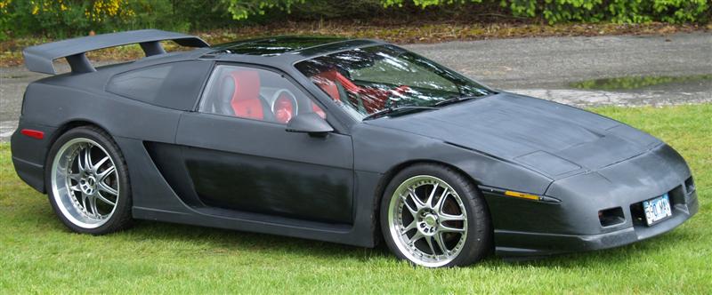

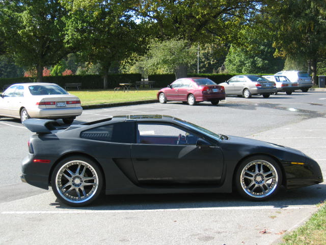

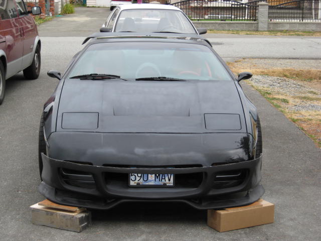

Date Posted: 04 October 2007 at 11:01pm
WAY BEFORE: (stock, just new mags)
AFTER: (wide body, stock bubble top)
AFTER: (wide body and chop top)

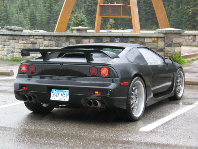

Added matching tail lights with red LED's bulbs.

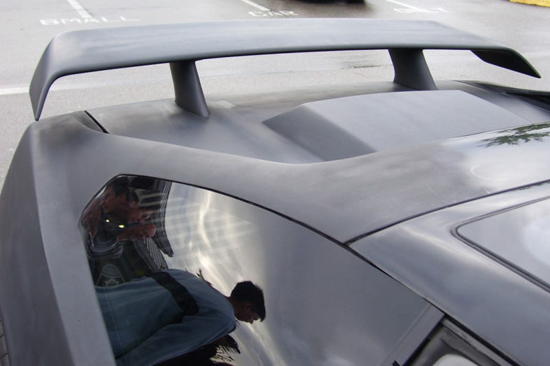

Few more pics my brother shot just after finishing choptop...

It's a small world...
Leighton works for Pro Body Parts in Winnipeg Manitoba Canada. That's where my brother Dario and I did
the chop top.
Leighton is known quite well to the auto industry there and everyone asks for him when they want their
work done and he is great to work with.
ADDED FEATURE...

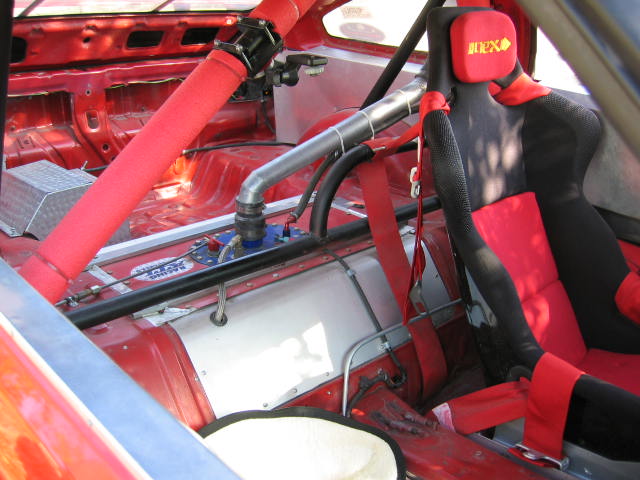

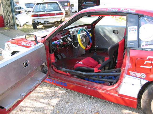

A little info on my smarter brother Dario. He's 75, still very young, and active. He plans to race again this
year at Gimli Motor Sport Park, road course, 1.3 miles and his time is 1.5 minutes. That is one of his
hobbies. He has built this race car, CRX with a 1.6 (170 hp), the Japanese version of the Acura engine,
plus the ACURA disc brakes all around.
I hope I have said this right....
He builds roll bars for most of the racers there.
This is the kitcar that we built in '80-'85

Choptop cost (roughly)...
Holiday trip to Winnipeg, visit my brother, NO CHARGE for his TIME "well, he's my brother"
(he was happy for my visit and we had fun working together again).
Windshield..... $240
Side windows. $130 (4X4 plastic sheet $50/ form windows $40 each )
rear window..... $80
Total cost........$450

i want my insides to look like that question the red materials on the door pannels what is it?
Date Posted: 29 February 2008 at 2:59pm
Okay, I'm back...
The material on door panels are red vinyl paint, black vinyl paint and black carpet.
At the time I did the interior in '02, Canadian Tire and Lordco didn't have the bright red vinyl paint.
Found it at "Concept Finishes" here in Vancouver, bright red is "SEM Colorcoat" flame red ($10).
(The vinyl paint still looks like new on doors and dashboard )!!!!!

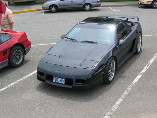

Date Posted: 29 March 2008 at 7:54pm

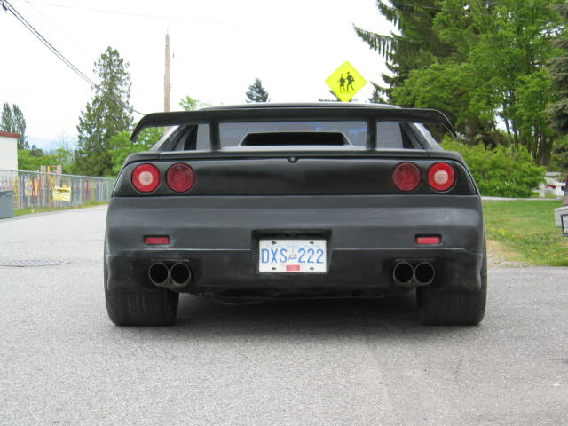

It's almost April BUT...

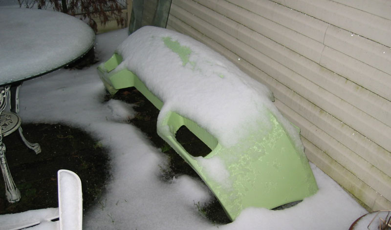

This evening it snowed about 1-1/2" here in Vancouver and this what it looks like on my deck.
The rear bumper that you don't see to well is for a Celica (F430 style) from Mr.Bodykits $225.00.
I had it since last fall but no time to install (had to much fun driving the chopper around)!
When it's a lot warmer out, I'll chop, cut, widen the rear bumper and make it fit.

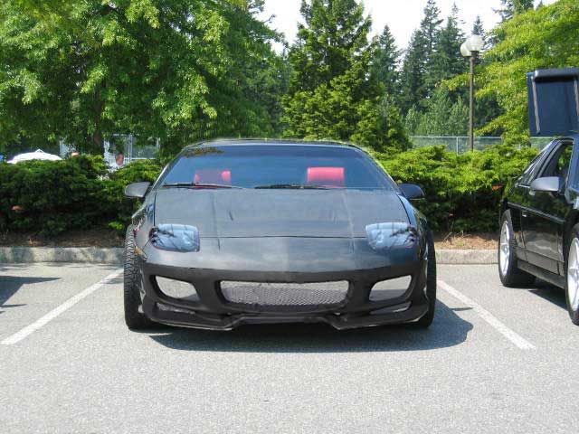

Here's a sneak peek...
Photoshop of RX7 nose
Actual RX7 nose cut to size (to be installed)

Did you make the lights transparent in Photo Shop? Or was that just a drop and drag job?
I wanna go fast.
Date Posted: 21 April 2008 at 1:46pm
The fibreglass nose is just a drop and drag job (I should've blacked out the openings)....if that's what you're asking.
As for the headlights, they are going to be flush mount with dual projectors on each side.

The only time I had was to tweak the existing console adding new ring and
boot.
VIPER ring and boot...

I got the ALPINE iDA-100 WITH iPOD nano (thanks to Brian showing me
how his worked).
I had no idea to upgrade until then and that's the only way to go (well for
now).
I'm very happy with this system, it's like having one big iPOD on your dash
board?
My only issue is the screen should be on the driver's side, I tend to lean
over to view (well, for now)?
Now, this is all I carry to the car (no more bulky CDs!

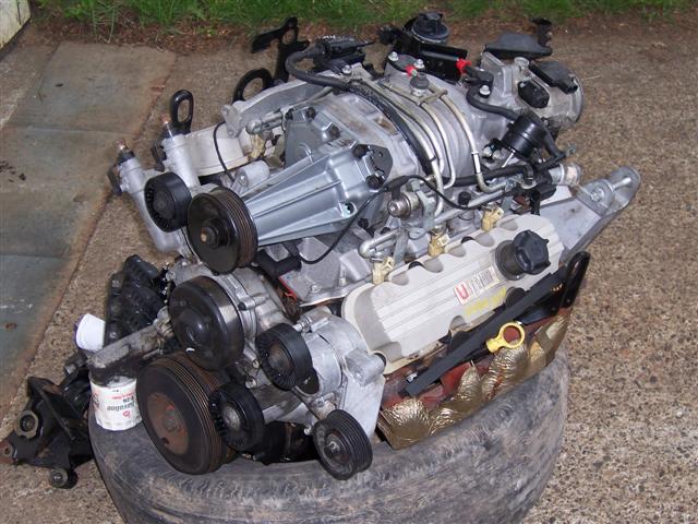

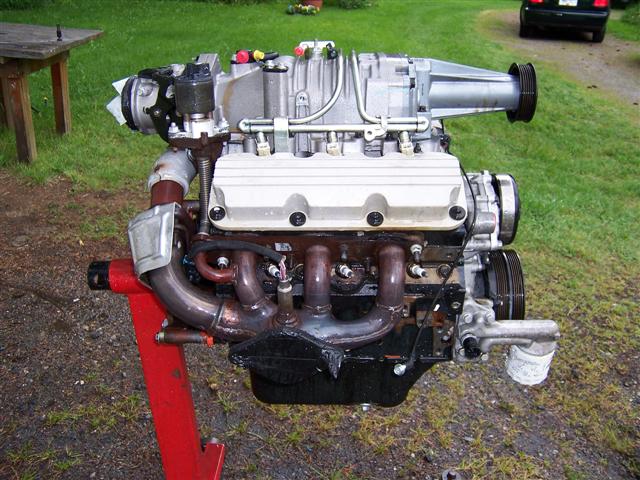

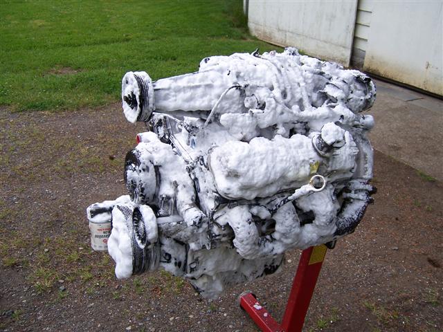

Something showed up at my house today. It's a 98 series 2 3800sc and it's going into Johns car.
after stripping off all the junk it's time for a bubble bath.
All clean and sparkly, it's ready to start the install.

Posted By: marcelvdgn
Date Posted: 02 June 2008 at 10:57pm
Blair.... anything special about the BUBBLE BATH solution????
i need to do the same to mine
