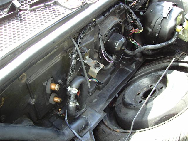

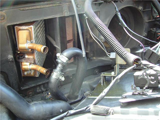

Originally posted by madsod madsod wrote:
I purchased a none A/C heater core...
Make sure you change it out from the front then... from the spare tire compartment.
It's an easy job. The toughest challenge will be to get the hoses off the old heater core tubes. After a couple of decades the rubber hoses practically "bond" to the metal.
The less air you introduce into the cooling system the better. Remember to "burp" the system afterwards.

Date Posted: 15 May 2009 at 5:13pm
I installed new Heater Core today, I was surprised how easy it was. I hope I burped the system properly..
