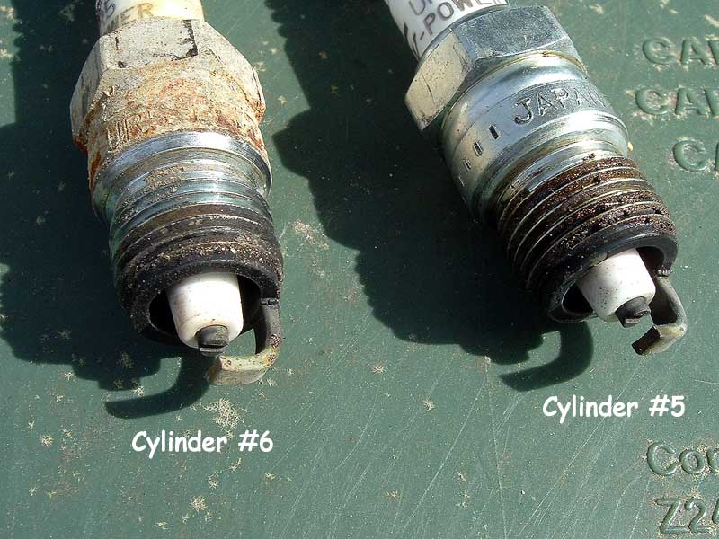

The tail pipes are definitely black and sooty. Last weekend I pulled the #5 spark plug (yes, I will pull them all to have a better look), and the ceramic tip was absolutely white. I was surprised.

Marcel, are you suspecting coolant leaking into the combustion chamber and "steam cleaning" the spark plug I had a look at?
As I mentioned, I was rather surprised myself at the whiteness of the ceramic tip of the plug I had taken out. However, I've recently checked the overflow tank and the coolant level hasn't changed. The GT never overheats and steam only comes out of the tail pipes when it's first started (although lots comes out when it does).
I'm real curious now what the rest the spark plugs look like.

These spark plugs have been in since last summer. I agree, it's very strange to have such a clean spark plug when the tail pipes are black. No sign of the electrodes melting though.
Originally posted by Eric Eric wrote:
Not to beat my head on a wall, but when was the last time a new O2 sensor was installed.   What Brand did you install?
When all this terrible mileage started, I swapped the O2 sensor out of my Duke. When that made no difference, I put in a brand new O2 sensor. Yes, it's a Delco!  Obviously it made no difference either. WinALDL shows that it's "switching" (or whatever it's called) as it's supposed to.
As I said to Marcel, I need to have a good look at ALL the spark plugs to see if any look different. Perhaps when the latest monsoon is over I'll have a look.

Black sooted up tail pipes can be normal on a Fiero due to the type of fuel injection.  Its still notable but not something to base a whole basis of an issue on.
White spark plugs should be where we look first.
There is no way to get a bleach white plug except from running lean.

Dave, I know you're bringing up info on "running lean" as a general educational guide, but I'll cover each point as it applies to my engine just to help clarify the situation I'm facing.

I need to know what the other plugs look like. If they are all black it's time to get serious about that cylinder.
I took all the plugs out yesterday. Every plug was clean, they all looked the same. A couple of them had the tiniest bit of tan colored residue on the tips, but basically all white.
Here's two of them. #5 is the one I had taken out earlier and reported on, #6 looks basically the same (except for all the rust from being installed on the front bank!).
Date Posted: 06 April 2009 at 6:12pm
Nobody's mentioned, but since it'll come up....
You DO have the right plugs in there (UR5's) for a stock engine.
(I could just make out the p/n in the above pic)
That's one other thing that will cause bleached plugs.  Too hot a range.
The 'correct' listing for my '87 Duke in the Autolite (POS!) brand ran so hot that it would actually knock!  They never budged from bleached.
NGK's went in - all problems gone.
Too bad that's not YOUR problem though.

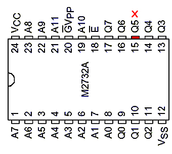

John, remember the heck of a time you had trying to remove the factory PROM from the carrier when I went to your place last summer to get the EGR delete PROM from you? Well, I guess one of the pins got cracked in the process because as I placed the factory PROM on the carrier (and before I put any pressure on it), I noticed one of the pins sort of folded over. Of course, as soon as I snapped the PROM in place the pin broke right off.
This image shows which pin broke off. X marks the spot.
Well, I had a heck of a time removing the custom PROM from the carrier as well before I tried to re-install the factory PROM. One pin broke off of it also despite being very careful. Yes, I slightly bent all pins away from the carrier so they wouldn't "grab" anymore. That damn carrier is just too tight and doesn't want to let go of any inserted PROM.
So now I've got a dead Fiero until I track down a factory PROM for an '86 (or '87) automatic V6.
