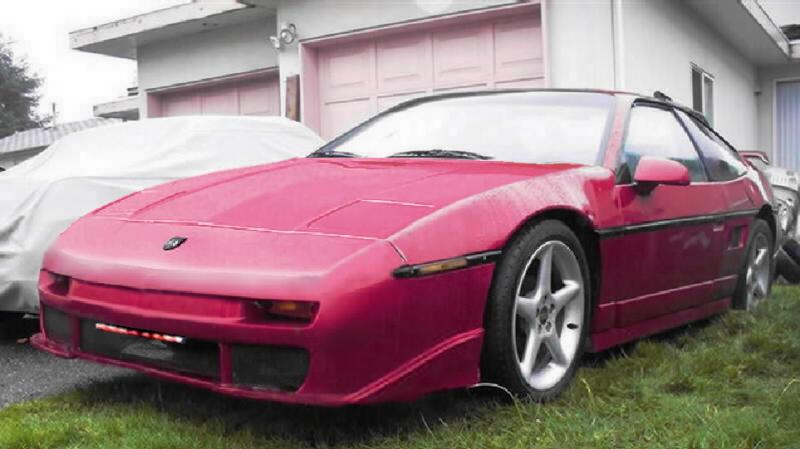

I wasn't sure if I should put this in Build Threads or Members rides or General, so General gets the win.  Well seeing as it is a new purchase and not yet a build, I figured this is where I should put it.
The car is an 87GT V6 5spd.  Full load.  Power windows, Power Mirrors, Power locks, A/C interior is an 8 out of 10.  I think with cleaning and minor repair to the drivers bolster it could be a 10 out of 10.
Front body damage is cosmetic only.  I have a different hood to go on, different fenders and other misc parts for it.
          This is the car that I am going to build to (makes me sick to say this) replace my 85GT which frankly needs to much chassis work to make it proper.
I am going to take the interior out, wrap all the parts in plastic and put them in storage.  The 87 is going to get my full black interior from my 85GT, shifter, stereo, amp, seats with speakers.  When I climb into the 87 I want to feel like I am climbing into my 85GT.
I am going to move the entire rear suspension from the 85GT and move it to the 87GT cradle included.  The 5spd Getrag will be the only drive train part being kept in the 87.
I am going to install my black cowl hood on the 87, along with a black deck lid, possibly my black doors as well. Black Fenders, too.  Pretty much the only body panel staying on the 87 is the fastback clip.   Which will be sanded and painted black.  The entire trim will be painted white same as my 85GT.     The 3 spoke wheels will also be moved to the 87GT.
     If you are a member of the chat list, you will have a good idea of what is going on.  I love my 85Gt and never wanted to ever give it up.  To be honest, I said, when I die, bury me with the steering wheel from my 85GT.
           Because of the stress fractures in the chassis of my 85, as much as I love it, I have to let it go.  However the heart of the car will be saved and moved into the 87GT I just bought.
  Now for the bad things with this car.  There are no keys.  The owner locked the keys in the car, and before he was able to get them out, someone broke into the car, and tried to steal it from the parking stall it was in at his apartment.  Little did the thief know, the clutch was totally gone.  The car would not move.  Apparently the thief got out of the car, took the keys and left.   The battery is dead, but I ran a jumper wire into the cabin and tried to pop the trunk, I can hear the relay fire, but the trunk is not moving.  As much as I hate it, I may have to drill the lock to get the trunk open.  I don't have keys so killing the lock is not the issue, I am worried about damaging a good deck lid.
I am going to sand around the nose, then fill in any cracks. To be honest its worse in the pics than it really is.  For the most part it is just paint missing from being towed.  I don't know what he did to the fender, but the metal under it is perfect.
Well enough talking here is the car.
Edit to add in fine print.  I paid $300 for the car and $95 to have it towed to my house.

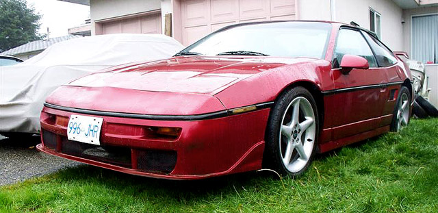

Steve aka fourpoint9    did some tweaking on the nose.  Here are the 3 variations we came up with.
Posted By: fourpoint9
Date Posted: 01 December 2008 at 8:37pm
Posted By: Fire451
Date Posted: 01 December 2008 at 8:39pm
i like the last one the best
Date Posted: 01 December 2008 at 9:06pm
Hot Dang Steve, if I vent it correctly I might be able to use the nose vents to let the trapped air off the radiator.
Date Posted: 01 December 2008 at 10:13pm
I just gotta add my comments on this nose.
I think the nose is quite distinctive as it is. I like it very much with the black rib continuing around the front. It looks more "finished" this way. When the rib is removed from the nose, it looks odd where the rib just suddenly stops on the sides of the car at the front wheel wells.
Here's an Aero nose on which the "rib" has been added. Looks very sharp to me.
And here is how I'd keep the nose if this was my Fiero, although I might try and do something with the way the license plate mounts (and the bottom leading edge could be altered as in the examples posted above).
I really like the look of this nose, never seen another one like it.
Posted By: Austin
Date Posted: 01 December 2008 at 11:55pm
Well since everyone else is havin a go at it, I'll jump on the PS bandwagon lol
PS those cables look identical to the Dickman ones i picked up earlier this year.
Date Posted: 02 December 2008 at 12:26am
Austin, I like the extended indentation between the turn signals.
The only problem (as usual with these cars), where should the front license plate go?

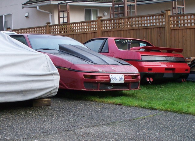

This is the hood treatment it will get.

Mr Zen you actually bring up a good point that I think I should clear up.  I get asked "WHY" do I have a cowl hood on the front of a mid engine car.  Well their are 2 reasons.
1st being performance.  At speeds exceeding 180-200kph, (which happens every few days when I am driving my V8) The front end of a Fiero gets really light.  Due to excessive air pressure under the front radiator compartment.  To the point that the air pressure can actually snap your headlight doors open and in extreme cases snap them off.  So the cowl allows air to escape.
2nd is the sheer style of it.  My 85GT has always been a "rat rod" As anyone that has met me or spent any amount of time with me, I'd rather have a beat up, spray painted car that I can put up against a 40,000 Mustang Cobra in a street race any day of the week.  Spending $150 on sail panels makes me think 3 or 4 times over. "Do I really need it" however dropping $300 on a new ignition system for the car that lets me get a few more HP out of it, or spending 16hrs working on the engine, I don't even think twice.
The other side benefits to the hood vents, especially a cowl like this one, is the windshield now gets a steady blast of heated air over it, which keeps ice and frost off, and even helps to burn off water just that much quicker.   My car runs cooler, faster and performs better at freeway speeds.  To me thats really all that matters.   Now making it look cool in the process and maybe even spending a bit on dress up, it cool with me too.  I just won't ever make the #1 issue on my car the looks.

Unless I'm woefully mistaken, Cowl Hoods also allow more air to flow through the radiator (as it exits after going through, rather than lingering and "clogging" the inside) which in turn cools the engine, also being beneficial for performence. I know that's why large-displacement front-engined drag car do them that way.
Date Posted: 12 December 2008 at 11:31pm
Yep car runs much cooler.  Not that it ran hot in the first place, just runs cooler now.

Right Side
Left Side
Rear
This is my favorite shot.  Man that nose and hood are going to look so cool together after paint.  Then the roar of the side pipe exhaust, its going to be one hell of a complete package.
