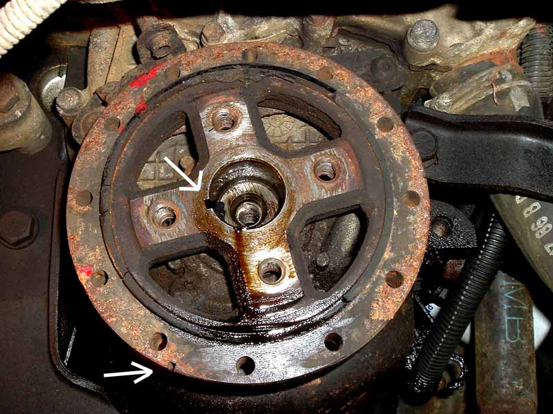

Thought some of you might wish to see what a "spun" balancer looks like. The timing mark is supposed to line up almost beside the keyway. One look at my old balancer and you can see that something is messed up! Thanks to Blair (who I met for the first time this past Monday, great guy Today I installed the balancer as well as a custom made Fiero Belt Tensioner made by Dodgerunner at PFF. Everything went well. I can now time my engine properly and.... no more belt squeal! I’m quite pleased.
