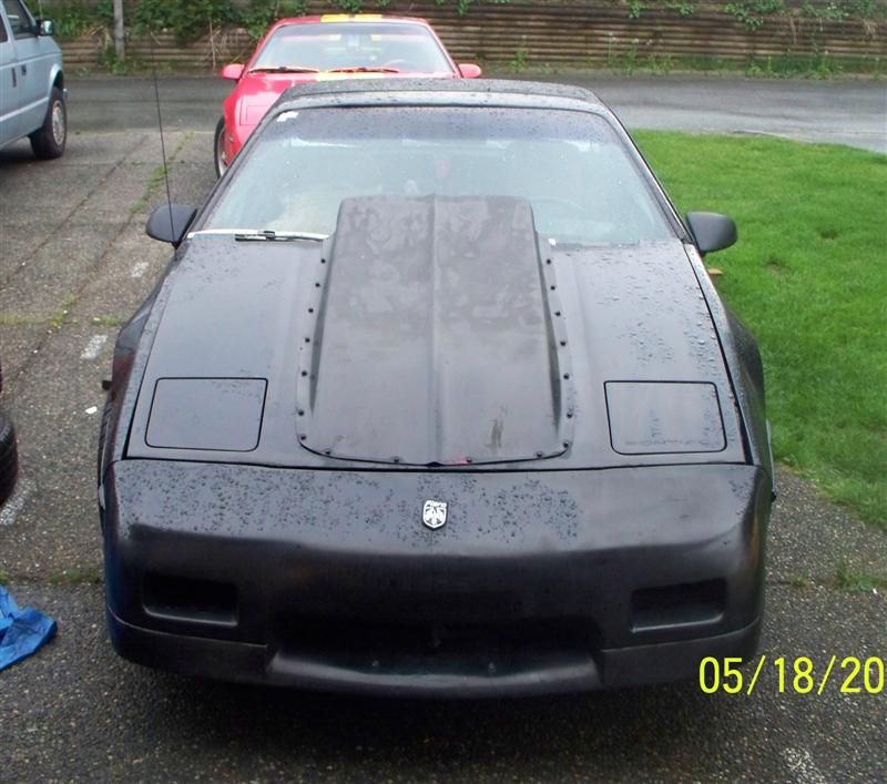

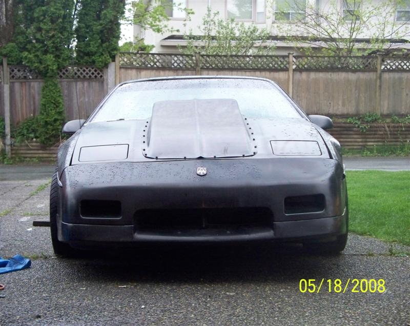

Date Posted: 19 May 2008 at 9:51pm
Ya'll better watch out, what ya gonna do when you see this coming up in your rear veiw window.
   I fired it up and drove it out of the garage under its own power today.  I was a bit worried about the clutch being too grabby, however, I let it idle down to about 550rpms, and gently lifted the clutch up and it engaged as smooth as silk, gently pulling the car backwards.
I am really happy.
Date Posted: 19 May 2008 at 9:59pm
Nice hood:)
Date Posted: 20 May 2008 at 9:47am
The hood is to maintain the "rat rod" look.  It also serves release the hot air from the radiator and relieve pressure from the area under the hood.  It seems to work quite well.
Posted By: kawana
Date Posted: 20 May 2008 at 10:34am
kinda reminds me of like a knights helmet or something :P With the rivets and all :)  Or maybe im crazy, idk.
