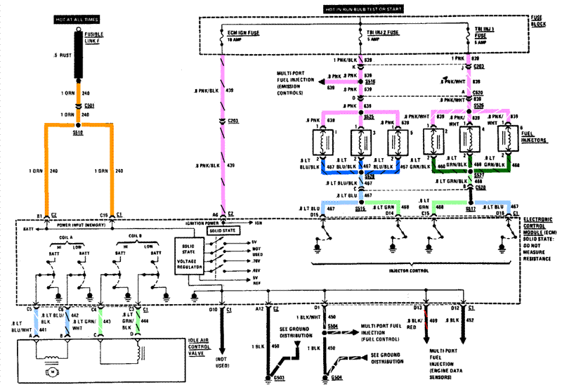

I've seen a bad distributor ground kill cars.  They get corrosion between the base plate where your module goes, to the shaft/housing.  Quicky try - run a ground wire off the battery to one of your distributor cap screws.  Takes 30 seconds and eliminates that off the list.
You're down to fuel (since you replaced the ignition module).
Check for +12V at the pink/wht & the pink wires on the connector going to your injectors (that 2 row semi fat one near the t-stat housing).
If you have power there (with the key on!), then...  and this one is semi risky...  run a wire off the green and blue wires on that same connector.  Every time you ground those, ALL your injectors will fire.  You have a choice - you can pull the intake (again...  I'm sure!) and then lift out the injector rail leaving it hooked up, then with the key on, TAP it to ground for a SPLIT SECOND and see if they all squirt, OR leave it all hooked up in place, and have someone crank the car while you again tap it QUICKLY to ground.  If the car starts and then dies, just keep quickly tapping it to ground in spurts to see if it will keep going.  DON'T hold it on ground for more than a tiny shot at a time or you'll flood the hell out of the engine, maybe hydro lock it, or burn out your injectors!  You've been warned....   ;)
Anyhow, if that checks out, ring out all the wires going from your distributor back to the ECM, then do the same with the injector harness.
You COULD have a foobarred ECM.  I've replaced only about 3 over the years, covering probably 100 cars.  But it does happen.
Date Posted: 03 April 2008 at 6:52pm
If you don't already have it, here's a drawing that might help you see what you're doing with the above info:
